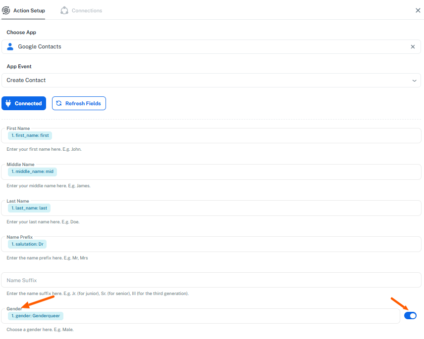

Hello @sampaht,
Could you please try performing the action by selecting a gender from the dropdown under the Gender field and confirm if it works
sampaht — Reply ·
change it to drop down still make it error 400

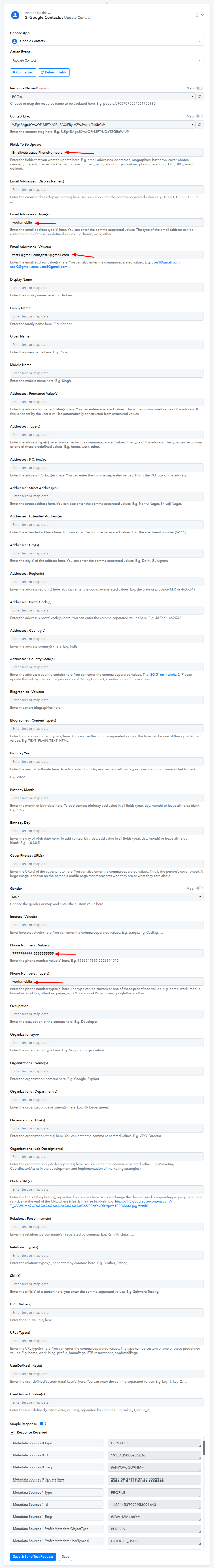

After carefully reviewing your workflow, we found that the error was caused by the date and month input fields. Specifically, Google Contacts does not accept a leading zero in the month field.
We have added two Text Formatter steps to remove the leading zero before sending the data.
[IMG width="403px" height="261.224px" alt="1758786076144.png"]https://forum.pabbly.com/attachments/1758786076144-png.60836/[/IMG]
[IMG width="413px" height="261.792px" alt="1758786386171.png"]https://forum.pabbly.com/attachments/1758786386171-png.60837/[/IMG]
After this adjustment, everything is working perfectly.

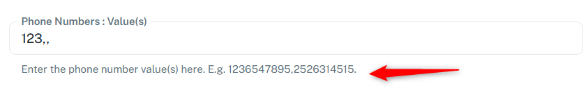

1. There is possibility contact will have more than 1 phone number, and more than 1 email address. How to translate it to update google contact action?
If there are two or more email addresses or phone numbers, you need to pass them in a comma-separated format, as shown in the help text.

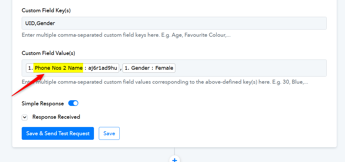

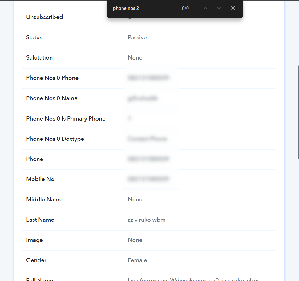

During setup, you mapped the key 'Phone Nos 2 Name' in the Custom Field.
However, during automation, you are not receiving this key, which is why nothing is being mapped to the Google Contacts action step, resulting in the issue.
sampaht — Reply ·
Thank you! This is the reason.

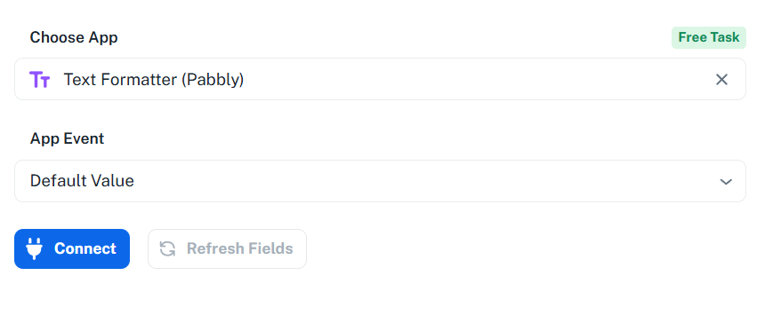

is there any way to prevent empty string to be sent? If I use router, it will be either a very long workflow and possibly run multiple times for routes of each empty string combination, or a lot (based on permutations) of routes of combination for each empty string combination.
I’m afraid there’s no workaround to prevent sending empty strings. However, you can add a ‘Text Formatter: Default Value’ action step for each field that might contain an empty string, and then map its output to the Google Contacts action step. This will ensure that a default value is passed to the Google Contacts action step during automation if an empty string is received in the trigger step.
