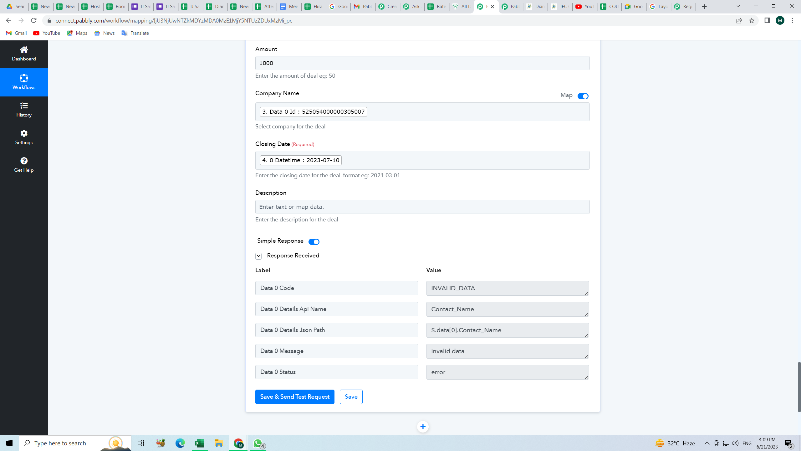

Unfortunately I am facing problem while creating workflow. after doing all steps when I click on Save & send test Request button at the last step it is showing as on attachment. I am unable to solve this issue please do needful.
Please find the attachment

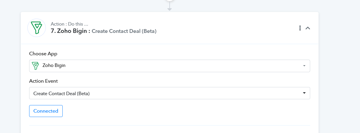

Kindly try the "Zoho Bigin: Create Contact Deal (Beta)" action step once and let us know.
I have already tried this but getting error

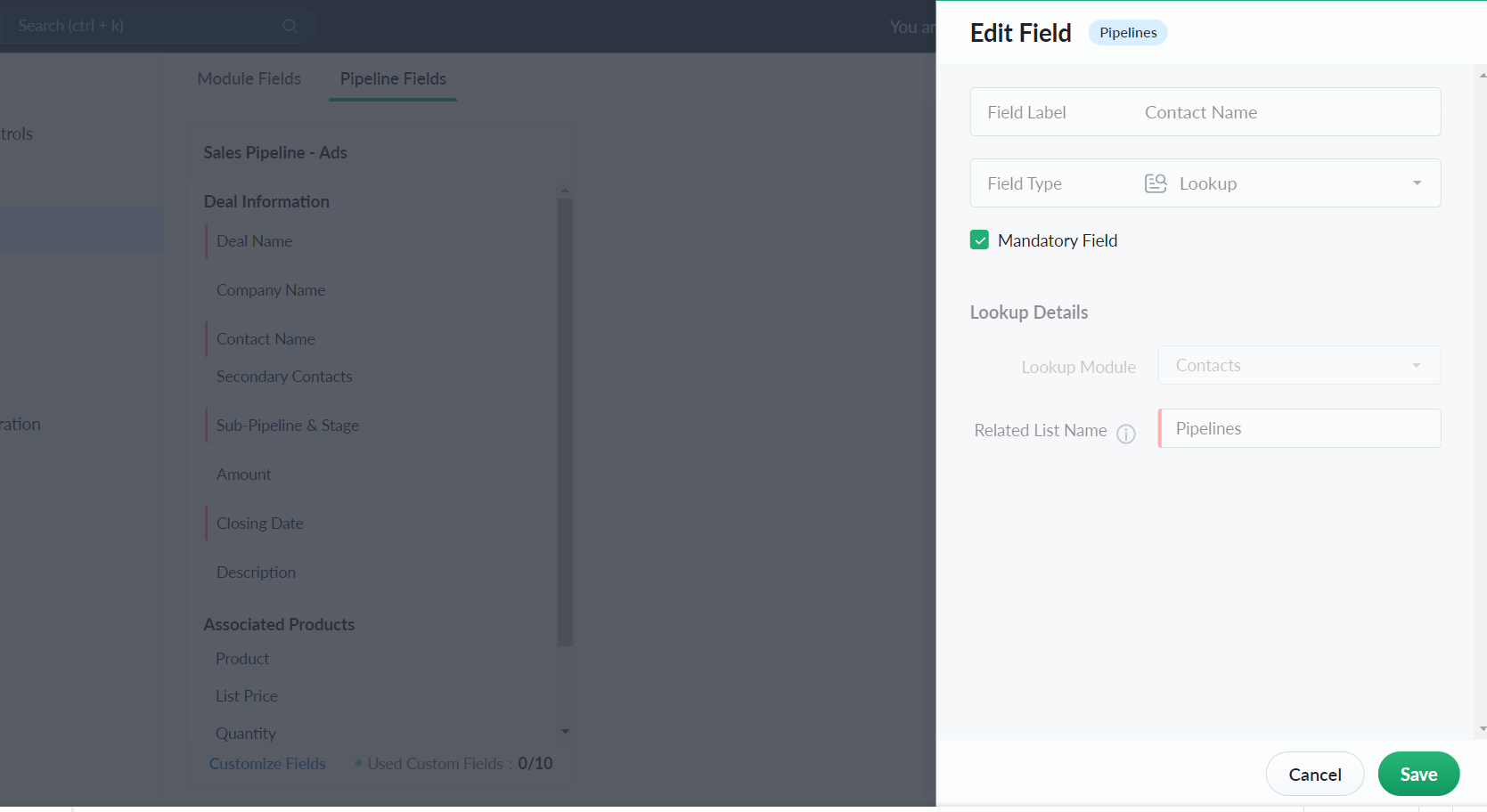

1. You have made the Contact Name field mandatory and because of that running the action step is getting failed.
So, we have unchcked the mandatory type and the action step is working.

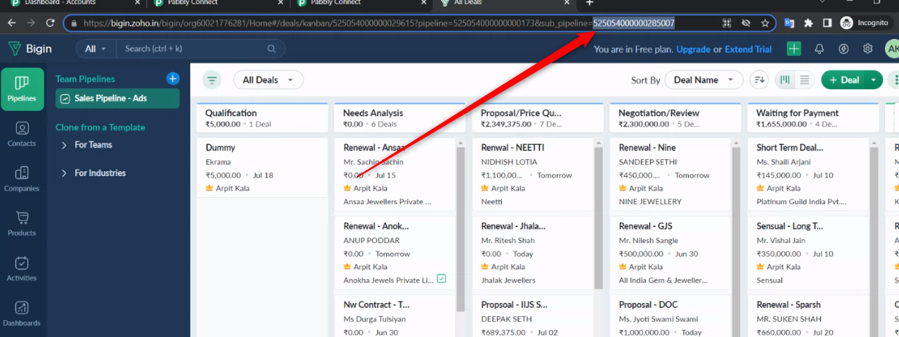

2. If you are having subpipeline in your Deals then you need to pass Subpiple Id from your Zoho account URL.

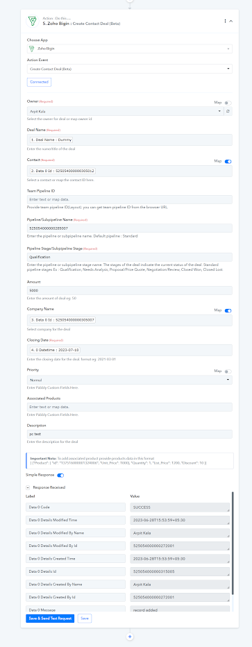

Action step -
