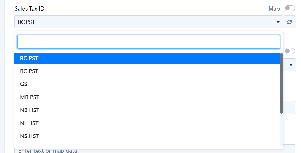

I am running into trouble trying to add sales tax when creating a new wave invoice. The issue is there are no sales taxes available to select in the sales tax field. When i try to refresh the available sales taxes in the drop down it hangs on loading. Alternatively if i try to map the tax manually it also hangs on sending a test transaction and saving. the page loads endlessly forcing me to refresh the page and loose progress.

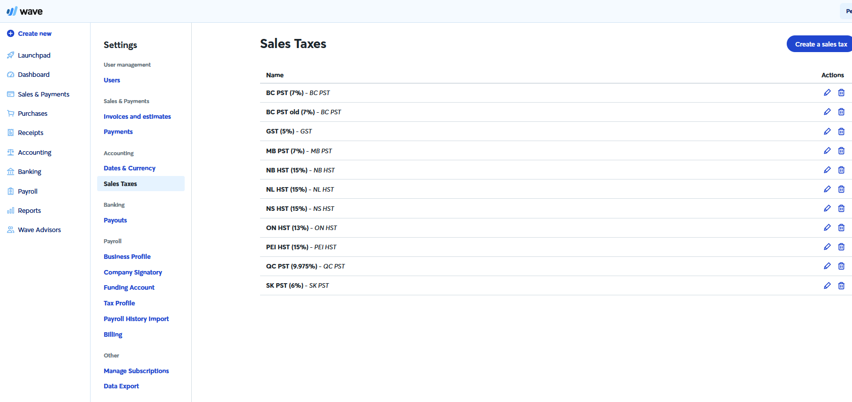

1. I confirm i have sales taxes present in the wave sales tax settings - see below screen shot

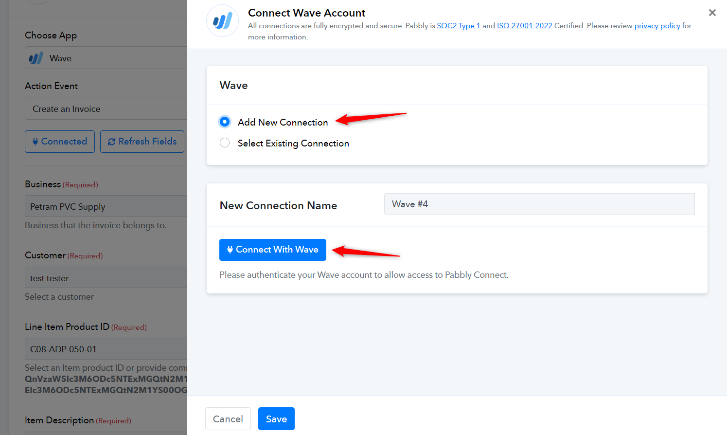

Hi @Petram PVC,
Could you please log in to your Pabbly Connect and Wave accounts in an Incognito tab, and then establish a new connection to see if that provides you with the Sales Tax ID?

I did as suggested but the outcome was the same; hanging on loading.
-in incognito mode in firefox i logged into pabbly connect and wave accounting
-i created a new connection. The connection works fine, i can test submit the create new invoice action without issue as long as i don't try to add a sales tax.
-no sales tax options are available from the drop down, refreshing the drop down leads to hanging. Manually mapping the wave sales tax ID also causes hanging.

@Petram PVC, We have made some changes at the backend. 'Sales Tax IDs' are being listed now.
