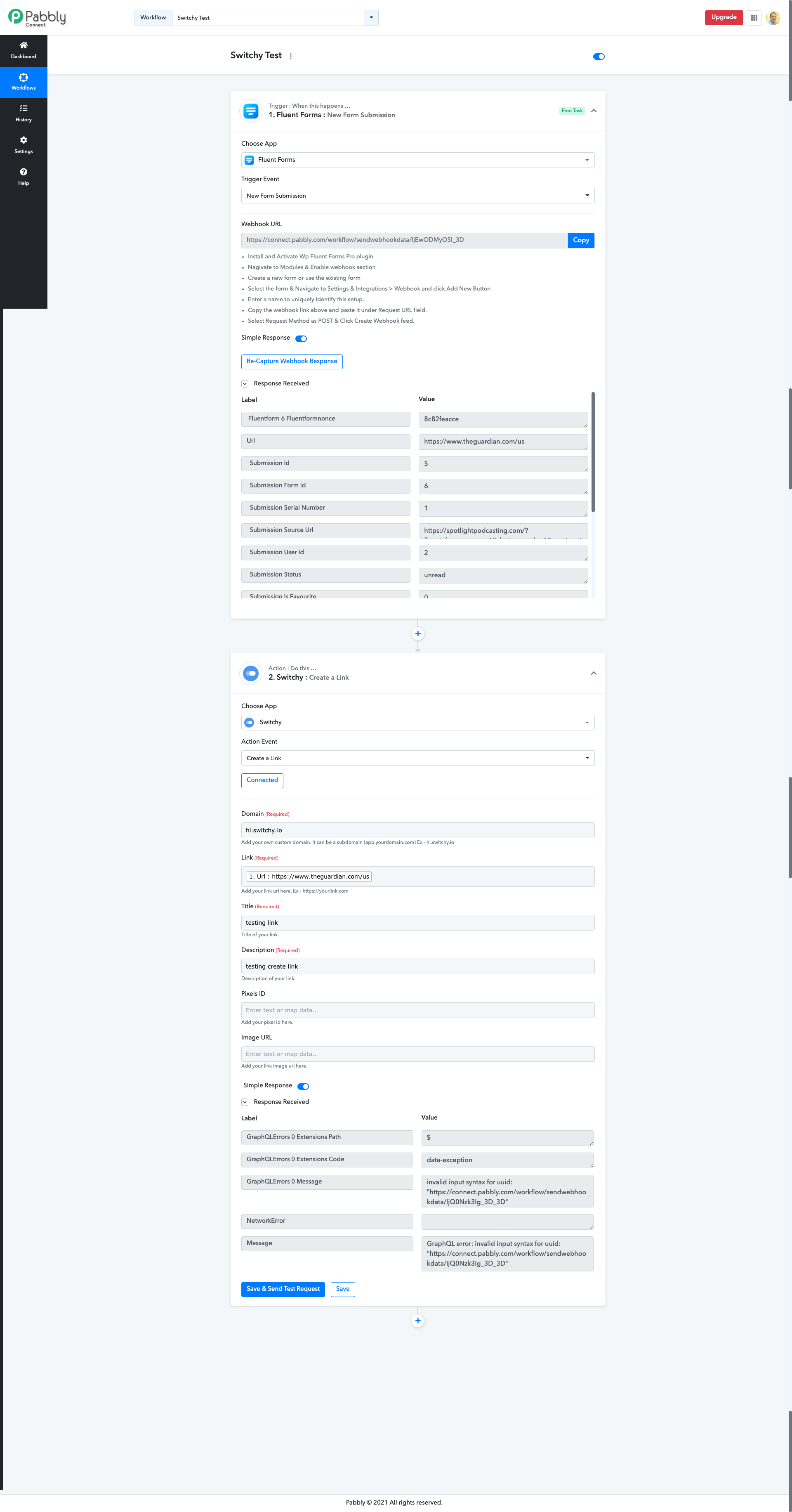

Can't you just replicate it yourselves? It's basically any recipe that has creating a Switchy short link as an action
I removed the workflow because it wasn't working
I suppose I'll have to create it again then

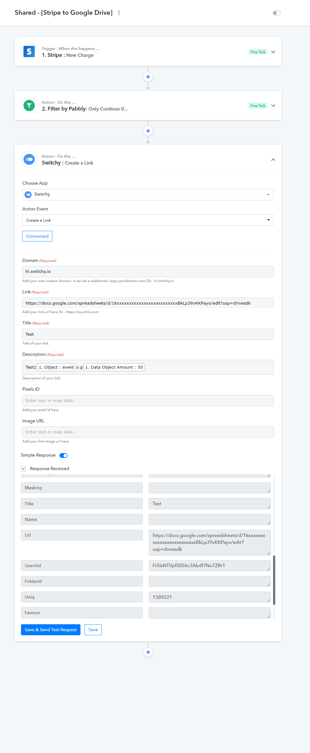

Hey @jonbstrong

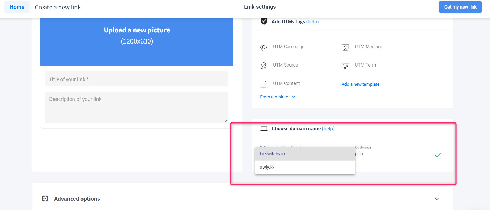

We have tested the Switchy's "Create a Link" endpoint at our end and it is working fine. We would recommend you to check the domain before passing it.
Please check out the following screenshot's workflow - https://connect.pabbly.com/workflow/share/CEBRY1MUUnUFTwVvURoMK11KUGkFTwlfVzAHFQ##

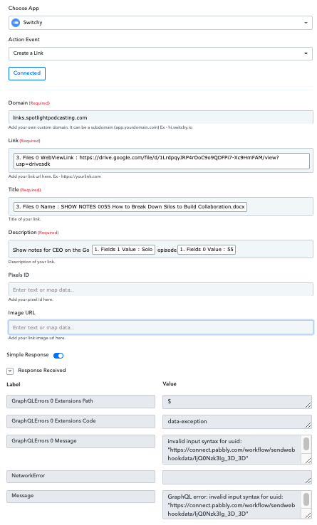

I tried using hi.switchy.io
Still getting the same error
Here's a link to the workflow:
https://connect.pabbly.com/workflow/mapping/IjEwODMyOSI_3D
Hey @jonbstrong
It looks like you may have entered the invalid credentials while connecting your Switchy account with the respective action. Please check this short video for a better understanding - https://clipchamp.com/watch/ls0tIxye44A

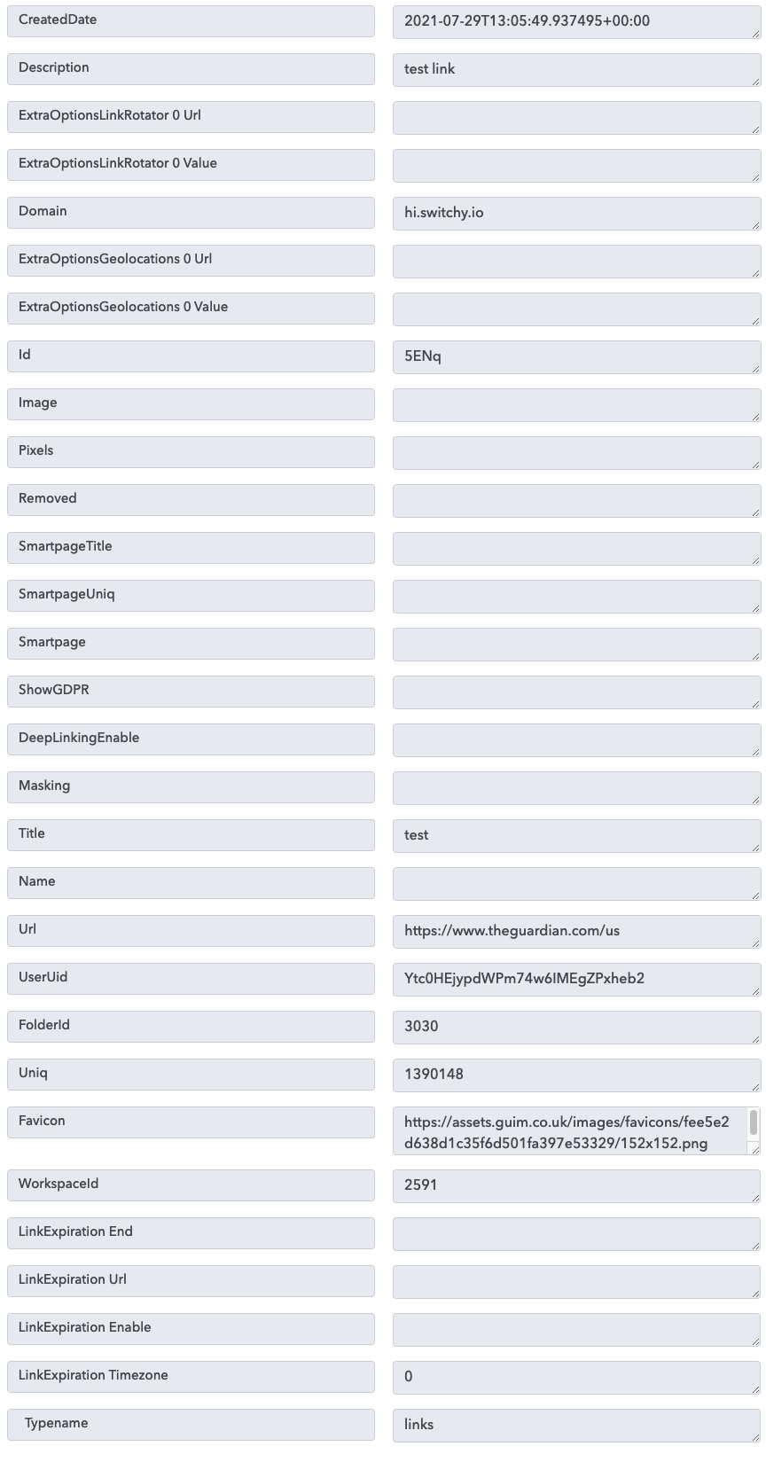

OK, next issue is that the shortlink Switchy creates is not returned by Pabbly..
It seems as though it does provide the components of the short link (i.e. the domain and the ID fields), but not the full short link itself...
It is returned as ID in repsonse, so if you wantit to use in next step just add domain name as static text like swiy.io/map_id_here
