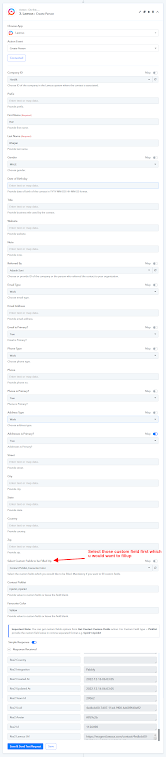

We got an update from the technical team that they have deprecated the older version of "Lawcus - Create Person" action step and created a new one. Kindly delete the older action step and use the new one in your workflow.
We have create two endpoints:-
1. Get Contact Custom Fields
2. Create Person
Also, kindly read the helptext carefully before entering the custom fields.
Please let me know if you have any questions or comments.
