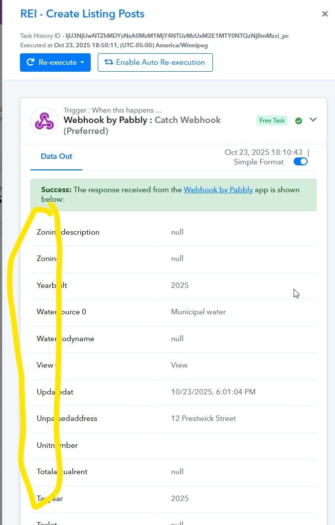

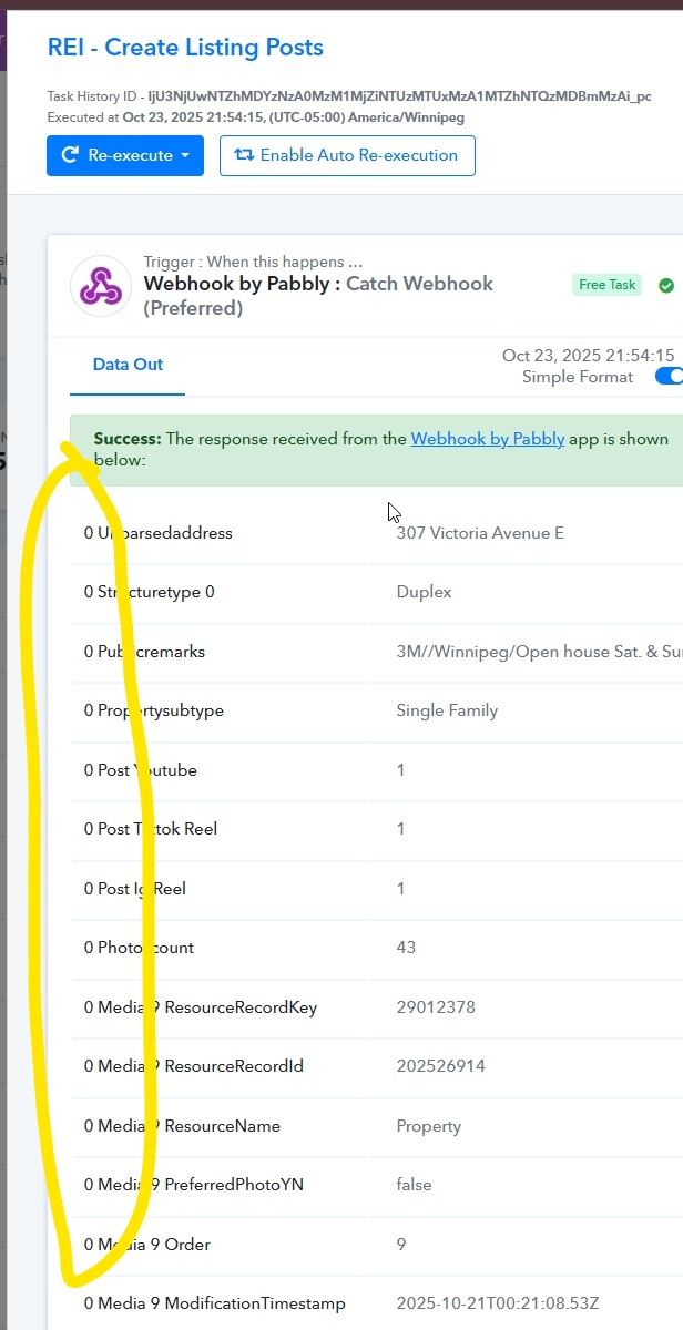

I need help with forwarded data. I have a workflow that receives data that looks like the image I attached with no leading zeros but when I try to apply some logic within Pabbly Connect and then use the Data Forwarder, no matter what I try to do, the data is all being bundled within an array so when it goes to the same webhook for the workflow that receives the data, the leading zero break everything since it's beaving like it's a layer deeper in an array. How do I stop this from happening so I can send the data in the format that's expected by the workflow webhook but also without the data separating into separate fields? I can have the data separate and then grab each field for the dataset, I just want to forward the data. It's the same data so why can't I forward it in the same way it was received?
