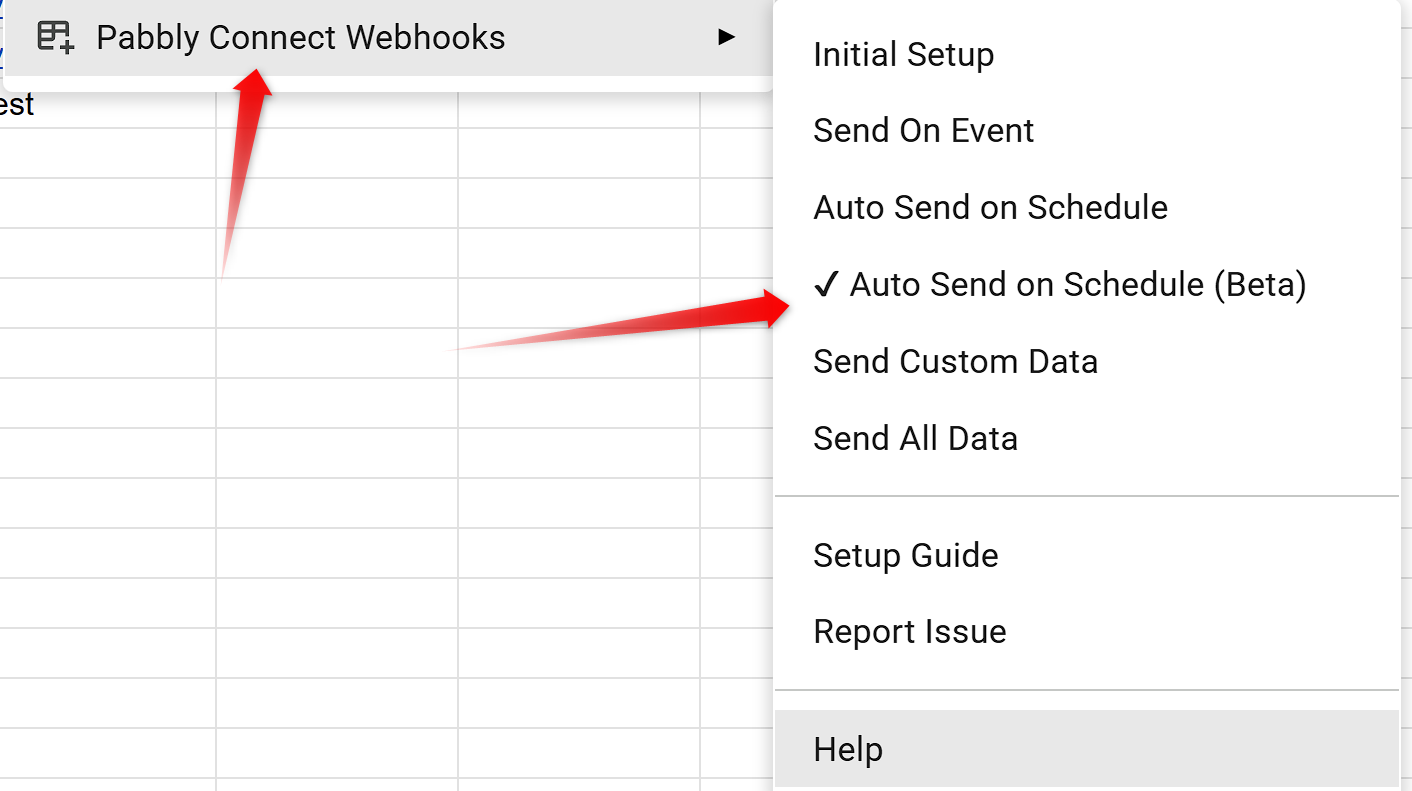

Can you let us know how the data is being added in the Google Sheet? Using some kind of automation process or manually. Also, share the screenshot of the Pabbly Connect Plugin settings showing which event you have selected.

Sarika Saxena Rajput β€” Reply Β·
Leads are directly coming from Justdial through the Webhook URL.

Hello Sarika,
Based on the information can confirm that I understand it correctly. You are getting Leads from Justdial to Google Sheet via Webhook, and then you created a workflow in Pabbly Connect, choosing the same Google Sheet as a trigger to add the same data to your CRM? Please confirm and provide a screenshot of the Pabbly Connect Plugin settings that you installed in the Google Sheet.

Pabbly Support β€” Reply Β·
Hello Sarika,
Thank you for your confirmation. As the data is getting added automatically in the Google Sheet, in the Pabbly Connect Plugin settings may we know which event you have selected?
1) If you are manually making the change in the Spreadsheet, the updated data will be sent immediately to Pabbly Connect. Ensure enabling the Send on Event option in the addon.
2) If the change is made through an external platform besides Google Forms in the Spreadsheet, the trigger will be sent once every hour. Ensure you enable the Auto Send on Schedule (Beta) option in the addon.
In your case, you need to select the Auto Send on Schedule (Beta) option.
Our Lead sheet is getting leads from external platform as well as, in case if we need to add any lead from our side. We can add it manually as well in the sheet. Do we have to follow the above steps for both the cases to work?
Also confirm, if we set it as
Hello Sarika,
Thank you for the follow-up. Here is how the two scenarios behave:
1. Leads added by an external platform (e.g., Justdial webhook): With Auto Send on Schedule (Beta) enabled, the extension works on a polling schedule and checks for newly added or updated rows approximately once every hour. So for externally added leads, there can be a delay of up to one hour before the data is picked up and sent to your workflow. This is expected behaviour for polling-based sending and the interval cannot be reduced below the configured time.
2. Leads you add manually in the sheet: For manual edits, you can enable the Send on Event option, which sends the updated row to Pabbly Connect immediately, so those will not be delayed.
Regarding your question: yes, with Auto Send on Schedule (Beta), leads coming from the external platform will not be real-time and can be delayed by up to an hour. To confirm data is flowing correctly, add a test row and check your Task History at https://connect.pabbly.com/history to review the execution details. If nothing appears after an hour, please let us know so we can investigate further.
