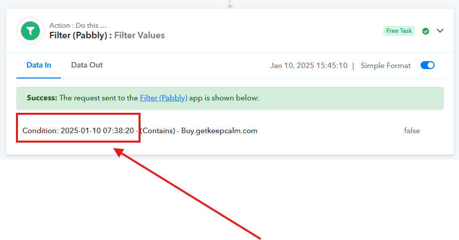

hello, can you please check why the condition on "Data In" on my filter is show success but showing error? If you check my filter I added the correct tag and upon testing it shows success. This is the Task History ID - IjU3NjUwNTZmMDYzNzA0M2M1MjY4NTUzNDUxMzA1MTY2NTQzOTBmMzEi_pc

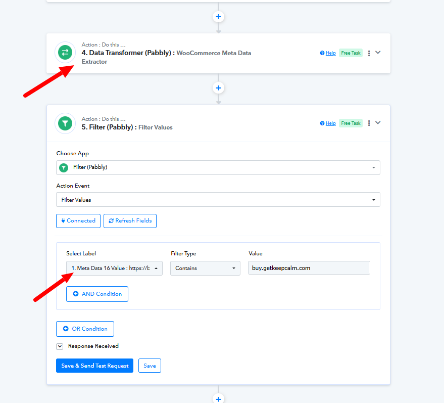

The question is why the workflow capture the wrong condition while if you check the tag I added on the " Filter" step is correct. Like for example the screenshot I added, what capture on the condition is the date, why is that happen?
Hello @Clicknamics,
The WooCommerce trigger response is being received with shuffled fields. Since you're already using the WooCommerce Metadata Extractor action, I noticed that in the filter step, you're mapping the response from step 1 instead of step 4. Please double-check that you've mapped the correct response from the right step. If it's incorrect, make the necessary corrections, then run a few test requests to see if it works as expected.
If you're still facing issues, let us know the response key where you're getting the required string, and we can assist in mapping it for you.

You are not getting 'buy.getkeepcalm.com' anywhere in your WooCommerce trigger step, which is why it's not getting extracted in step 4 and the Filter condition is not being met.
