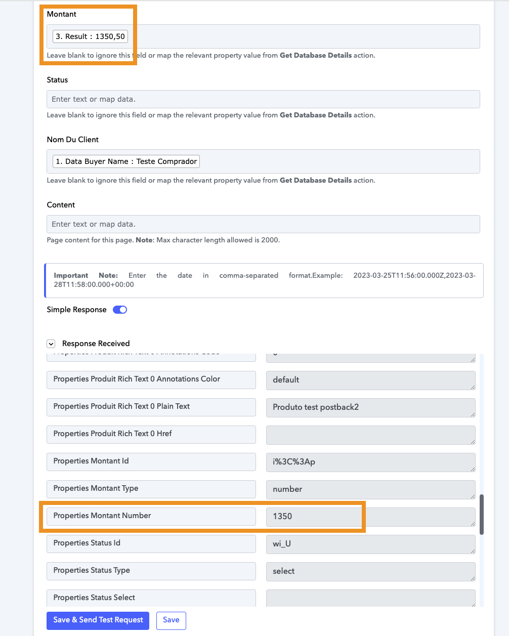

I noticed the decimals are not sent to Notion when using the app on Pabbly connect.
I also tried to format the number but it didn't work - see screenshot below:
Any suggestion to resolve this issue? What I want is to send the decimals (1350.55 instead of 1350) to Notion for more accuracy.
Please let me know if you need any further information.

@Michael-SAV, We have made some changes at the backend. The issue appears to have been fixed now. Please check the same at your end.
