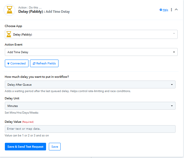

Am I not understanding out iterators and delay works together? I want it to delay for 1 min before starting the next iterator set, but it looks like it is delaying them both at the same time.

I tried the same with this workflow, and it did the same thing. It didn't delay each set of the iterator, it basically waited one minute and then did all the steps.

Hi @tboy123,
This behavior is expected when using Delay For with Iterators. The Delay For step pauses all iterator items together, waits for 1 minute, and then continues them at the same time.
To add a 1-minute delay between each iterator set, please use Delay After Queue instead.
This ensures each iterator item runs sequentially with the required delay.
Let us know if you need any help updating the workflow.
Hrishabh
Rate your support
tboy123 — Reply ·
Works as I need. Thank you!!!
