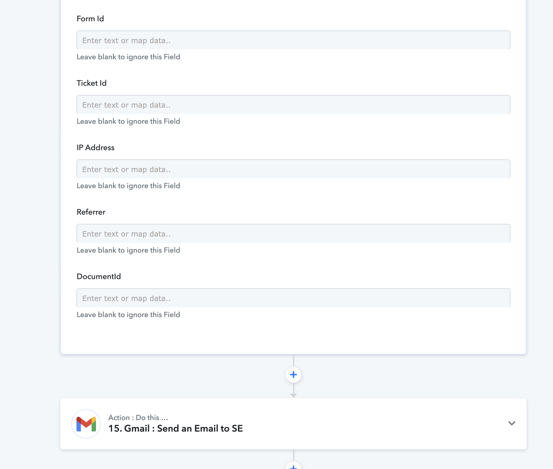

Hers is a screenshot showing the tail end of the "Create from template" flow. As you can see, there is no "save" option.

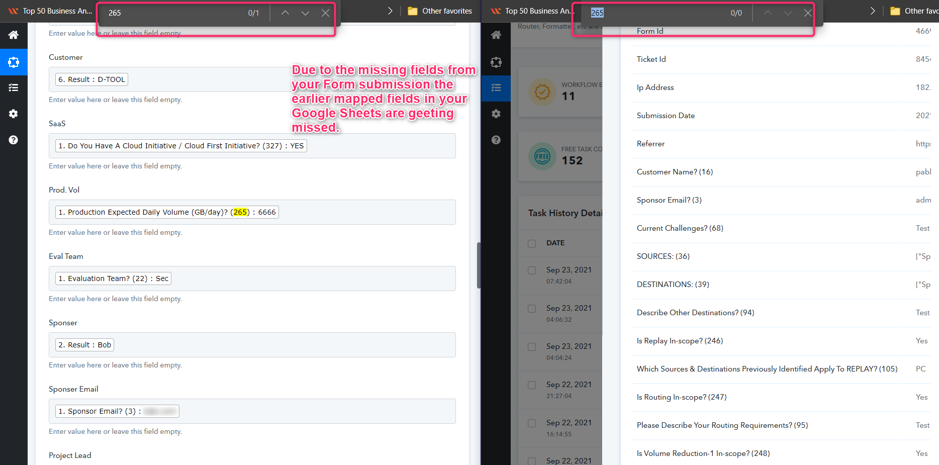

Hey @mhassan
We looked into your workflow and found that due to some missing fields from your form submission the Google Sheets mapped values are getting empty. For better understanding kindly check your workflow's history section and the following screenshot.
Thanks!!
