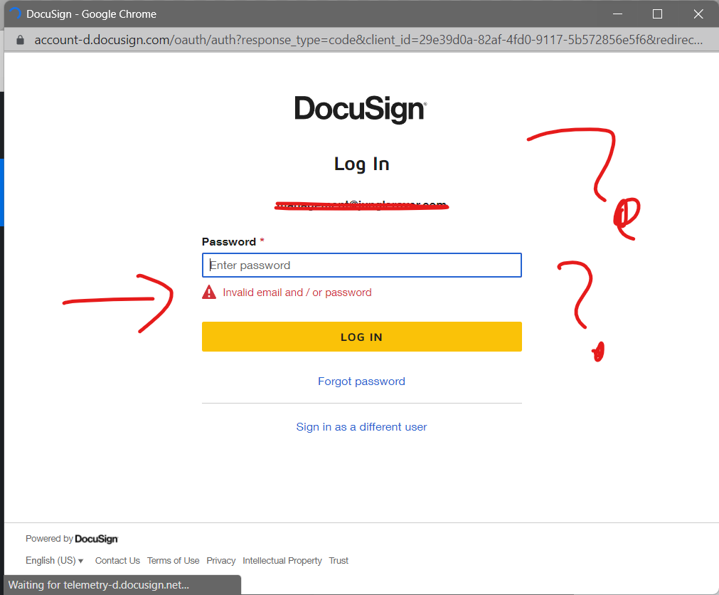

I have been trying to make a connection between my apps and DocuSign through Pabbly Connect, however, it seems that Pabbly is unable to connect to DocuSign. This problem is a dealbreaker for me, since I am trying to migrate from Zapier to this platform. Are you going to fix this?!
Important: I have checked my credentials and everything is correct. Apparently other users are having the same issues since months ago. You should have fixed this already.

I am having the same error. I have been able to successfully connect other api apps to docusign recently and am currently running a zapier connection that is active and working.

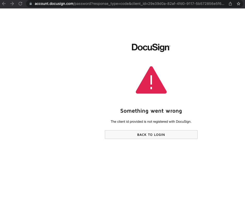

I found the error.
"https://account-d.docusign.com/oauth/auth?response_type=code" This is what Pabbly uses to authenticate with Docusign. Every time I try to use this it to log in to Docusign it gives me the "Wrong pass word error".
"https://account.docusign.com/oauth/auth?response_type=code" This one right here is what Zappier uses to authenticate with Docusign. When I use this to sign in to Docusign everything works normally.
"https://account-d.docusign.com/oauth/auth?response_type=code&client_id=29e39d0a-82af-4fd0-9117-5b572856e5f6&redirect_uri=https://connect.pabbly.com/callback-url&scope=&state=eyJzb3VyY2UiOiJhcHBzIiwiaWQiOjE4OCwiYnRuX2lkIjoib19hdXRoX2J0bl8xNjQ3MDMyNjczMTg4OTM0ODE3NTcxMjc5MzkxMSIsImFwcF9pZCI6MTg4fQ&access_type=offline&mode=post_message&prompt=consent"
- This is the full link Pabbly uses to authenticate.(DOES NOT WORK)
When I tried combining "https://account-d.docusign.com/oauth/auth?response_type=code"(USED by Zappier) and
"&client_id=29e39d0a-82af-4fd0-9117-5b572856e5f6&redirect_uri=https://connect.pabbly.com/callback-url&scope=&state=eyJzb3VyY2UiOiJhcHBzIiwiaWQiOjE4OCwiYnRuX2lkIjoib19hdXRoX2J0bl8xNjQ3MDMyNjczMTg4OTM0ODE3NTcxMjc5MzkxMSIsImFwcF9pZCI6MTg4fQ&access_type=offline&mode=post_message&prompt=consent"
(The rest of Pabbly's authentication link) I got this error message:
So my conclusion is that Pabbly is not registered with docusign.

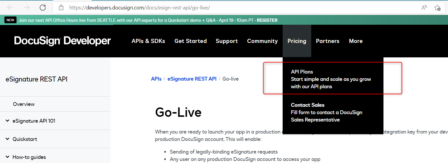

Could you please record a short video on how you are connecting your DocuSign account with the action event? Also please confirm that you are having the API Plan in your account.
Further, Docusign's API is in the testing phase and added to the platform as in Beta. We are also in contact with their support team so that we can live the application soon.
