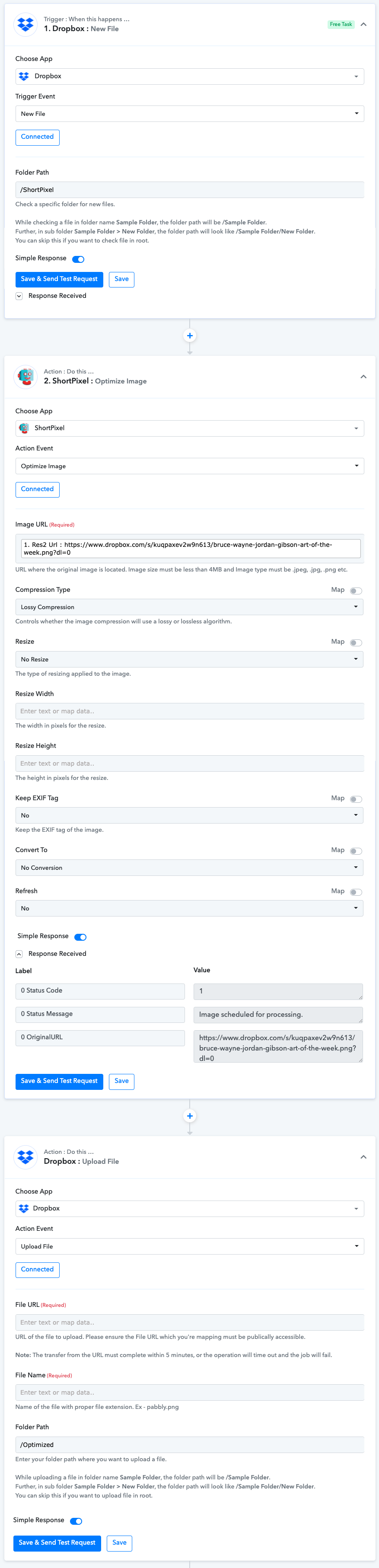

I am trying to setup the following workflow:
1. When a New File is added to a Dropbox folder (/ShortPixel)
2. The New File is optimized by ShortPixel
3. Optimized File is added to a different Dropbox folder (/Optimized)
I am having trouble figuring out how to pass the optimized image from ShortPixel to the Dropbox Upload File action:

ShortPixel action result doesn’t have a URL to use for uploading file to Dropbox. Please check the screenshot in the 1st post.

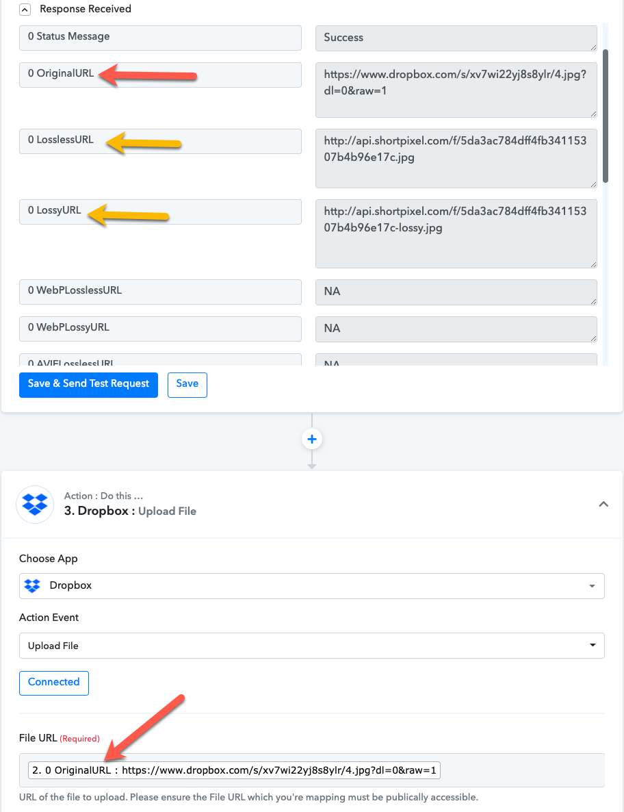

@Supreme Thanks for your response but you are not understanding the problem.
As @Hermes said, the problem is that the image is scheduled for processing for my case (see the screenshot in my 1st post) and the result does not have a URL that I can pass to the Dropbox Upload File action.

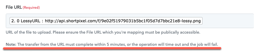

Your suggestion (below screenshot from the workflow you shared) is to pass the original Dropbox URL back in to the Dropbox Upload File action. This will not give me the optimized image from ShortPixel. I need to select one of the shortpixel.com URLs (Yellow arrows) to get the optimized image. But thank you for sharing the workflow with me. From it, I figured out that if I map the "Res3 Shareable Link" from the Dropbox trigger to the ShortPixel action, the image is optimized by ShortPixel instead of getting the result "Image scheduled for processing" that can't be passed to the next step.
@Hermes Thank you for the screen recording. It was also helpful for me to figure out the solution. A delay should not be needed because the next action will wait for up to 5 min according to what is stated in the Dropbox action field:
