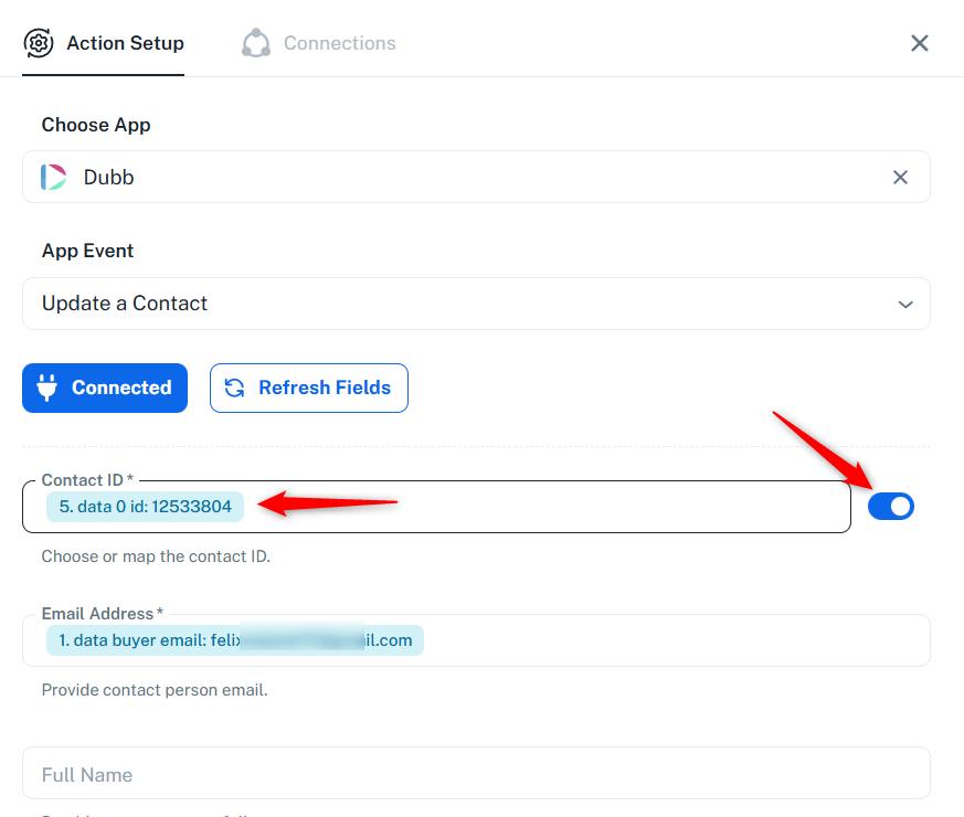

Hi @Iseluleko Ma'at El 0,
You would need to use the Get Contact by Email action step to fetch the contact ID.
Then pass that contact ID to the Update a Contact action step. This will allow you to update the details of an existing contact.
For some reason, you are encountering a Bad Request error in the Dubb: Update a Contact action step. Please allow our technical team some time to look into this issue. We will get back to you with an update soon.
Our technical team has made some changes to the Dubb: Update a Contact action step, which should resolve the Bad Request error. Please check this on your end.
