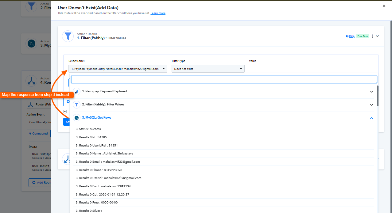

Inside the Router, we have created two routes.
Now the workflow is getting completed in the first route itself, and the second route is not executing as expected.
Earlier, when the response was in row format, both routes were working properly based on conditions.
It seems that due to the structural change (row → array), the router conditions are not evaluating correctly.

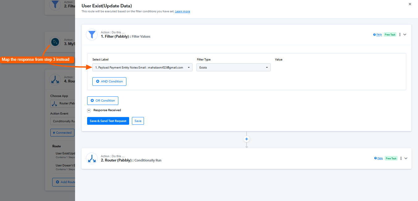

vivekpathak2025 — Reply ·
We have switched from Advanced to Simple. After making this change, an issue started occurring.
We have implemented a filter to check whether a user exists or does not exist. However, now all flows are going to the "User Exist" path. Previously, everything was working fine.
Could you please review our flow once and let us know what exactly changed or what might be causing this issue?
Hey @vivekpathak2025,
Thanks for reaching back to us.
Upon checking the router filter, it appears that you have mapped the response from the first step of the workflow. Instead, the value should be mapped from Step 3 (MySQL – Get Rows), as this is the step that returns the user data used to determine whether the user exists or not.
Because the filter is currently referencing the incorrect step, the condition is always evaluating in a way that sends the execution to the User Exist route.
Please update the mapping in the router filter to use the response from Step 3 (MySQL – Get Rows), as shown in the screenshots. Once updated, the router conditions should work correctly.
