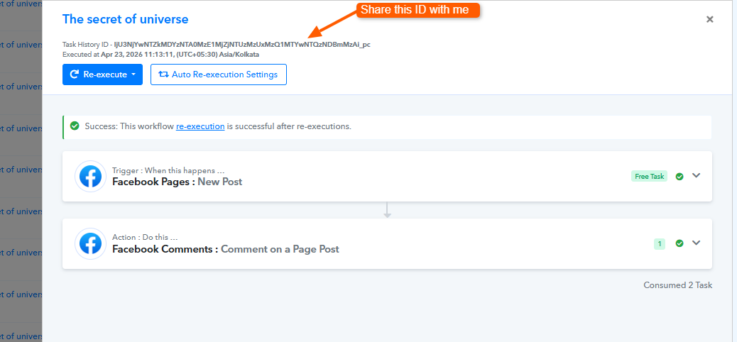

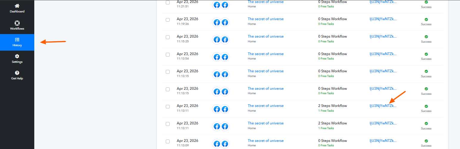

To help us investigate this further, please share the Task History IDs for the instances where duplicate comments were posted. You can find them by following these steps:
  1. Go to Task History in your workflow
  2. Look for the execution based on the reel upload time
  3. Click on the specific task entry
  4. Copy the Task History ID shown at the top
Once you share those IDs, we’ll review the exact executions and assist you further.

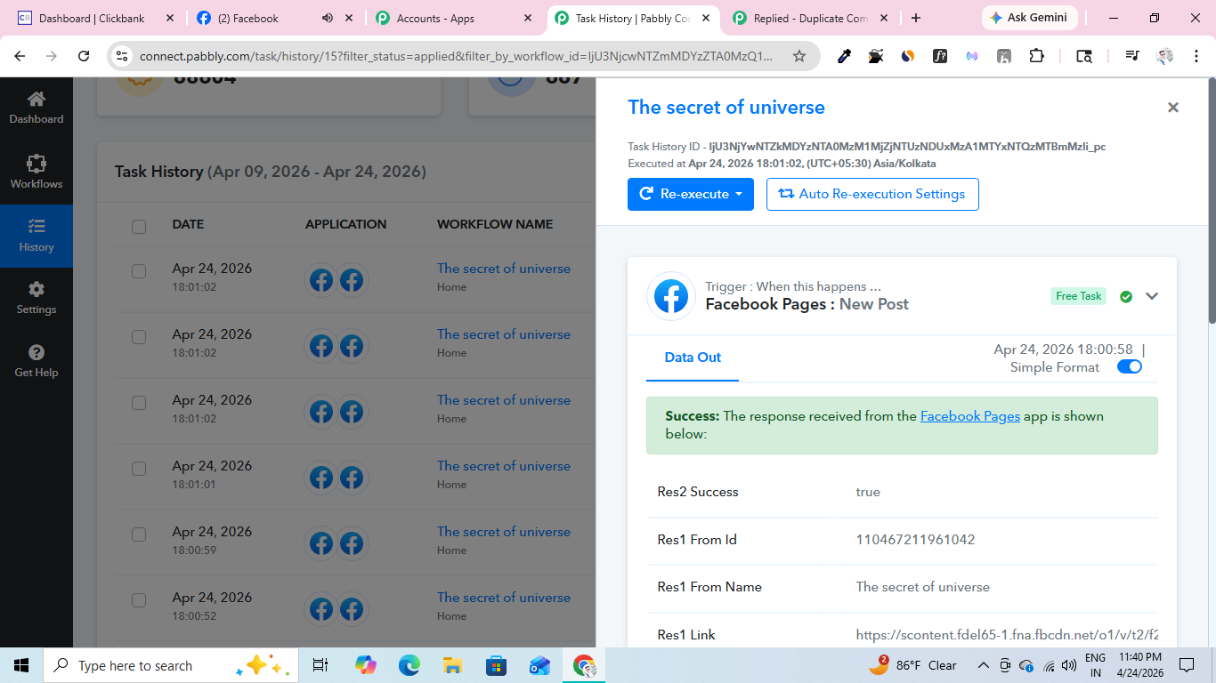

Arun Gayswal — Reply ·
There is double comment on this reel .
Task History ID -
IjU3NjYwNTZkMDYzNTA0MzM1MjZjNTUzNDUxMzA1MTYxNTQzMTBmMzIi_pc

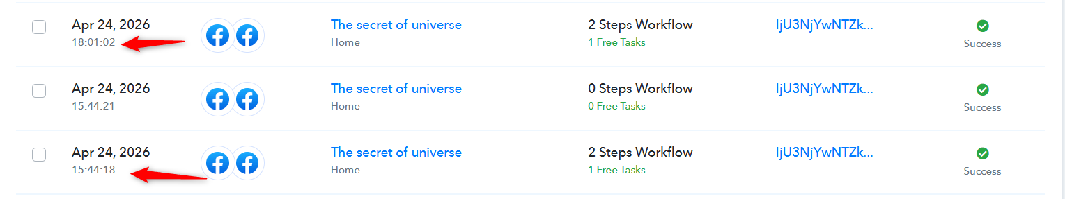

Thank you for sharing the Task History ID. We were able to find two tasks with the same post ID. Could you please confirm the exact time at which the post was made? Was it on Apr 24, 2026, at 15:44:18 or at 18:01:02? This will help us investigate the issue further.
Task History ID - IjU3NjYwNTZkMDYzNTA0MzM1MjZjNTUzNDUxMzA1MTYxNTQzMTBmMzIi_pc
Task History ID - IjU3NjYwNTZkMDYzNTA0MzI1MjY0NTUzMTUxMzM1MTY0NTQzNTBmMzki_pc

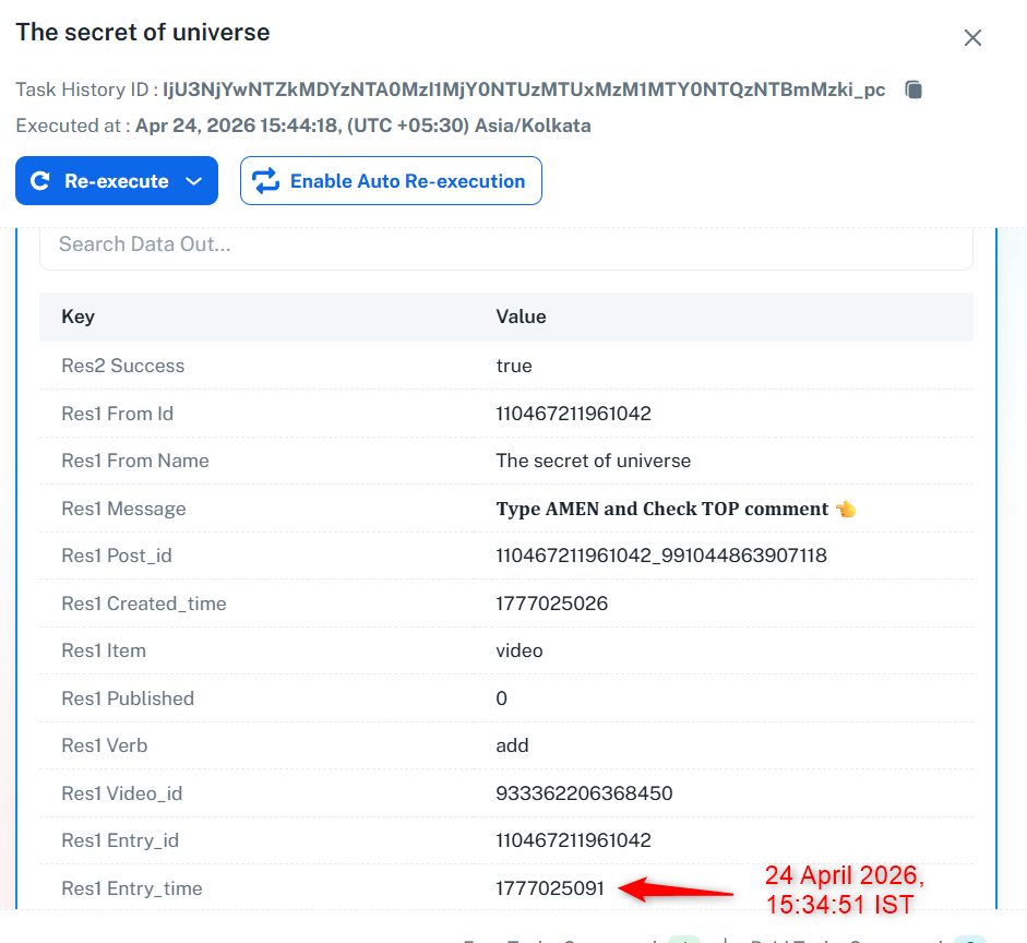

Thank you for the confirmation. This aligns with the task history ID you shared, but the duplicate post that triggered the workflow was posted before this time.
This post was made on 24 April 2026, 15:34:51 IST
Task History ID : IjU3NjYwNTZkMDYzNTA0MzI1MjY0NTUzMTUxMzM1MTY0NTQzNTBmMzki_pc
Could you please check on your page whether a post was made at that time?

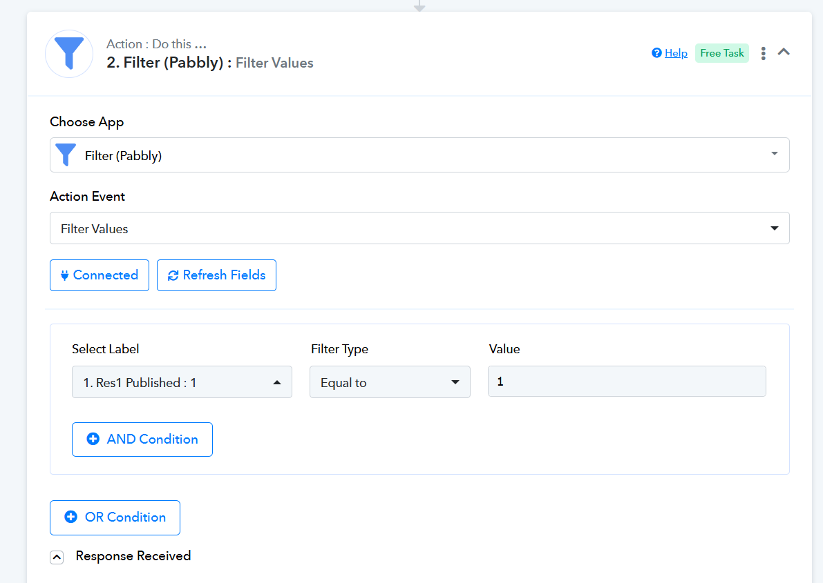

Please note that both posts for which we shared the task history contain the same message. As you mentioned, the post was made on 24 April 2026 at 15:34 and again at 18:00, so the same post will trigger your workflow twice and the post will receive two comments.
Arshil Ahmad
So what to do now .?
Thanks this is working .
