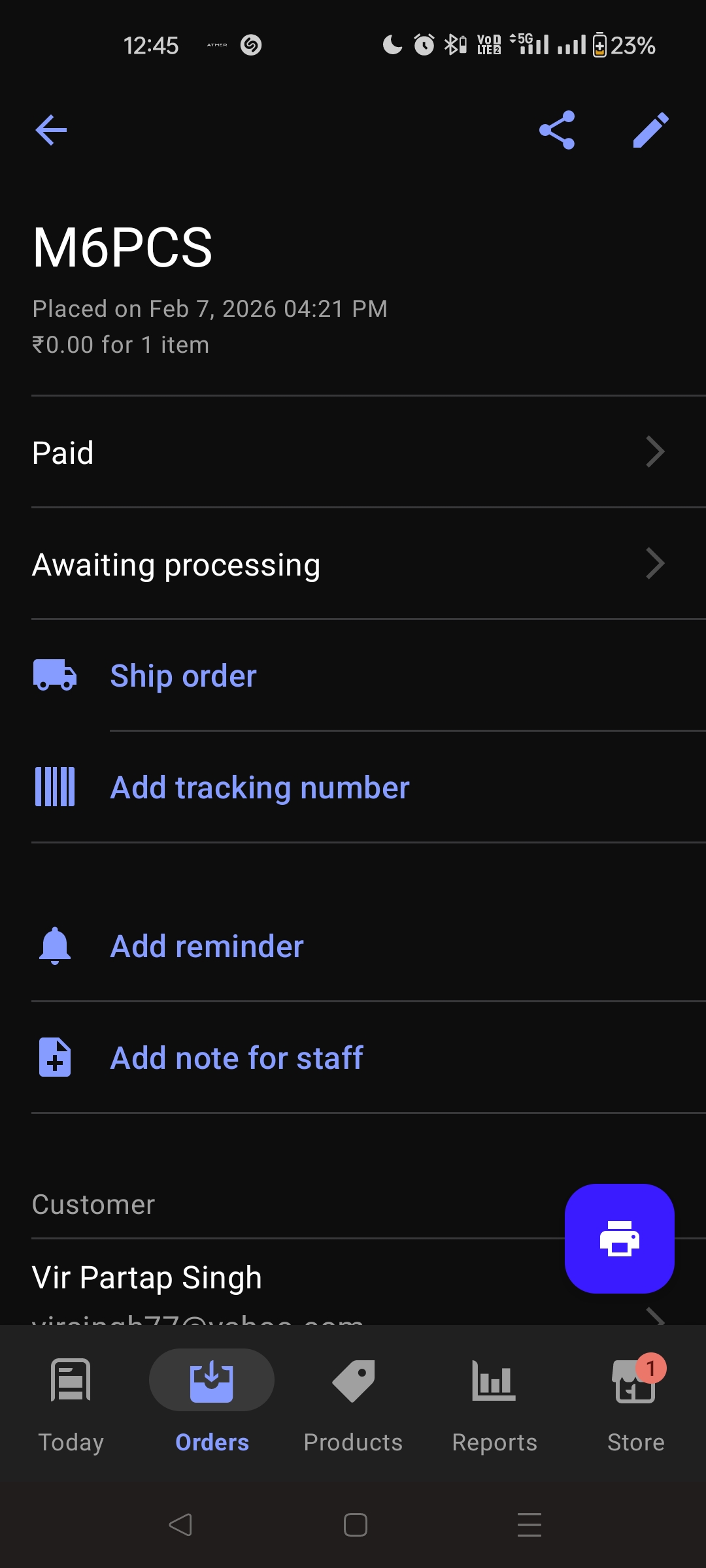

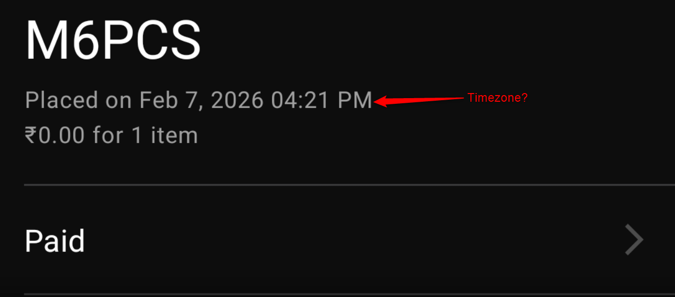

So why did the 2 test orders not trigger? I have attached the ecwid screenshots of the 2 test orders that were created in ecwid and are not visible in pabbly
Could you please share the email address used in these two orders? Also, please specify the timezone of the time shown in your screenshot.

the email id is [email hidden] and the timezone is IST (UTC + 5:30)

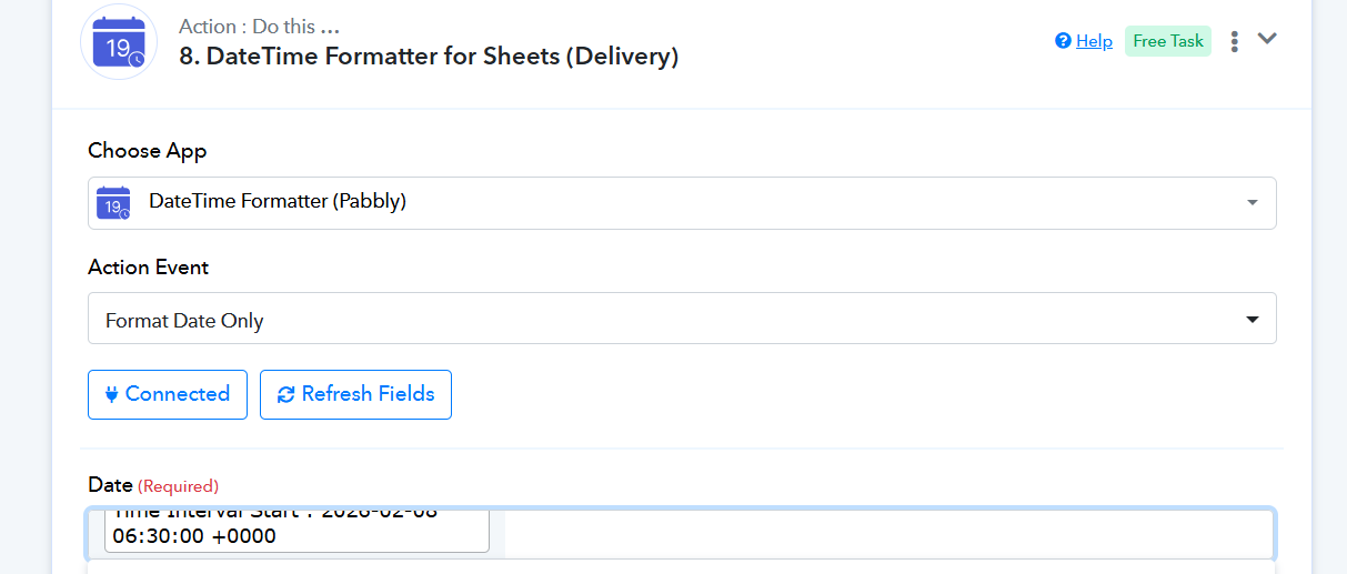

Also i saw the option to change the Pabbly view from Classic to I think New and the its now very hard to see and modify the workflows as the boxes have become very narrow (see attached screenshot) How do I rectify this?

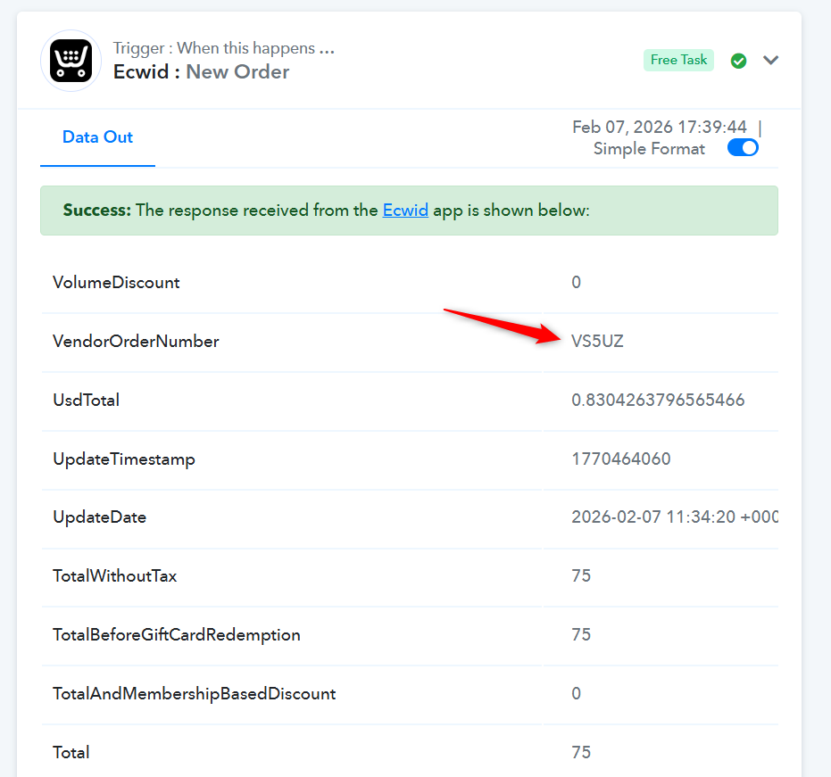

Thank you for the confirmation. Based on your Task History, we can see that your workflow did execute for an order with an amount of ₹75. It appears that Ecwid treats ₹0 orders differently, which is why that order did not trigger the workflow. We recommend creating a test order of at least ₹1 to check whether the workflow triggers as expected.
The data appears to be correct on our end. Please try performing a hard refresh of your browser and see if that resolves the issue.
