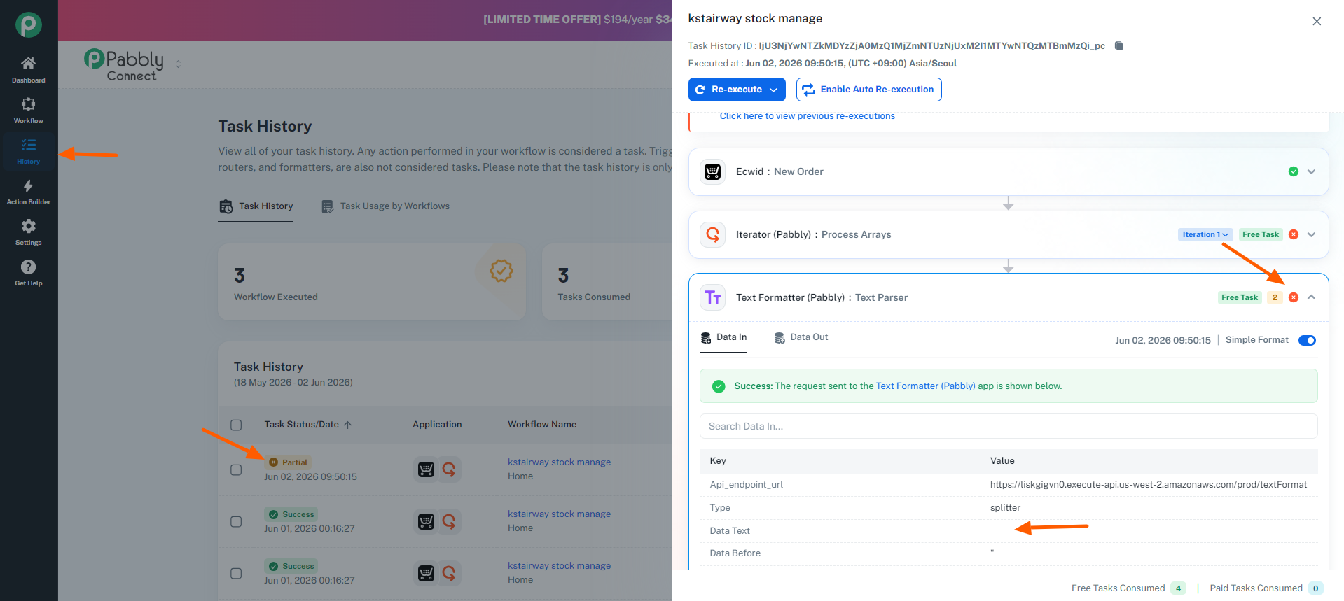

Hey @danny524,
Thank you for updating your profile.
We checked your workflow and it appears that the Ecwid trigger is working correctly. We can see recent task history entries being created, which confirms that live orders are reaching the workflow.
Regarding the latest failed task history, the issue is occurring in the Text Formatter (Parser) step. The key/value that is mapped in the Text Formatter was not received in the trigger data for that particular order, causing the step to fail.
You can review the affected task history here:
https://connect.pabbly.com/v2/app/history/task-history workflowId=IjU3NjcwNTZlMDYzZTA0M2M1MjZlNTUzMTUxM2Ii_pc
We recommend checking the data received from Ecwid for the failed order and verifying whether the expected field/key is present. If the field may not always be available, you can add conditional handling in the workflow to prevent such failures.

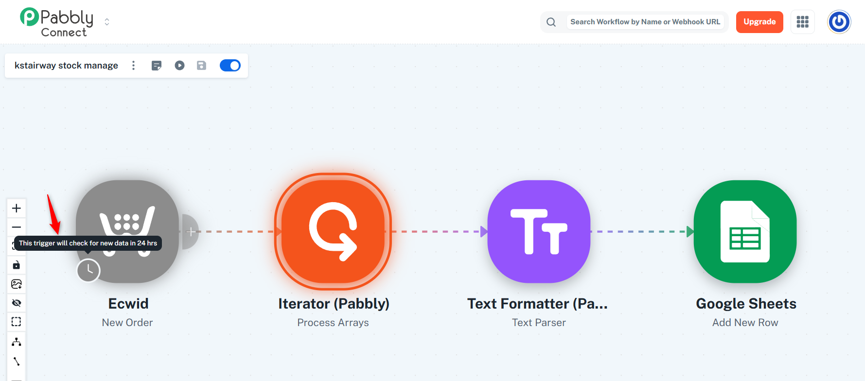

It doesn't look like your latest order has triggered the workflow, which is why it isn't appearing in your task history.
Please note that the Ecwid trigger application has a trigger interval of 24 hours, so it may take up to 24 hours for the workflow to be triggered for a new order.
For users on paid plans, we can reduce the trigger interval to 10 minutes, meaning the workflow will be triggered within 10 minutes of an order being placed.
