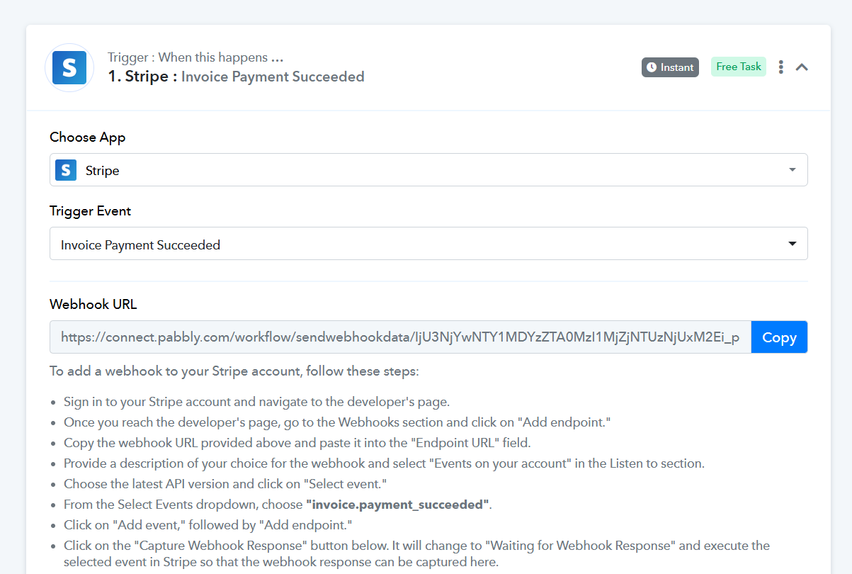

Hi @Lars,
If you are collecting payments through invoices, use “Stripe: Invoice Payment Succeeded”as your trigger step and check if it provides the invoice as a PDF directly in the trigger step. This will not require any conversion tools, thus no paid service needed.

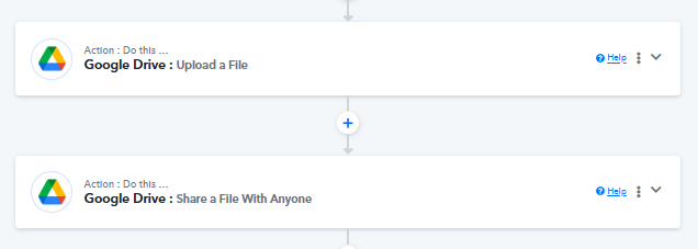

Option 2: Google Drive
  • Use Google Drive – Upload a File (map the receipt URL)
  • It returns a File ID
  • Then use Share a File With Anyone
  • You’ll get a public PDF link
  • Use that as the email attachment

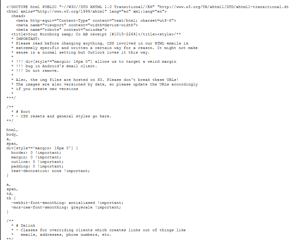

Thanks. I'm looking for a free solution so now testing the Google Drive option. The uploaded file is stored and displayed as HTML, see image.
Also, The Share a File with Anyone action doesn't allow me to map varaiables from previous step, so how do I ensure that it's the currently uploaded file that is shared?
Hi @Lars,
Yes, what you're seeing is expected. Stripe’s receipt URL returns an HTML page, so when you upload it to Google Drive, it is stored as HTML — not as a PDF. Google Drive does not convert web pages into PDF automatically.

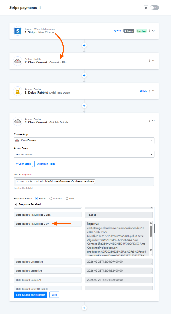

Thanks for your patience :) I've added CloudConvert now and the Convert A File action so that it retrieves the HMTL file from Google Drive and then converts it to PDF. No error messages so far. What I can't find is where the new file is stored. Do you know how to retrieve it? I followed the instructions in the Cloudconvert action to retrieve the job details of the conversion, and there's no location field, only the file name I supplied in the conversion step.
Hi @Lars,
If you’re using CloudConvert in your workflow, you do not need the Google Drive steps.
You can directly map the HTML receipt URL from the trigger into the CloudConvert action. CloudConvert will handle the conversion and return a PDF file URL, which you can then use further (for example, as an email attachment).
We’ve deleted the unnecessary Google Drive action in the example and highlighted the field where the PDF URL is returned. Please refer to the attached image for clarity.
