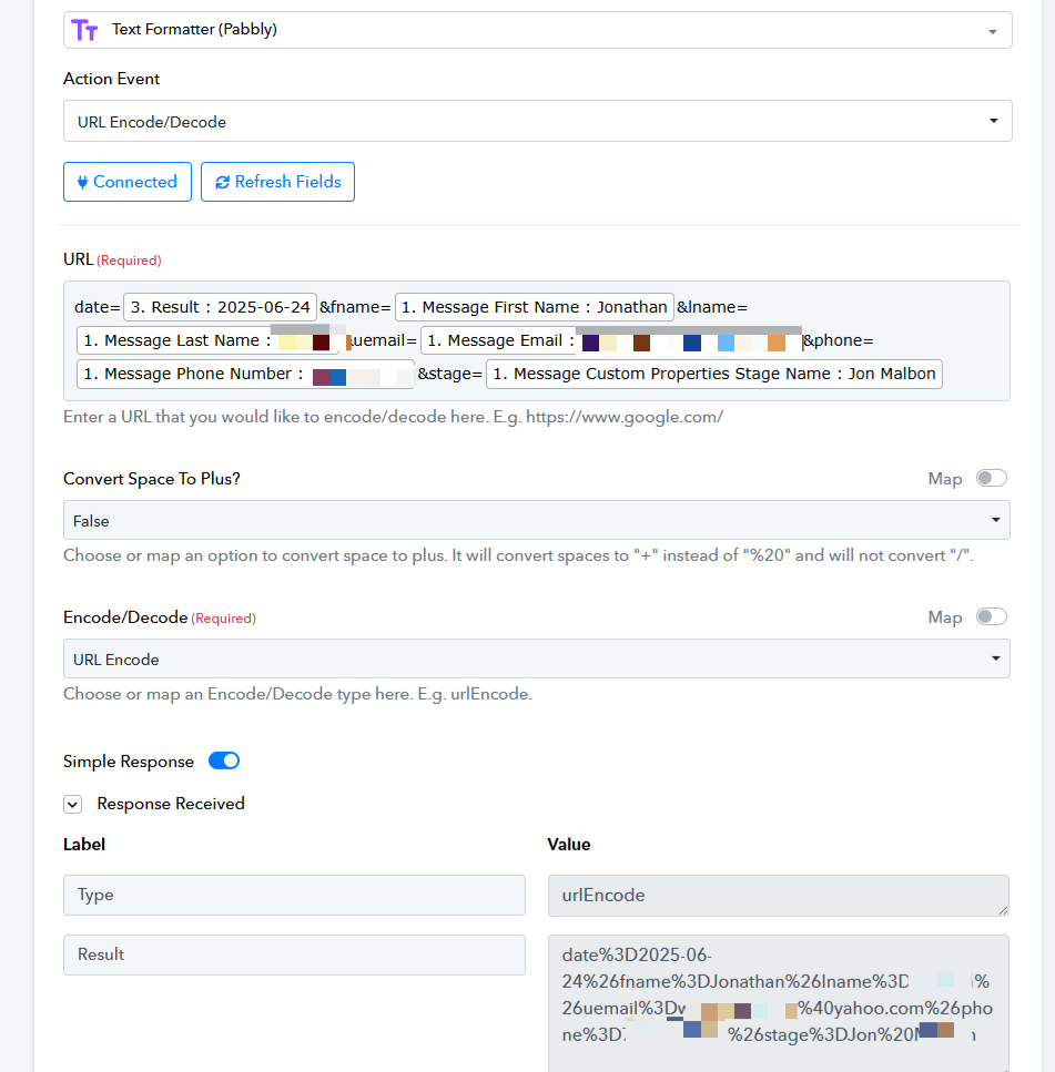

I'm using the Text Formatter > URL Parameter encode Action module, but it's not quite working. For example, it's not replacing a {space} with '%20' in the output, which is breaking the string.

Working fine for me you can check below screenshot. Make sure to select "False" in "Convert to plus " field.

Thanks for that. I was using the 'URL Parameter Encode' Event rather than URL Encode/Decode.
However, even with the latter, the output isn't right - it's replacing '=', '@' and '&' which is preventing the ?string being used by the site
Any ideas what I need to change to get a proper ?string output?

Encoding means it'll replace @, =, {space} and special character. If you want to replace just space with %20 then use find and replace method in which put space in find field and replace it with %20

DOH! I didn't think of that! Thank you for your patience in explaining it to me and helping me improve on my ignorance! I will try that! Cheers :)
