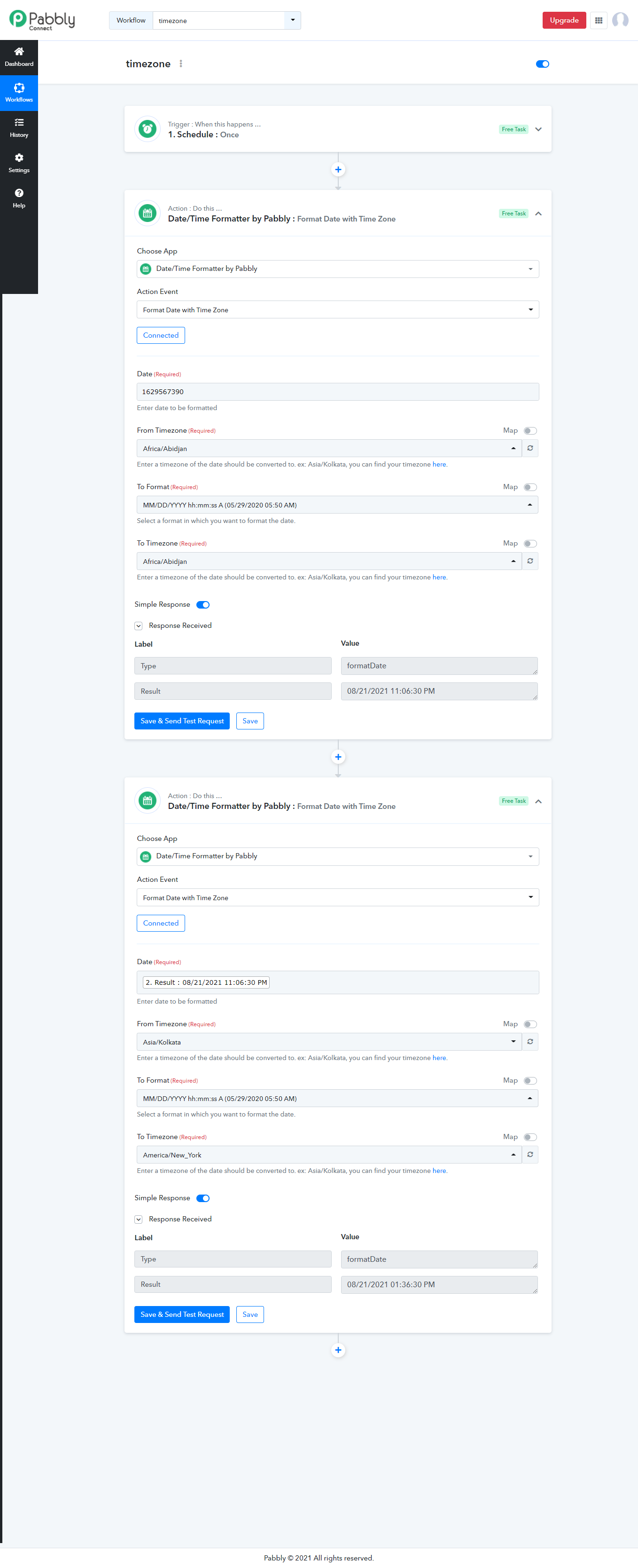

Hi how I can use the Date/time formatter to get NewYork timzone value from an epoch based timestamp.
ie: 1629567390 should return 8/21/2021 1:36:30 PM
Tried the GMT to NY converter but doesn't work accurately. Any suggestion? Thanks.

What is the timezone of 1629567390?
Are you sure it is in Etc/GMT?

@Pabbly I am also always getting Indian time based output, no matter what timezone I select in to and from timezone fields. It should be actually same as @Chintan showed in above screenshot. Please take a look into this.
Chintan
Thanks Fagun. That seems to be the way to get it converted properly. Its kind of mysterious though, picking afrika as the base and then Asia/kolkata in the next round.
Thank you for your help.
