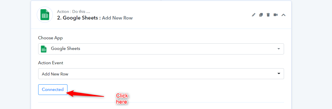

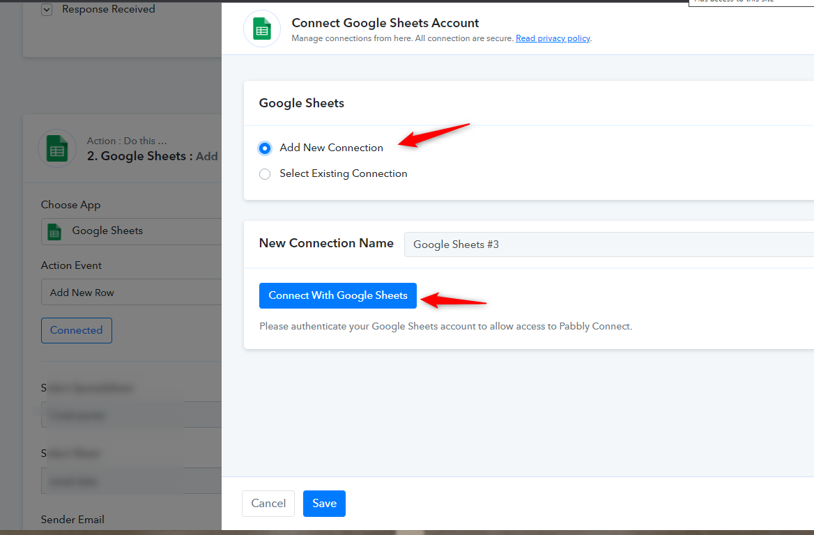

You need to reauthorize Google Sheets to fix this as shown below -
that helped

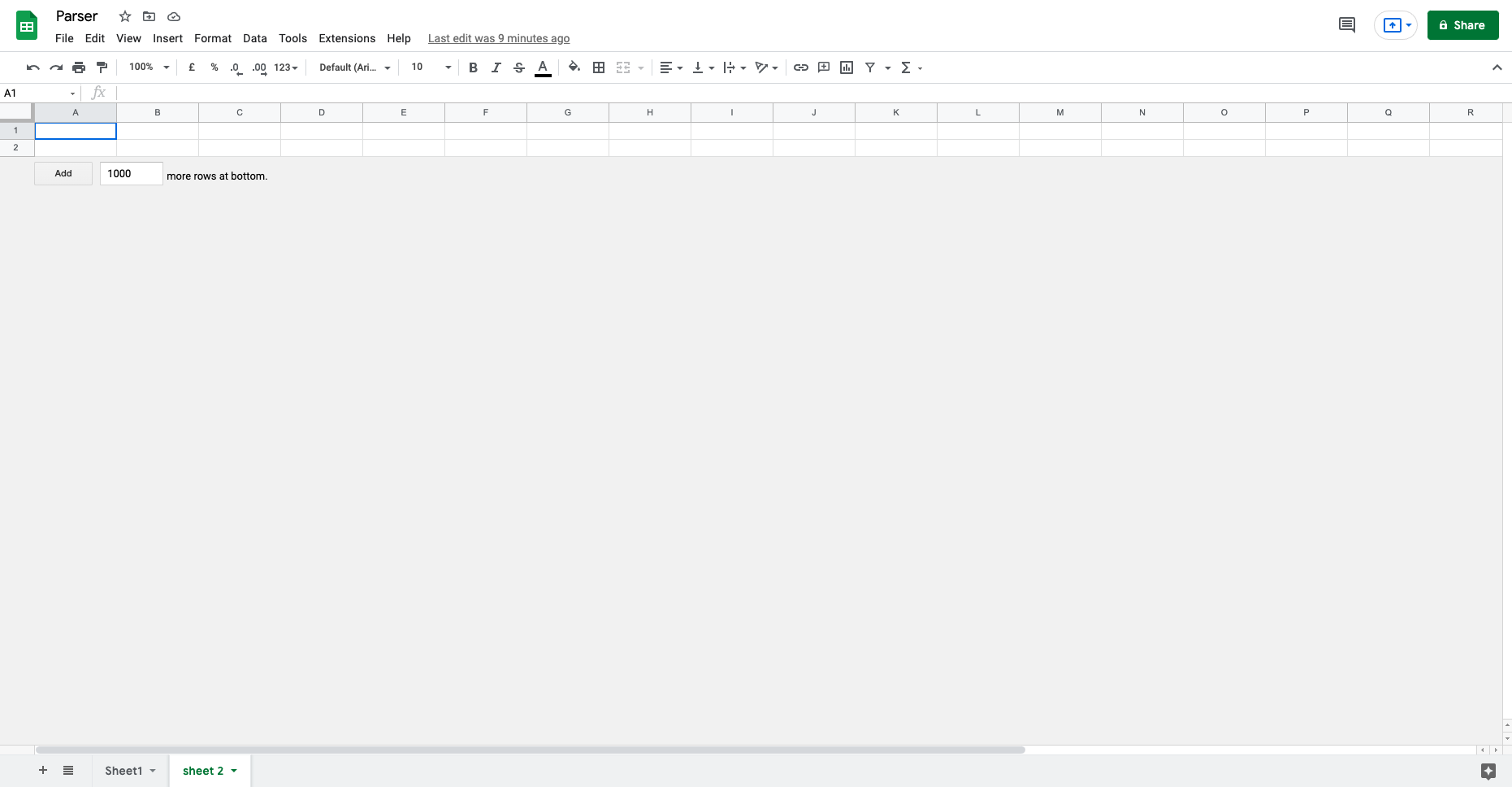

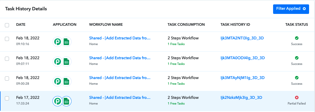

but even though the task is tagged as successful there is still no entry in google sheets

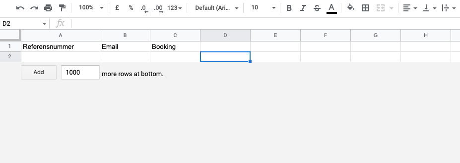

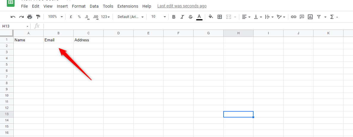

Can you confirm if your Google Sheet has header column defined something like this?

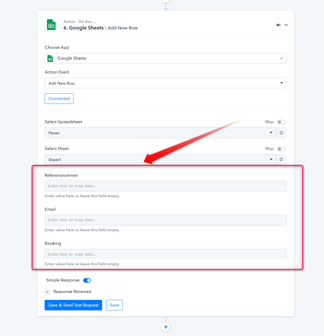

Hey @Christo Tee
Kindly map the respective data in the fields of the " Google Sheets: Add New Row" action step to pass the data in your sheet in real-time.
