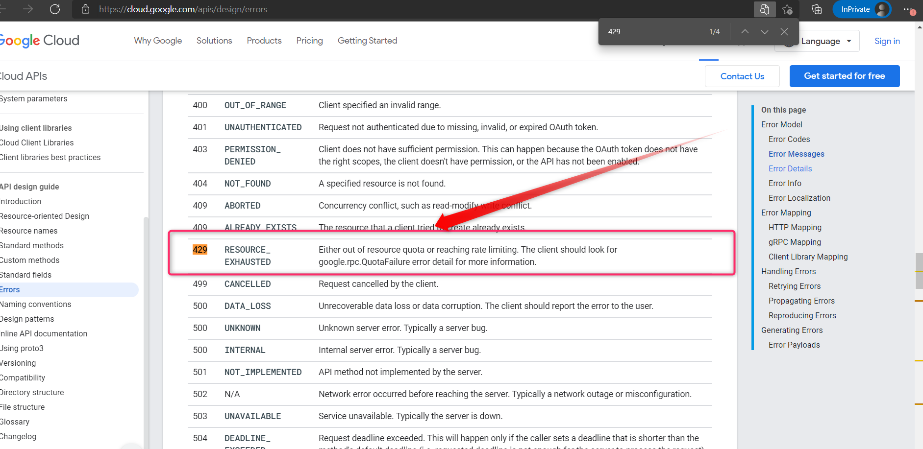

As we can see from your shown error, you have exhausted your rate limit to pass the request to write data per minute by "Google Sheets".
Google API documentation for the error which you have got.

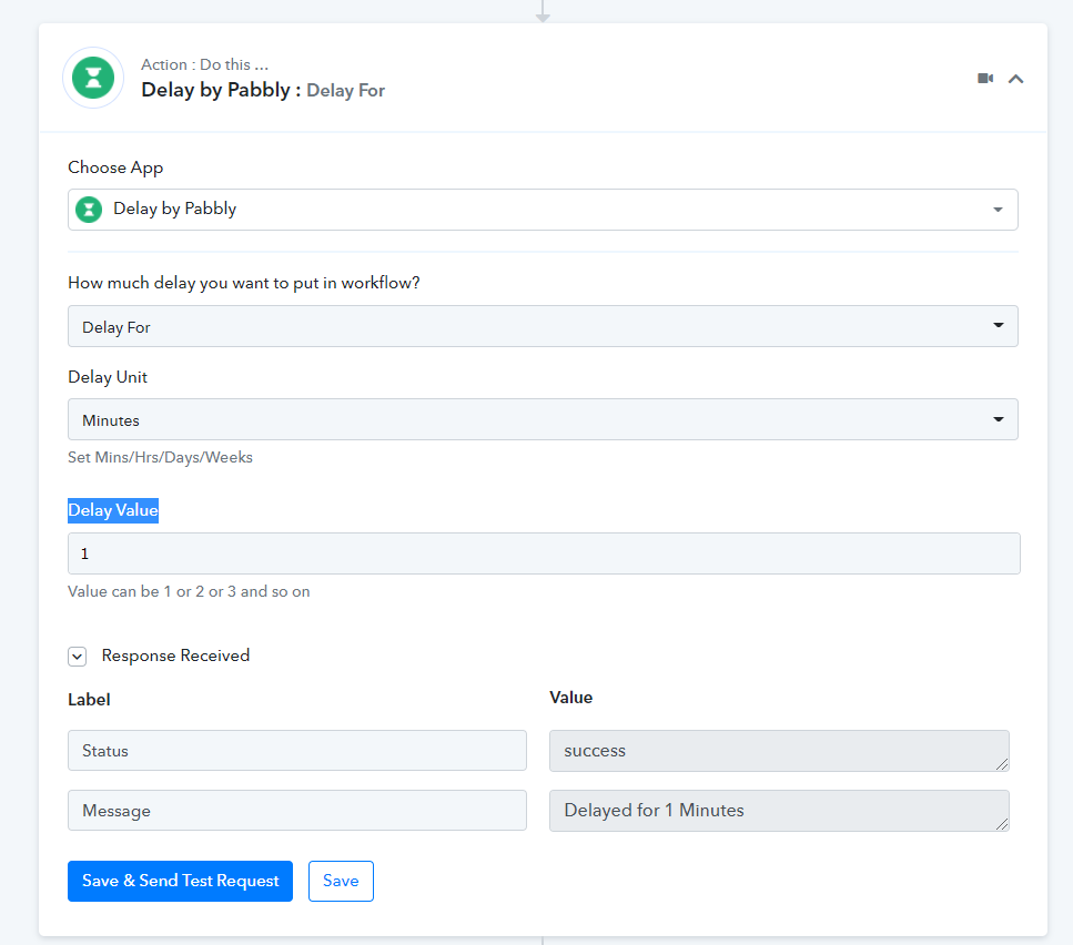

Moreover, you are also running the tasks in bulk and because of that, the error has occurred by the Google API. So, we should suggest to us a delay action step to delay the task to run 1 min after every update of value, in that way you wouldn't be exhausting your rate limit.

i’m using the same workflow and webhook on all of those 300 tradingview alerts. If I use a 1 min delay, will they all happen 1 min later at same time and still create the same problem. If so, shoulg I setup multiple identical workflow and webhook with digfferent delays (50 at 1min delay, 50 at 5min delay, etc)?
Hey @patrice.lapointe01
Instead, you can try creating a router in your same workflow with a different delay on it.
