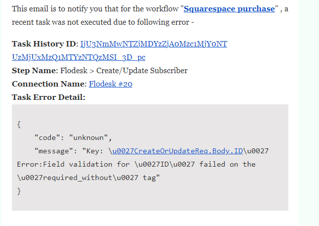

All of a sudden I have been receiving this error message for an existing workflow that had been functional. I have reconnected flodesk to the step but it is no longer working. Can someone let me know what I need to fix to get it working again?

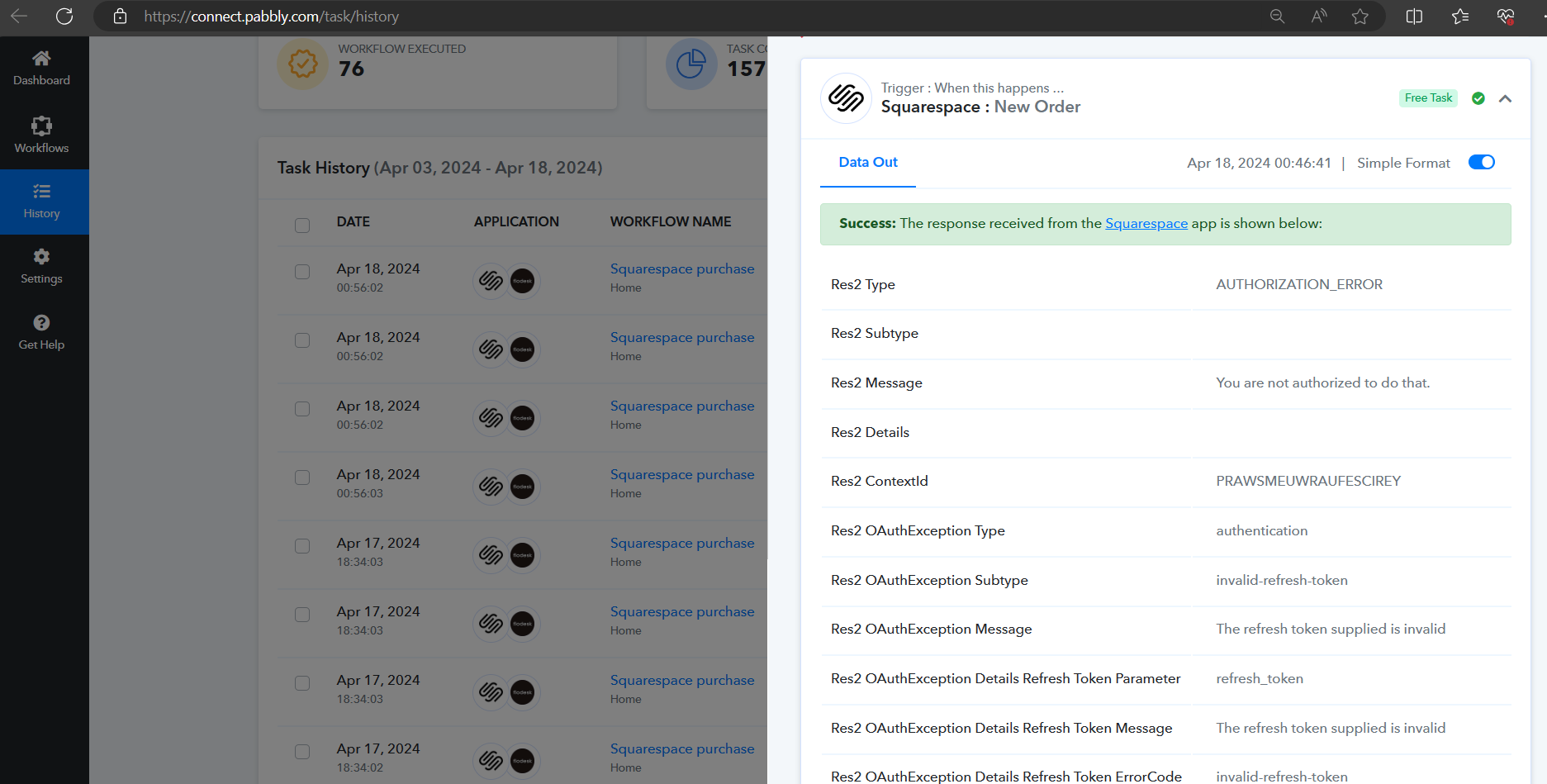

Due to an authentication error in SquareSpace, the webhook response didn't come correctly, leading to an error in the Flowdesk action step: 'Key: 'CreateOrUpdateReq.Body.ID' Error: Field validation for 'ID' failed on the 'required_without' tag.'
Kindly reconfigure your SquareSpace trigger event and then check again.
slp madness — Reply ·
Thank you for your reply. If I try to reconnect/reauthorize Squarespace connection again and leave the workflow alone without retesting it, do you think it will work? I don't want to have to do the test again. That always seems to screw things up
The 'Squarespace: New Order' trigger event setup requires you to create a new test order after re-establishing the connection. This order will be captured in your workflow setup; you cannot skip this part.
