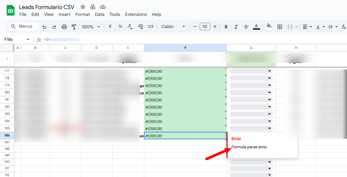

Pabbly is getting the information correctly, but when it comes to my Google Sheets it shows "error".
As you can see at the top, the telephone "comes fine", because it has numbers and those sttuf but I have no way to change the format of the cell.
Any solutions? Thanks in advance.

The #ERROR occurs because Google Sheets interprets the + as a formula. To fix it:
  • Keep the + Sign: Add an apostrophe (') before the number (e.g., ' +34 606 13 47 24).
  • Remove the + Sign: Use Pabbly Connect's Number Formatter to format the phone number before adding it to Google Sheets.
