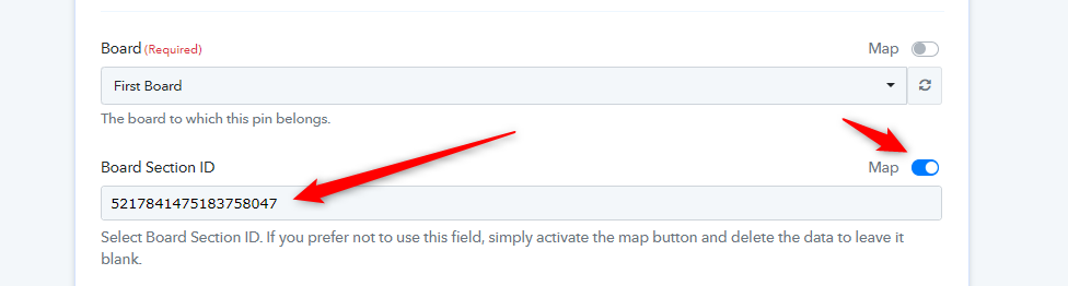

Hey @deborahlee
In the Board Section Id, you must pass the Id instead of the name.
So, try placing the IDs of the Board in place of its name.

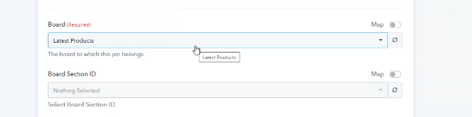

You can check the Board Id from the Board field as after toggling the map button you will get the Id of the particular board in this way you can get the Board Id accordingly.
https://www.screenpresso.com/=GI01c

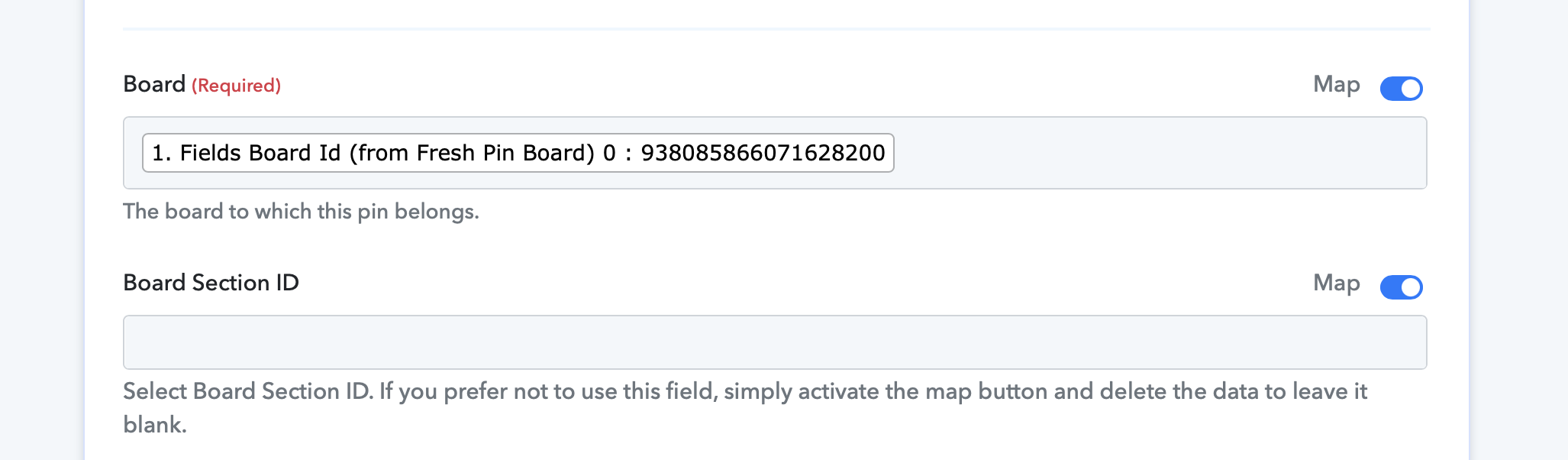

Thank you. So I went through and got all my board Id's and added them to my airtable. However, now when I map the board id field I get the error 40 with message Board not found.
Any ideas what I need to do now?
Deborah
Have you picked the Board Id or Board section Id? You need to pick the Board Id from the Board field.
deborahlee — Reply ·
I have mapped the board to the board id field I have in Airtable which I populated with all the board ids. If I don't map and just enter the board id then it works fine but it won't work when I Map the field even though I have the exact same id in the Airtable field.
Thank you
Can you check once whether that board ID exists in your Pinterest account which you have connected with.

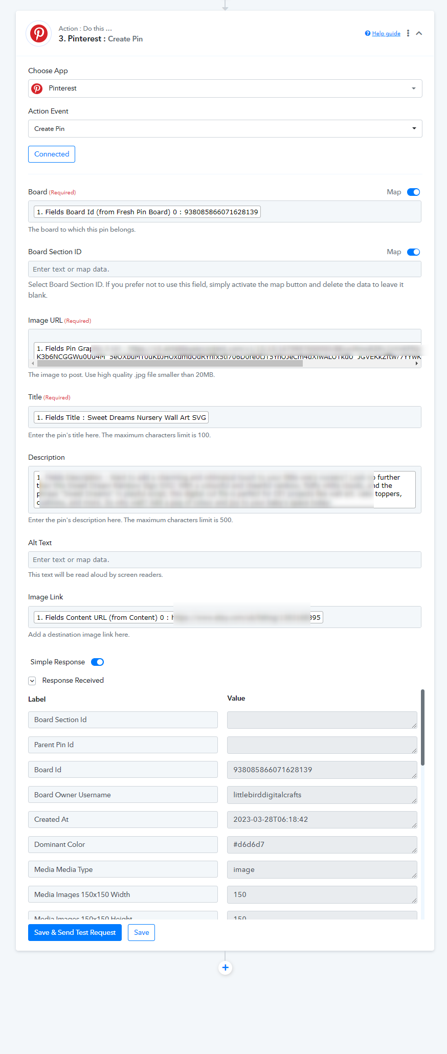

Something has happened to the Pinterest Action. I have just opened the workflow and I have an error with the image URL. There is no longer a field for the URL for the pin graphic which was mapped correctly this morning. Any ideas what could have happened? Thanks
Hey @deborahlee
After remapping your Board Id and other fields. We can see that your Pinterest action step is working fine.

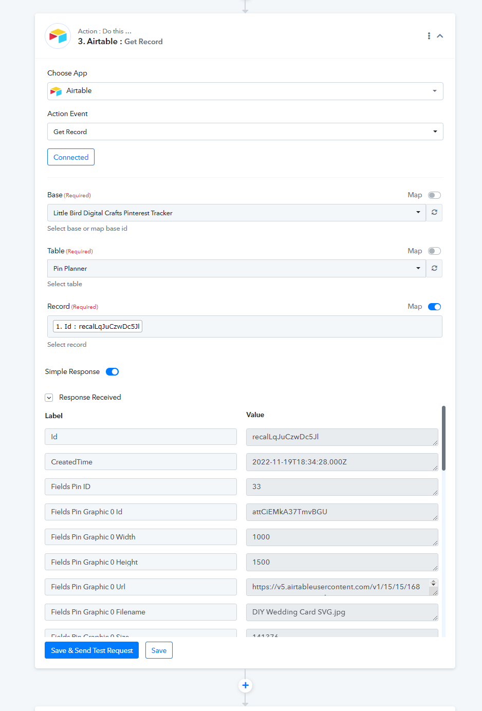

Thank you. I have an issue where sometimes the trigger fires immediately when a record is added to the table but before I have had time to fill in all the fields necessary, so when it gets to creating the pin some fields are blank and I get an error. How can I get round this?
Hey @deborahlee
You can add the "Airtable: Get Record" action step after the Delay action step to ensure that if it is triggered after a few filled columns, it will fetch the entire row.
