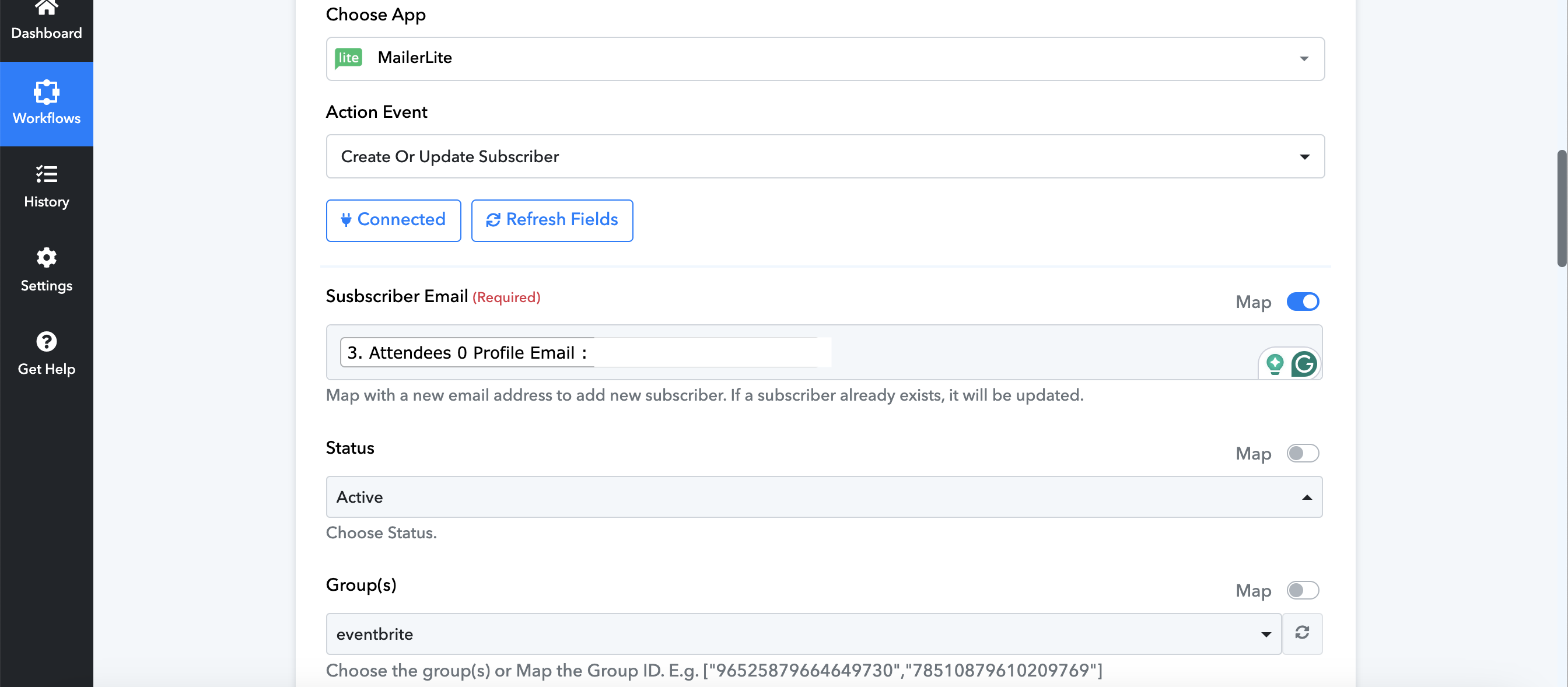

Still not working the integration. Trying to get customer details and send to details to mailerlite. Eventbrite can get details but not going into mailerlite.
Hi @hnjkeo,
Based on your recent task history, the details seem to be getting passed from Eventbrite to MailerLite. Please note that you are using the 'Create or Update Subscriber' action event in MailerLite, so there may be instances where the contact is updated if the email address is the same.

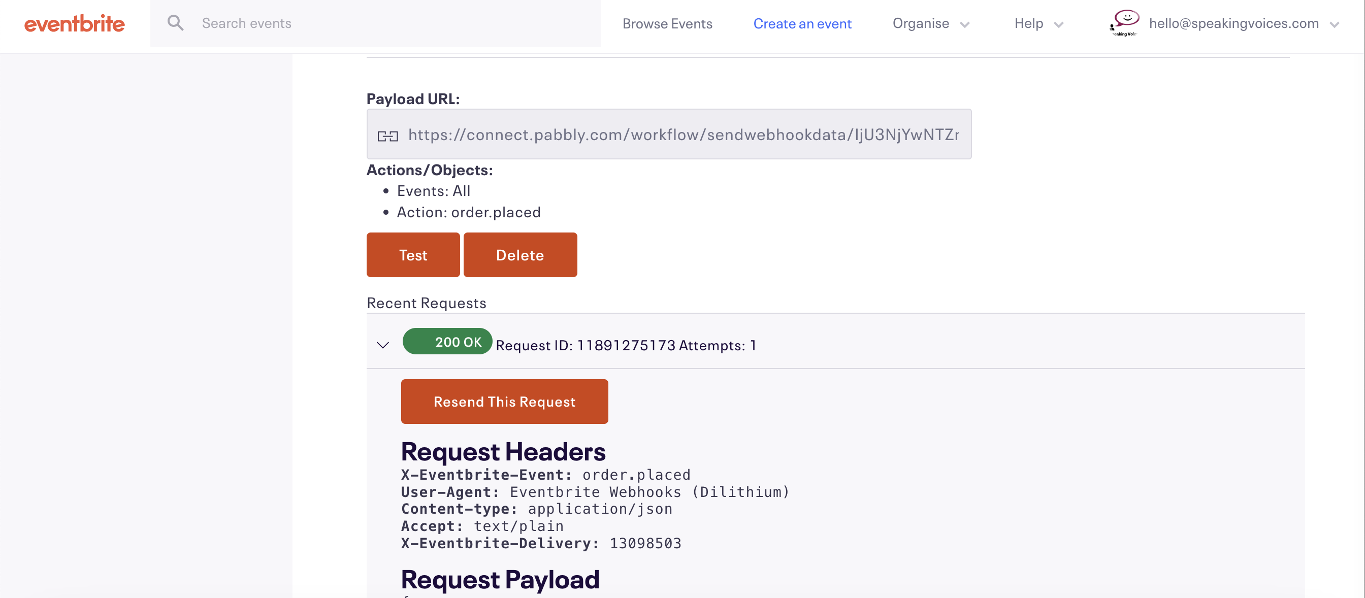

I had 2 new people who signed up to my events and their email address isn't in my mailerlite

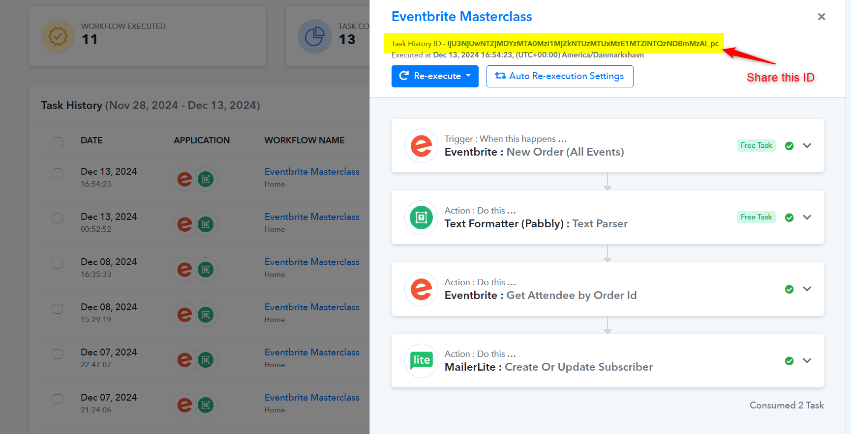

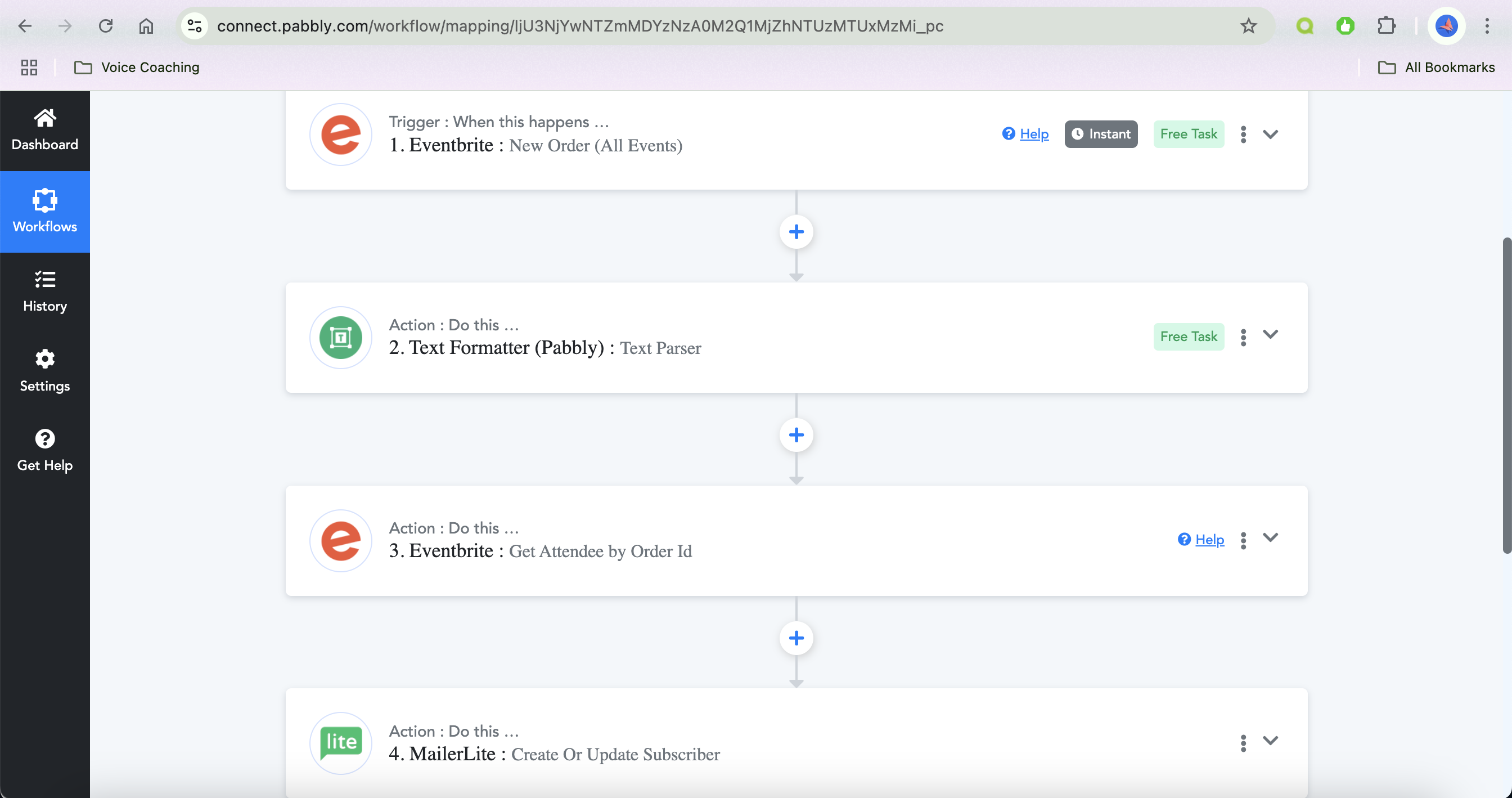

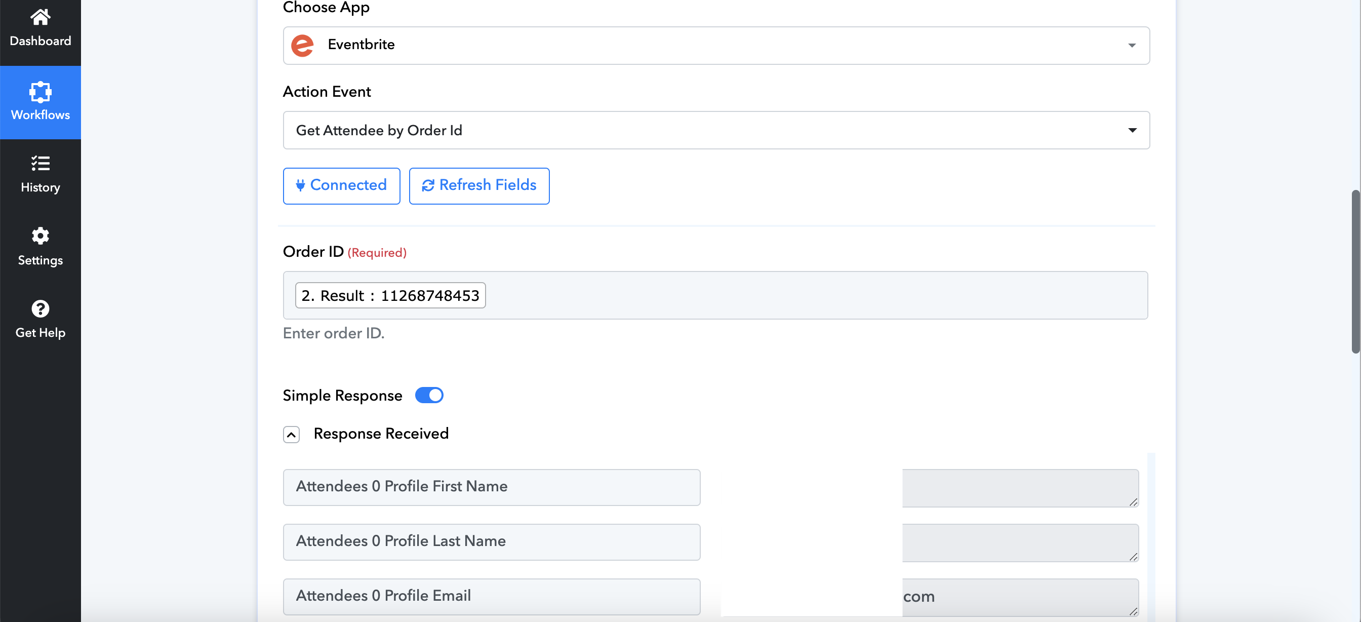

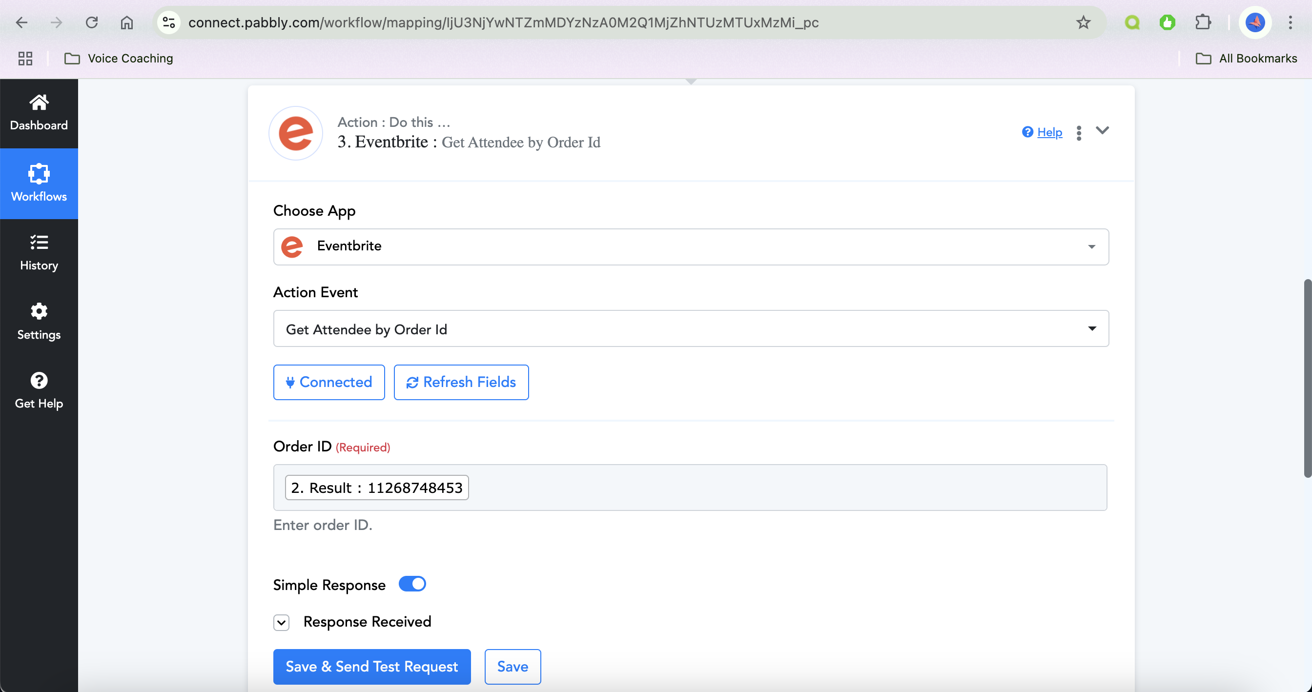

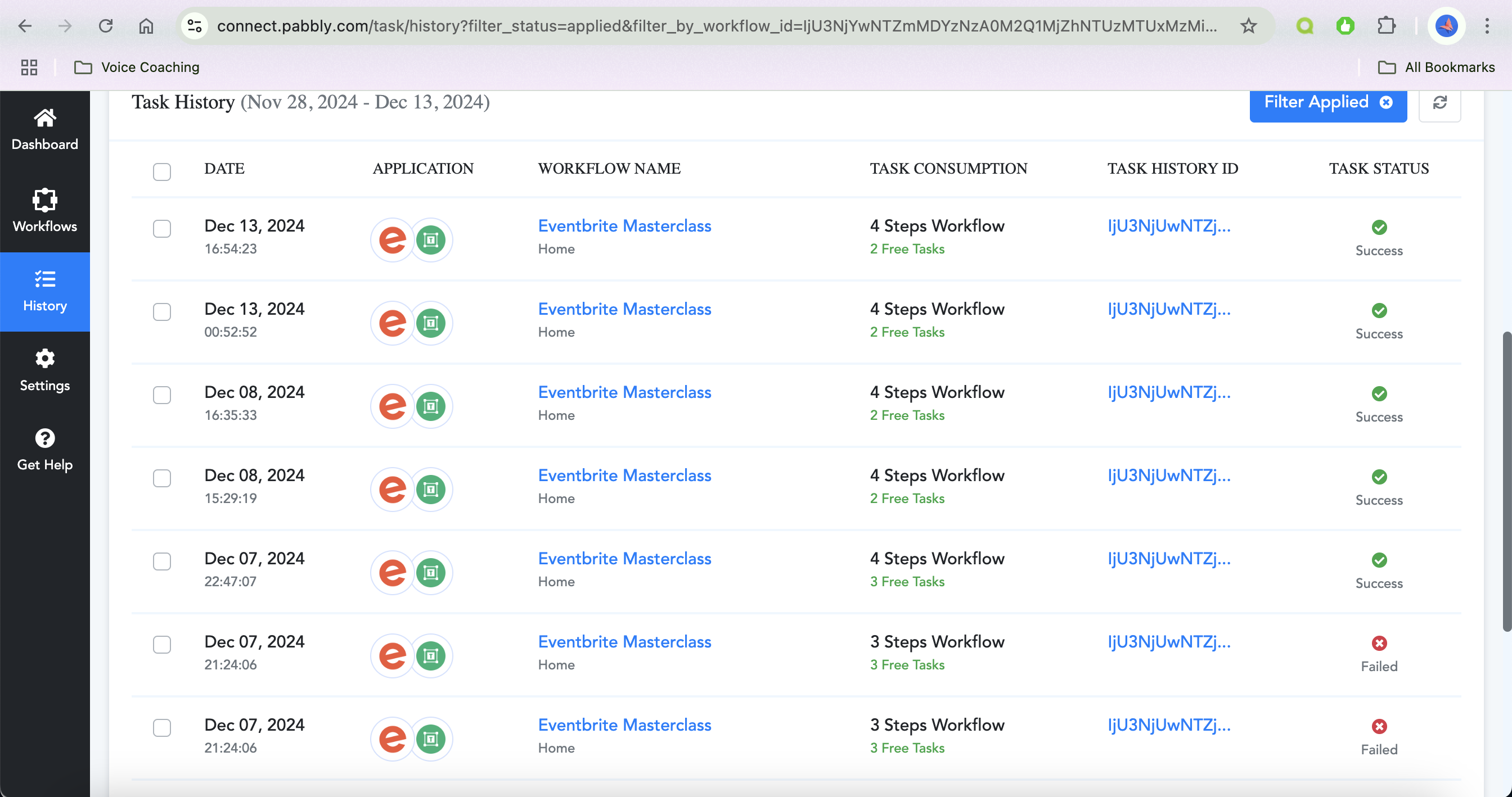

Yes I can give you the order IDs. So for the latest one I can see that the API URL is different to the eventbrite get attendee by ID. Only 2 tasks are completely successfully out of the 4. Eventbrite get attendee by ID is not working so therefore it doesn't into Mailerlite.
Please share the specific Task History IDs where the subscriber was not added to your MailerLite account.
hnjkeo — Reply ·
13th Dec - IjU3NjUwNTZjMDYzMTA0MzI1MjZkNTUzMTUxMzE1MTZiNTQzNDBmMzAi_pc
13th Dec - IjU3NjUwNTZjMDYzMTA0MzA1MjY1NTUzNzUxMzU1MTY3NTQzMDBmMzIi_pc
8th Dec - IjU3NjUwNTZjMDYzMDA0MzE1MjZmNTUzZDUxM2E1MTY2NTQzMjBmMzUi_pc
8th Dec - IjU3NjUwNTZjMDYzMDA0MzE1MjZmNTUzNTUxMzY1MTYwNTQzNTBmMzci_pc
(Test for my own email address) 7th Dec - IjU3NjUwNTZjMDYzMDA0MzA1MjY4NTUzNjUxMzQ1MTY2NTQzMTBmMzMi_pc

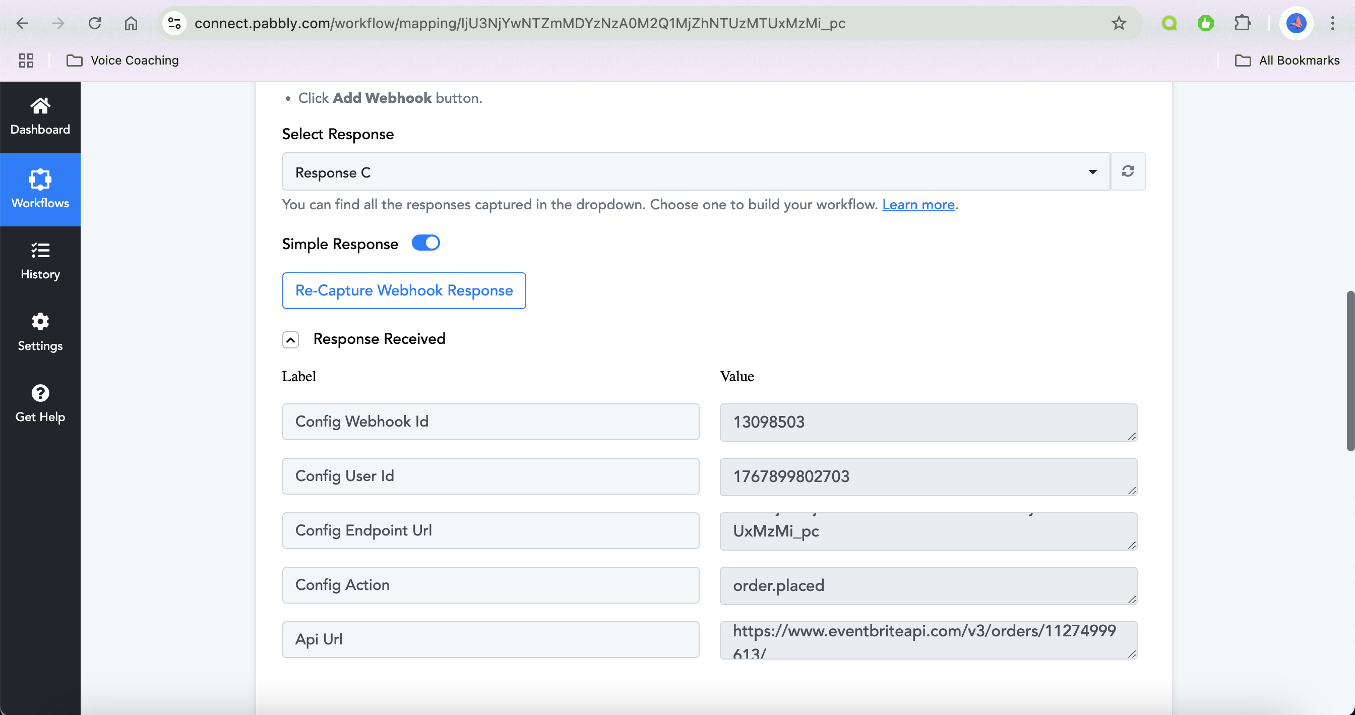

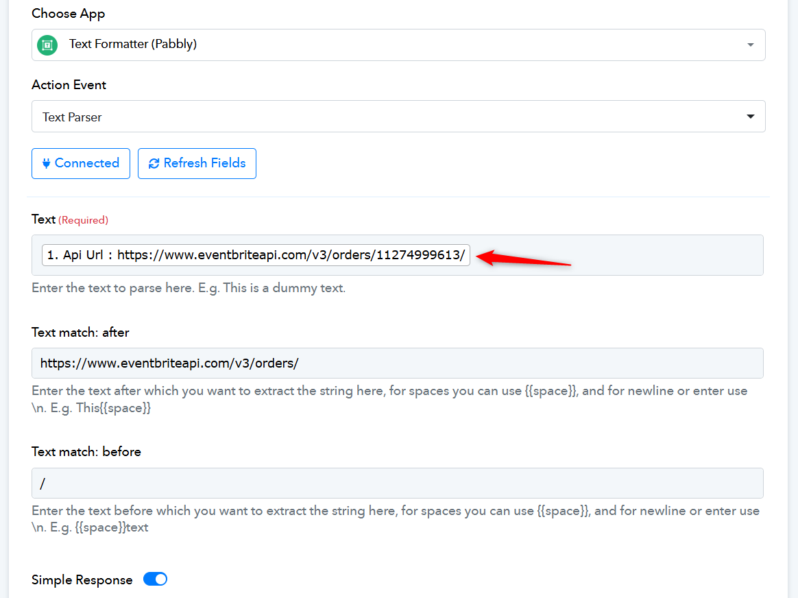

It seems that the Text Formatter was not set up properly in your workflow, which caused the Order ID to not fetch correctly. We have made the necessary changes on your behalf. Please test the workflow on your end.

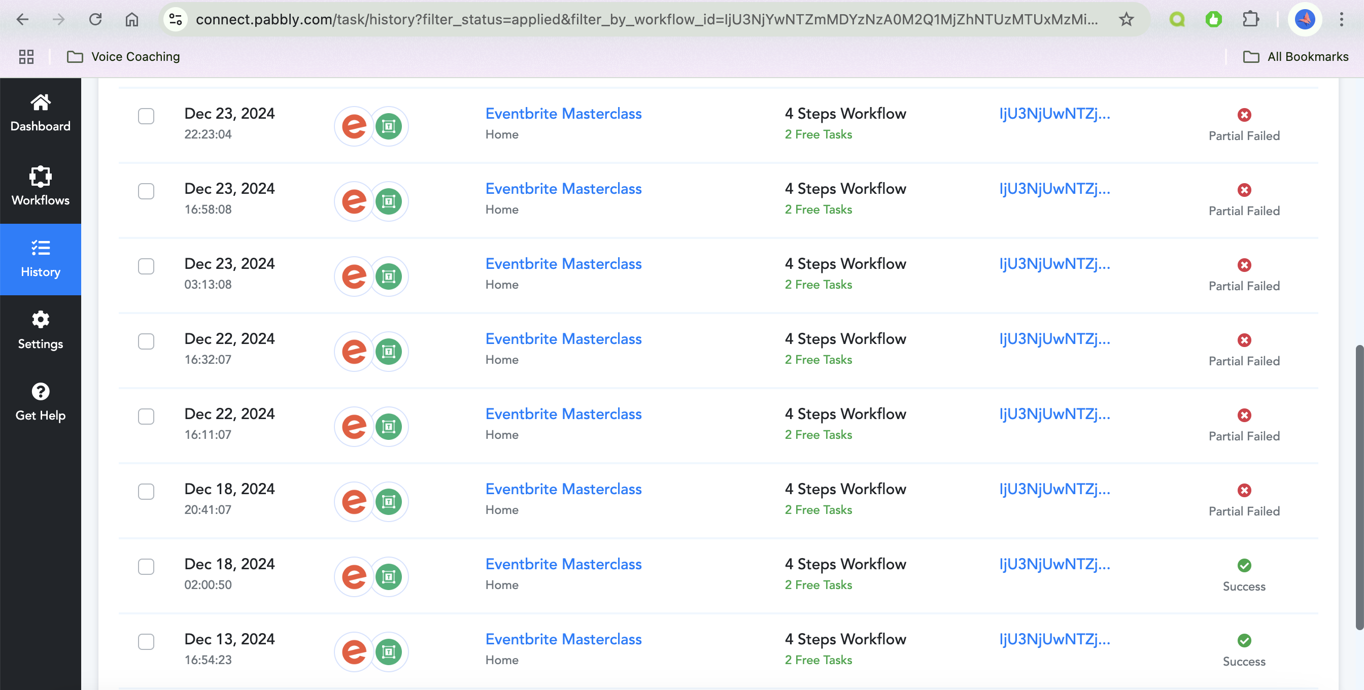

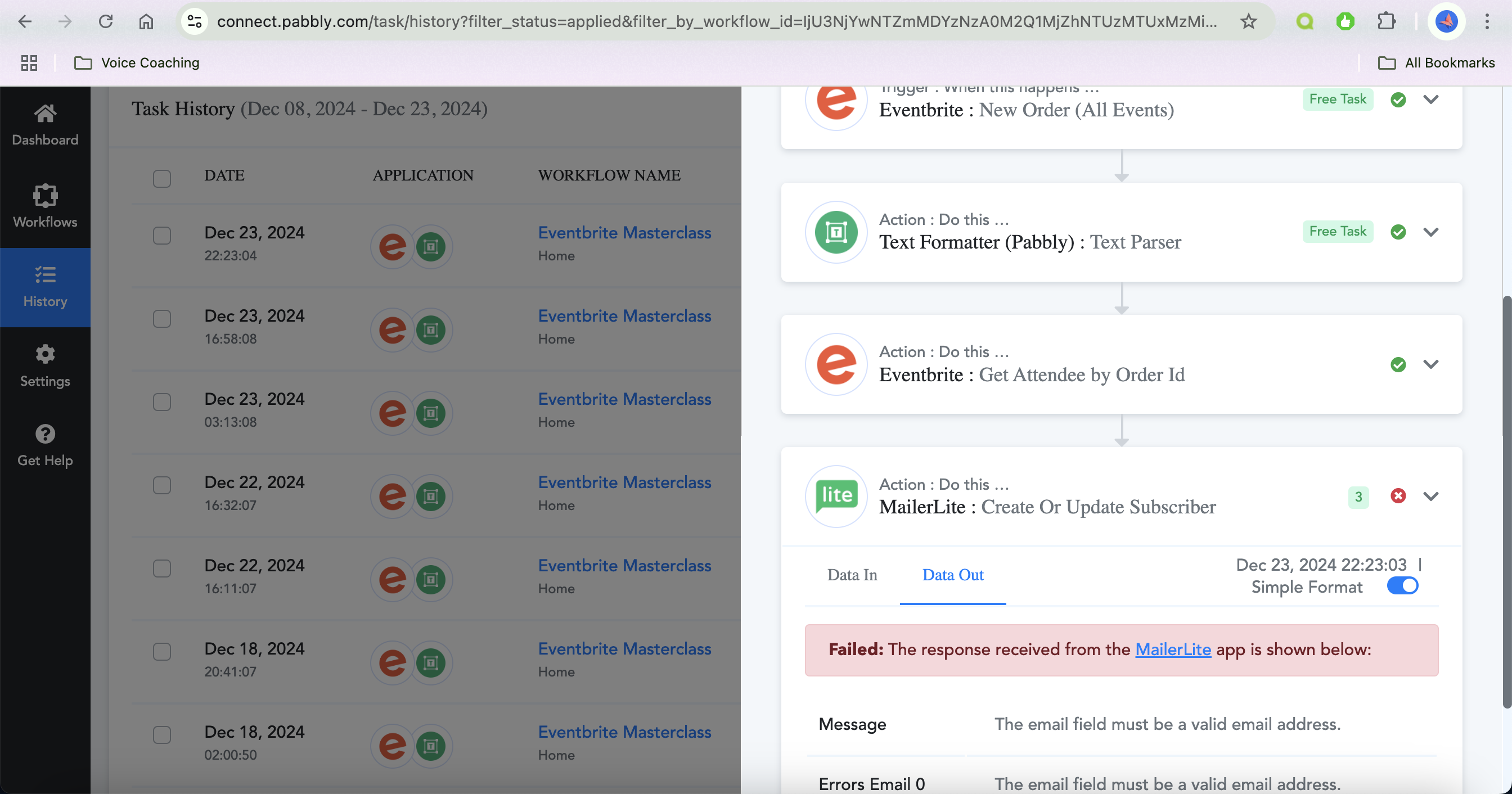

thank you, I have tested it. It worked for one customer. Rest of the customers failed on execution with mailerlite.

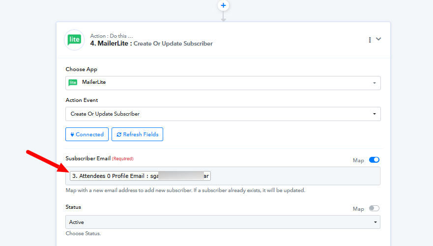

Hello @hnjkeo

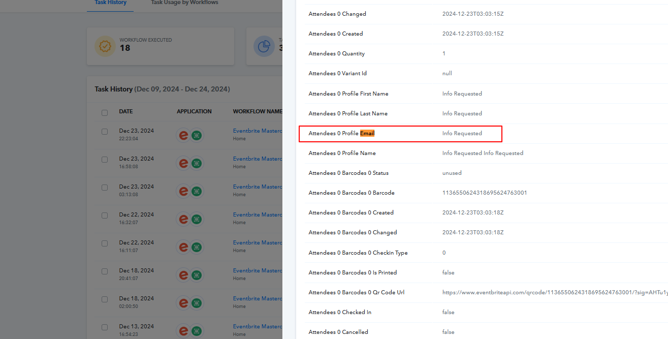

You are receiving these errors because the value received under the Email field from the Eventbrite: Get Attendee by Order ID action step is not a valid email address. Please refer to the attached screenshots for more details.
We kindly request you to check and confirm if the email addresses for the failed attendees exist in Eventbrite.

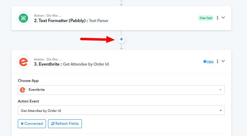

Hello @hnjkeo,
Could you please add a delay of 2-5 minutes between the Text Formatter and Eventbrite action events Once you've made this adjustment, let us know if it resolves the issue.
hnjkeo — Reply ·
I have added it
