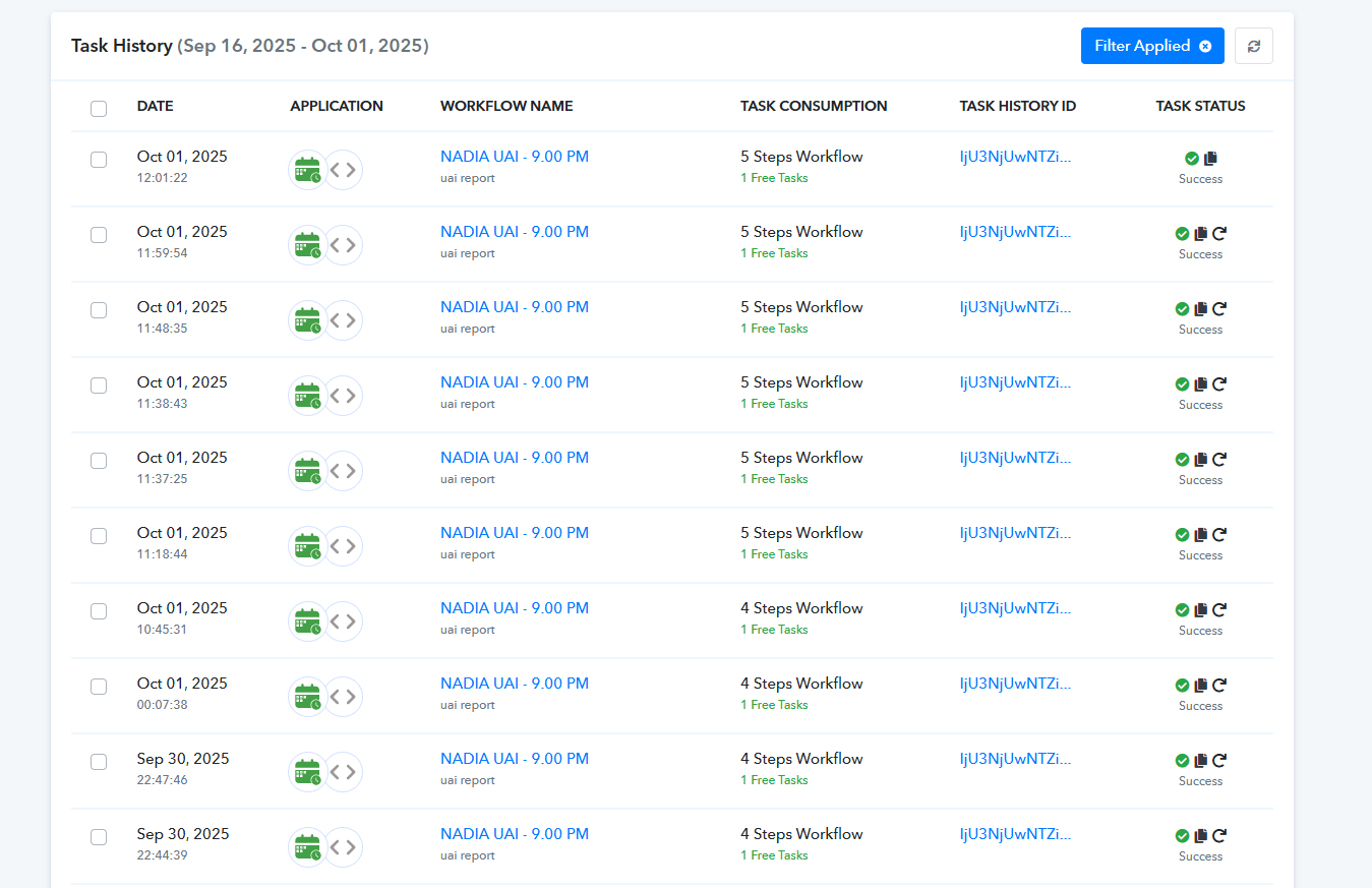

Anushka Sahu — Reply ·
Hello @fahmizohir,
Upon reviewing your account, we found no error in the workflow you shared though they are re-executed task history.
Could you please recheck the workflow and, if you are encountering the error in the Classic Builder, share the workflow URL of that particular workflow Kindly provide the relevant information so we can assist you better.

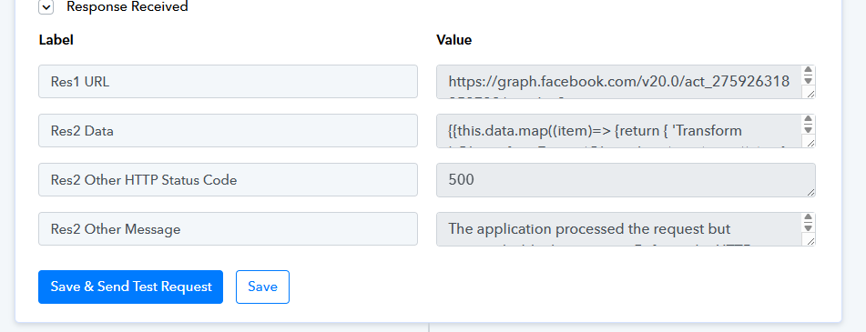

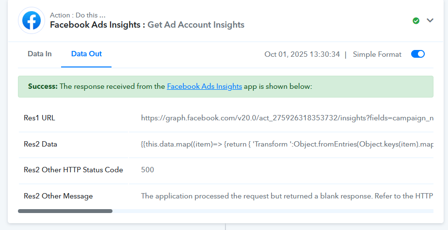

fahmizohir — Reply ·
it success if im not filter the data, i use that filter by field , using campaign.name. it response good on workflow but not when execute real time. i assume it error on how pabbly handle the output url. please check
otherwise on classic build, it show error if i put the filter. Error on workflow, but in beta build like i said, it response on workflow but not when execute.

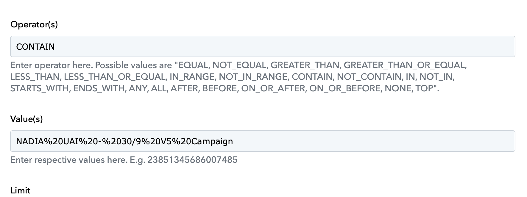

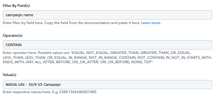

Soumya Tripathi — Reply ·
Hello @fahmizohir
As we have checked, the issue you were facing occurs because when the operator is set to “CONTAINS”, the value must be sent in an encoded form.
Please refer to the below image:
However, you were sending the value as name as shown in below image:
Soumya Tripathi
