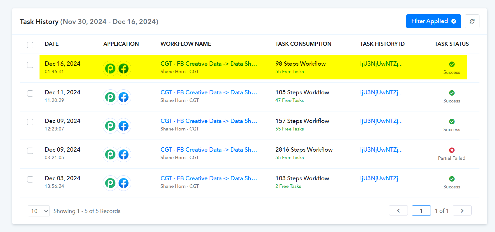

Hi, i'm trying to get all ads from my ad account. However because there's too many ads, the RSS was cut off
How do I get it to show all?

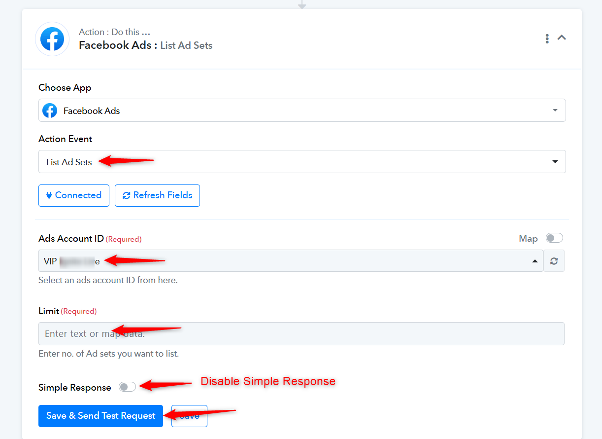

One way i can think is to have an action to list all available Adsets, then iterate through each adset and request the ads within that adset.
If you know what I mean...
But i don't know how to do that... any ideas?
Set up Scheduler as the trigger step of your workflow. Then, use the Facebook Ads: List Ad Sets action to retrieve all your Ad Sets. Next, add an Iterator to process each Ad Set, and use the response from the Iterator wherever needed.

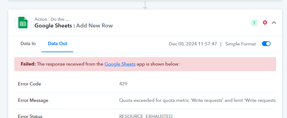

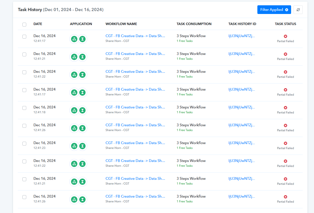

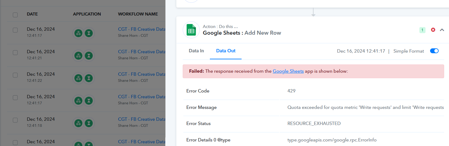

But sometimes i still get this error
Is there a way to have this specific action try again in 5 minute if this happens?

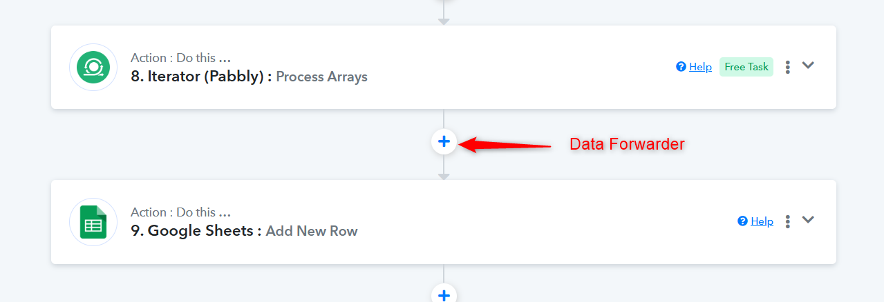

This issue occurs when we use an Iterator and a Delay step within the same workflow. If you wish to use an Iterator and a Delay step in the same process, you will need to split your workflow into two parts using a Data Forwarder.

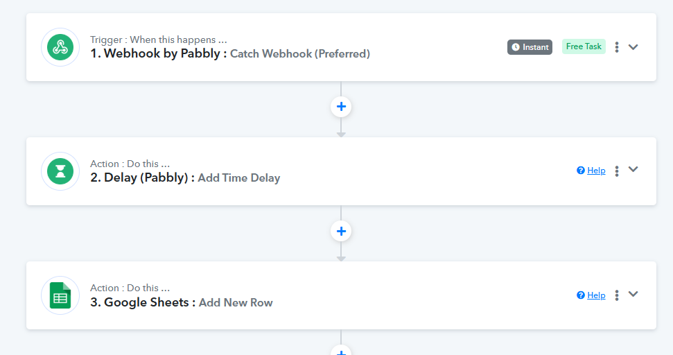

To do this, add a Data Forwarder immediately after the Iterator step. Forward the data to a different workflow, then add the Delay and Google Sheets action step in the other workflow.

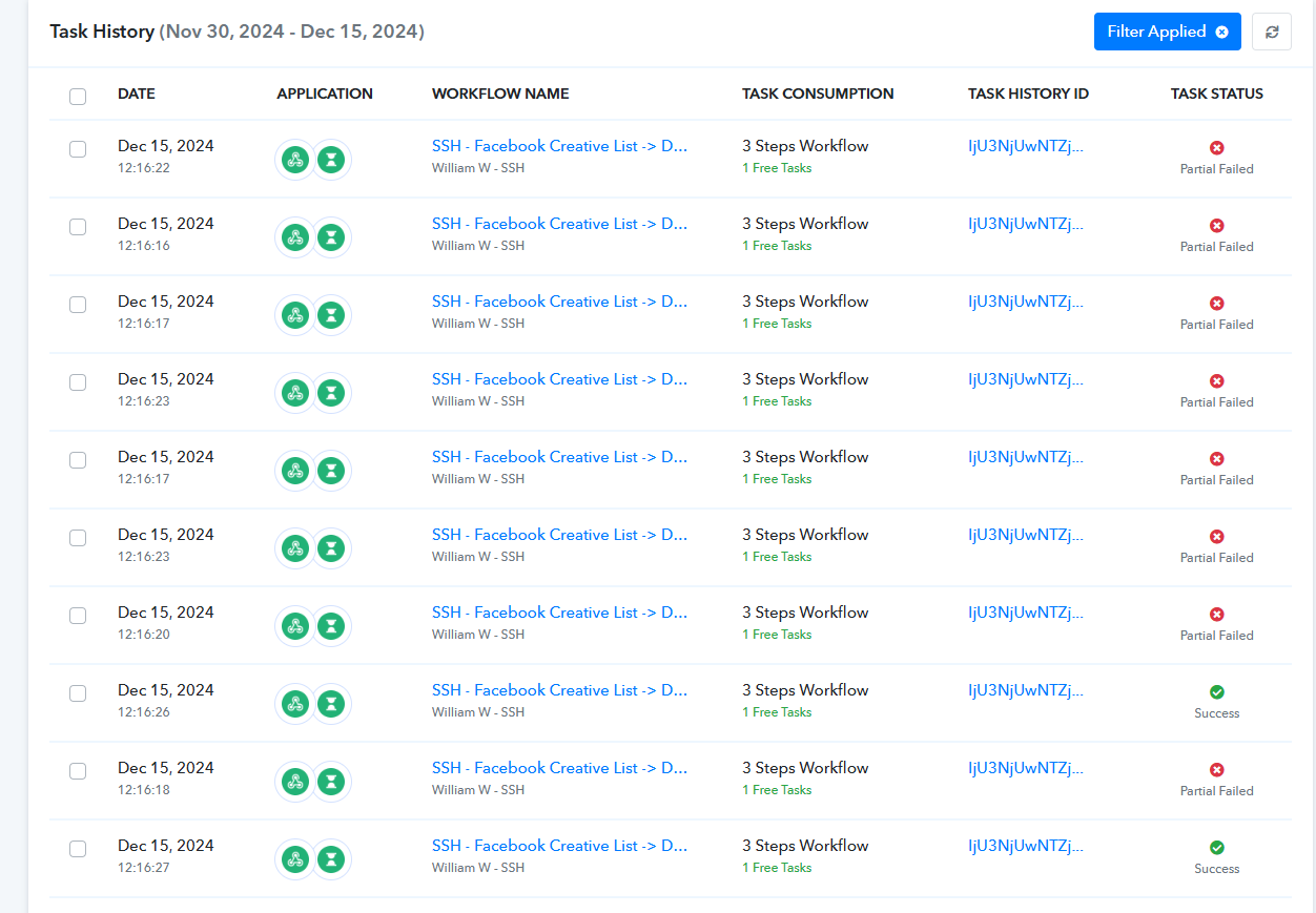

TheDigitalMarketers — Reply ·
i tried it, it is still the same

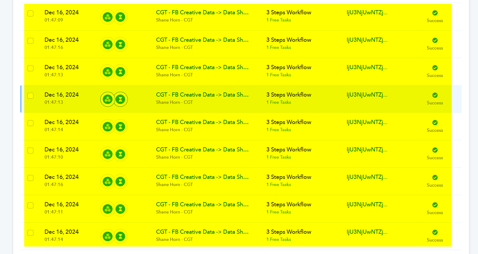

ok. it's solved.
I added a counter and and set it to increase and reset to use that as a delay to the second workflow.
