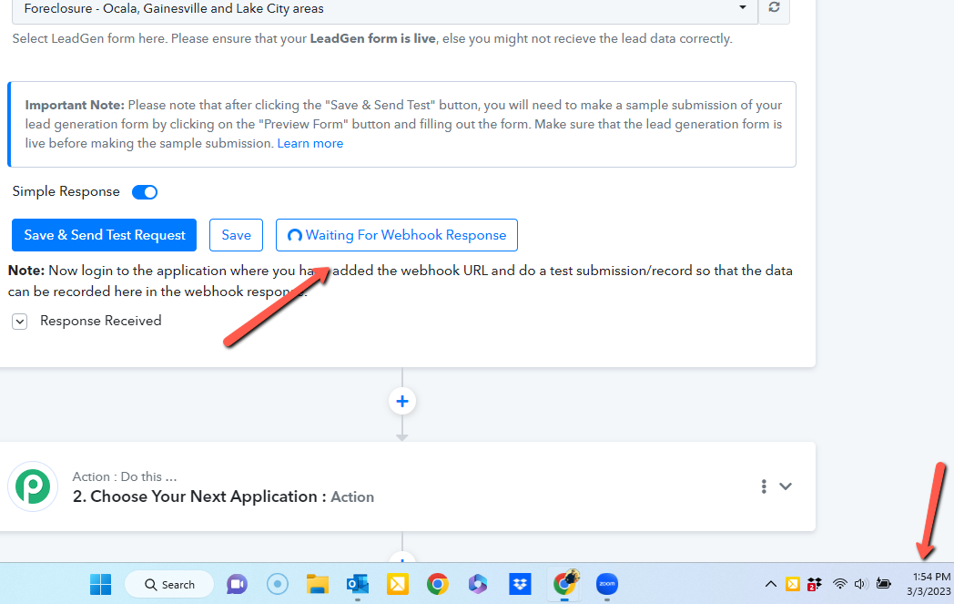

It took about 20 minutes for the Pabbly webhook to return the data from my Lead Ad form. I just connected a 2nd form and it is taking just as long. Is this standard?
A
Arshita
Hey @tjbarkerjr
As we can see, you are using the Instant version of the Facebook Lead Ad to capture the response so it should capture the data instantly.
If you are facing the issue then please record a short video on your concern so that we can look into it and help you accordingly?
4 hours later and it still hasn't populated

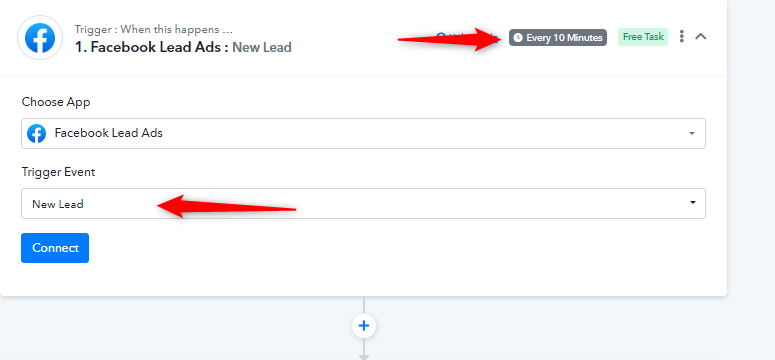

Kindly use the "New Lead" option as an action event in place of "New Lead(instant)" and then try again to capture the response.
The "New Lead" option as an action event will trigger your data in every 10 minutes.
Perhaps their testing leads ad tool to capture the webhook response might be temporarily disabled from their end.
