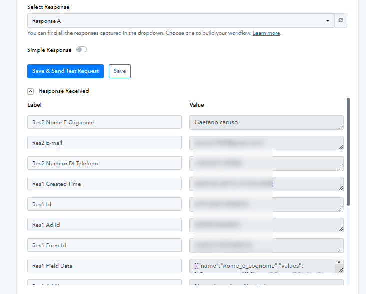

I've created a workflow (first) that can fetch lead from facebook lead ads and send to api, but nothing happens.
What's wrong?
manthan
Hey @museo
We have observed that you are receiving leads from Facebook. Please refer to the screenshot provided below for your reference.
museo
Yes, 1 of 4, but now it's working.

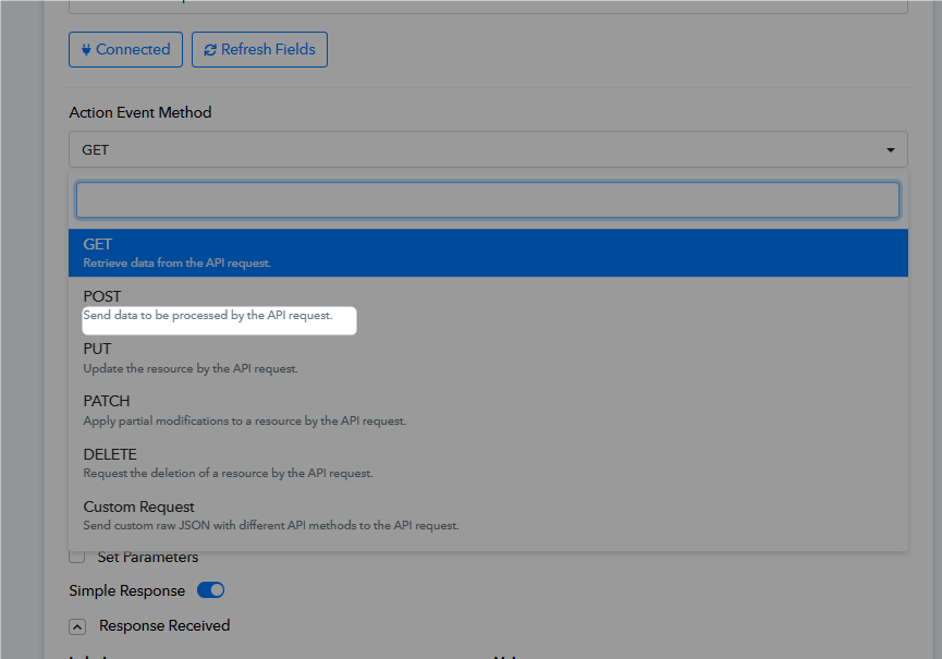

Try with a POST request or you can also try the Data Forwarder action step to pass the data.

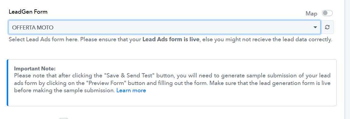

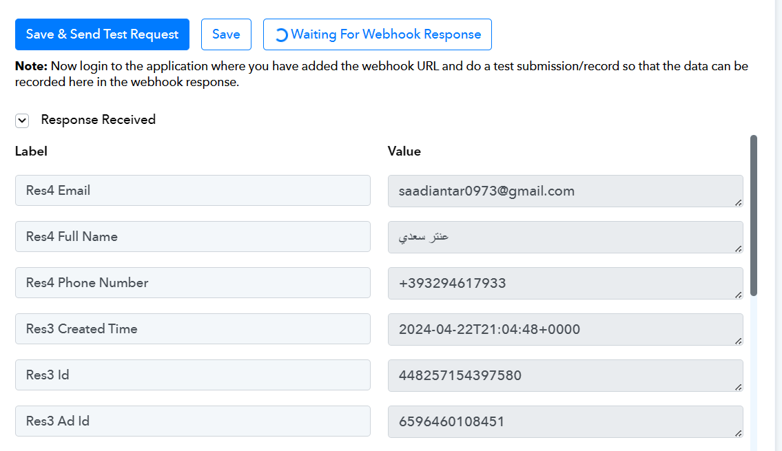

Can you help me to set pabbly before someone send real data?
Because i've tried as desribed on your forum to send by preview on facebook, ma pabbly doesn't receive data.
I've selected a new module from FB page
Then I'm searching to generate a lead data but i can't do it
I can't find a way to submit a test form from facebook and map the response.

Kindly try reconfiguring the Facebook trigger event once and then try recapturing the webhook response again.

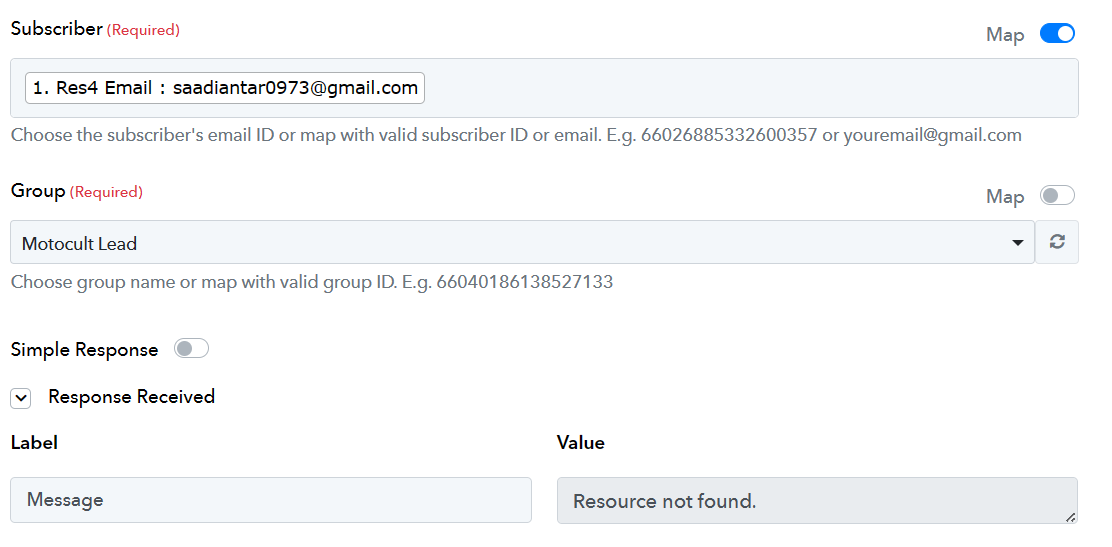

Done, but now I receive an error when submit to mailerlite as RESOURCE NOT FOUND when I submit data to mailerlite
ArshilAhmad
Moderator

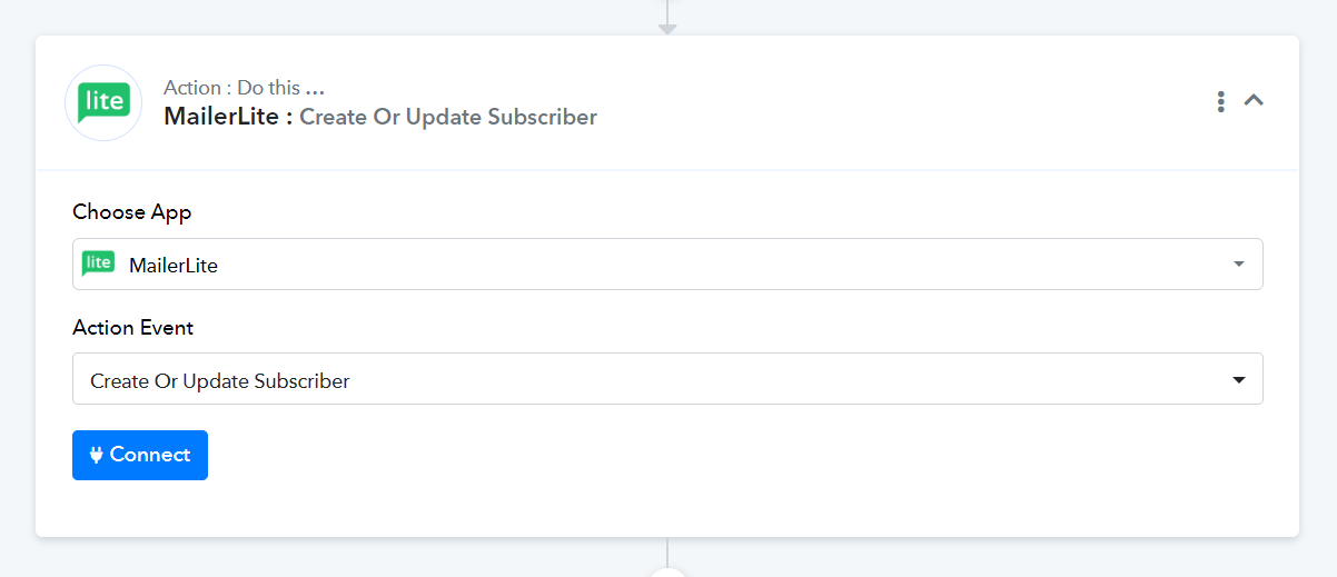

It seems that the subscriber you are trying to assign to a group does not exist in your MailerLite account.
Please use the 'Create Or Update Subscriber' action step to add a new subscriber to your MailerLite account and then proceed with the 'Assign Subscriber to a Group' action step
