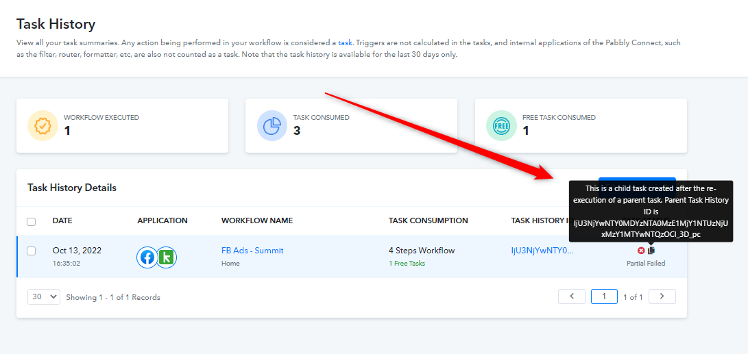

We have a workflow that starts with a facebook webhook. Many of these requests are failing, and I see based on the raw info in the webhook that the key-value pairs of the data returned from facebook are not always consistent, leading to issues with processes further down the line. I believe this is an issue with pabbly parsing the response from FB and somehow not having standardization. Can you please investigate this? Attached are two webhook responses as well as the task IDs they come from

Hey @humanitysteam
Not working (task id: IjU3NjYwNTY0MDYzMDA0MzQ1MjZjNTUzMjUxMzY1MTYwNTQzNSI_3D_pc)
It seems like the task which you have re-executed more than 1 time has actually changed the fields from the trigger response.
As a result, the labels have been changed as you have mapped the data in your workflow, so we would recommend you not re-execute the Facebook trigger events from your history log of Facebook trigger events.
