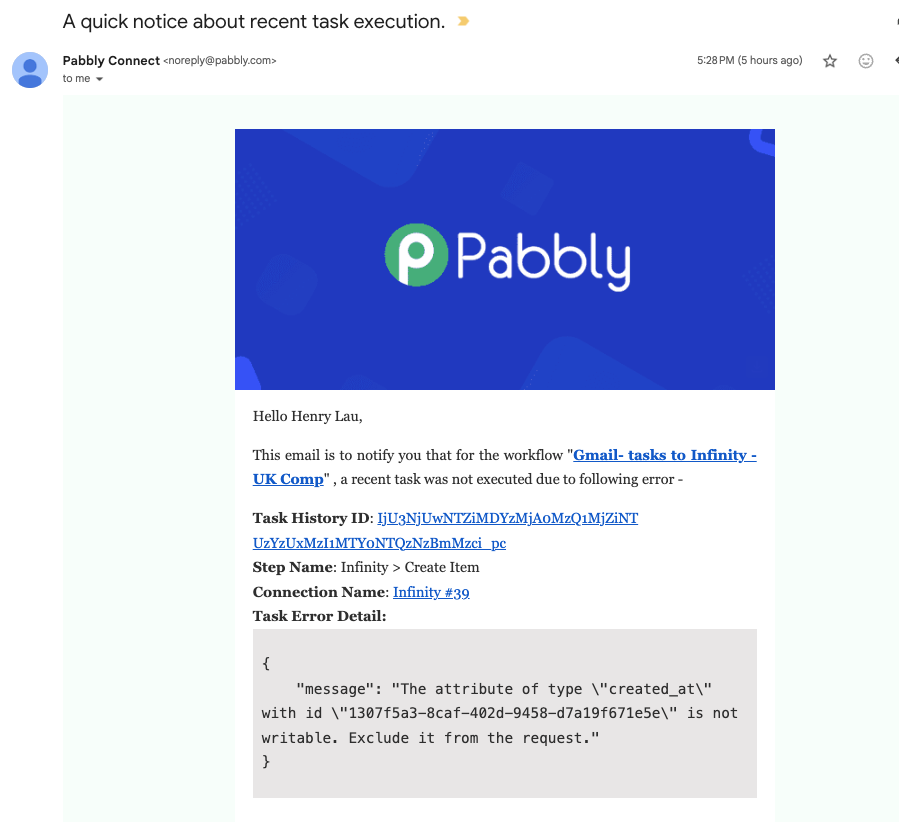

We have log in google task , and infinity separately. It fails. It works very good 8 days ago for over year. Is your server unstable?
Please try to fix it, and inform me the solution. my email is [email hidden]

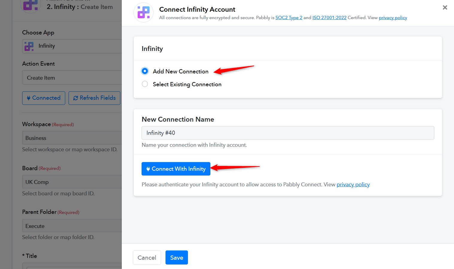

I have added infinity new connection, and connect with new connection 40, and come back to the end with "save and send test request" with the below message indication PDF.

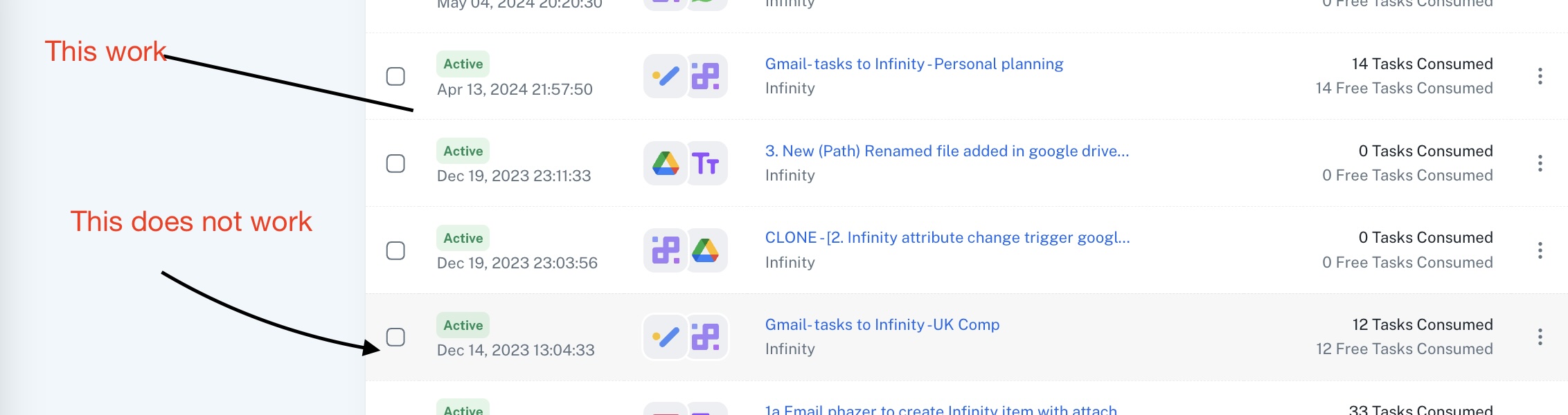

I have checked in the same google task to infinity work flow. One workflow onto infinity folder - executive ( Failure). Another workflow onto infinity folder - Personal (Sucess).
This problem is not from google tasks.
I have added new connection of infinity "new task". It does not work.

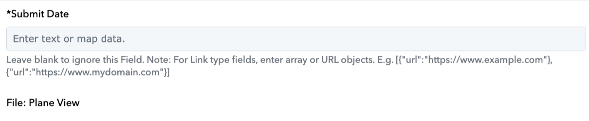

Thank you for your question. Upon testing, our team found that the Submit Day field is a non-editable field, which is causing the issue. We recommend updating your Infinity account to make this field editable. Once the changes are made, please refresh the fields in Pabbly Connect and then try running the action again.

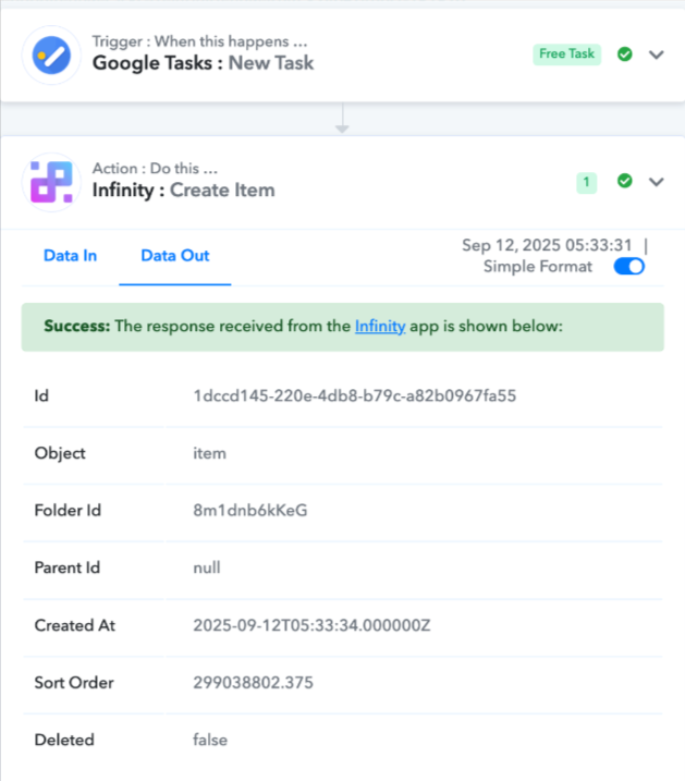

Our team also executed a test without editing this particular field, and the item was created successfully.
