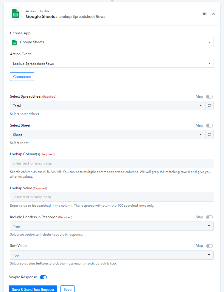

Hey @chris007
You can use the "Google Sheets : Lookup Spreadsheet Rows" action step in your workflow and can check for the existing data in your Google Sheets.
So, in that way you can only feed the data which is new to your previously added data.
You can refer to the following video tutorial on how you can use the Lookup Value action step.
Great, just a question would you add it under the same workflow e.g. https://share.getcloudapp.com/geuypLGd ?
Hey @chris007
We have added the "Google Sheets : Lookup Spreadsheet Rows" action step after the trigger event along with the filter action step to restrict the entire which is already in your Google Sheet.

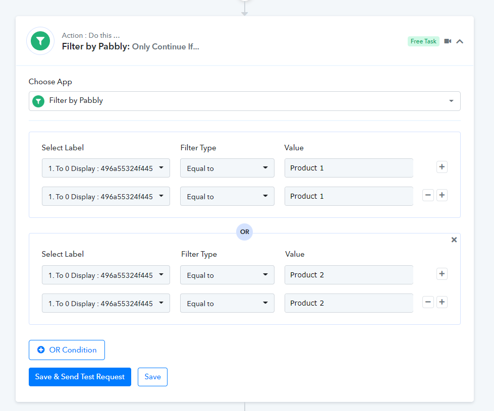

Also maybe this can work instead: https://share.getcloudapp.com/P8u76Qr6
Let us know if that looks right to you?
Also maybe this can work instead: https://share.getcloudapp.com/P8u76Qr6Let us know if that looks right to you?
Instead, you should pass all the products individually in AND condition and then others with OR condition.
E.g. - For your particular case.

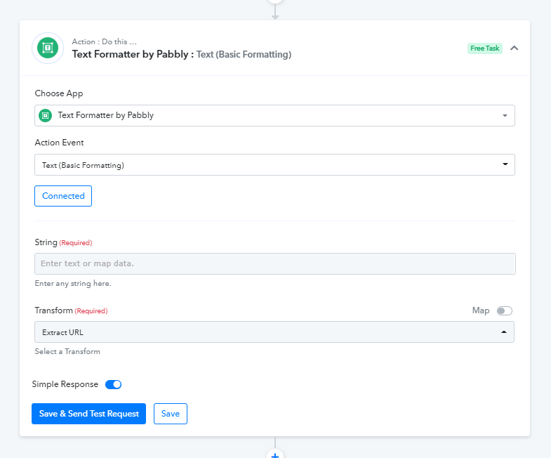

I want to pull URLs from https://www.gadgetgram.com/ (via their RSS feed https://www.gadgetgram.com/feed/) but only URLs from the gadgets category that is all. And exclude anything else. Then pull that into a google sheet. Does your setup above achieve that?
If you are getting the URL in your content then you can use the "Text Formatter by Pabbly : Text (Basic Formatting)" to extract the URLs.
