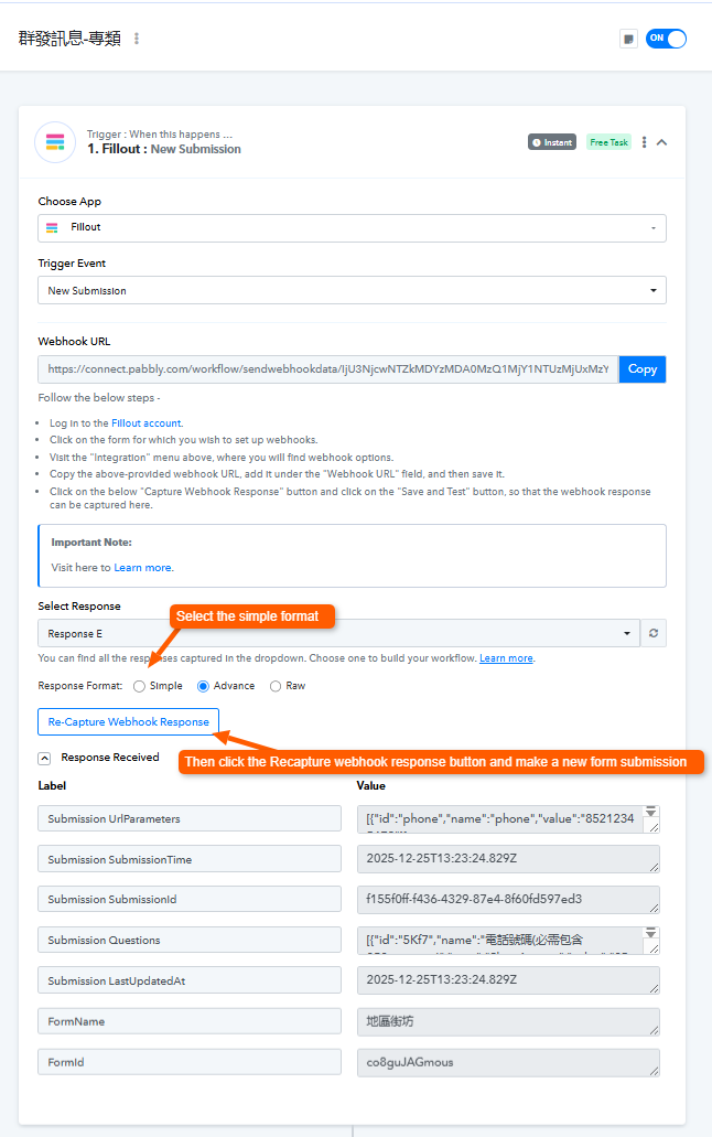

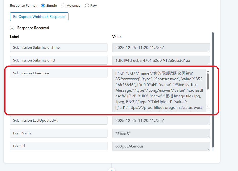

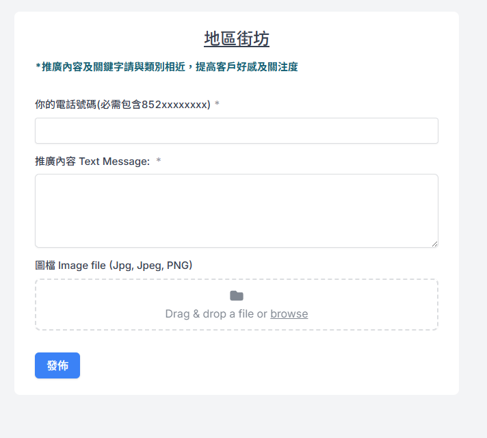

I created a Fillout form with a few of questions and used Webhook linked-up.
Why the captured result is combined all questions to single field in pabbly?
How can it separate to different question fields?
Please advise!

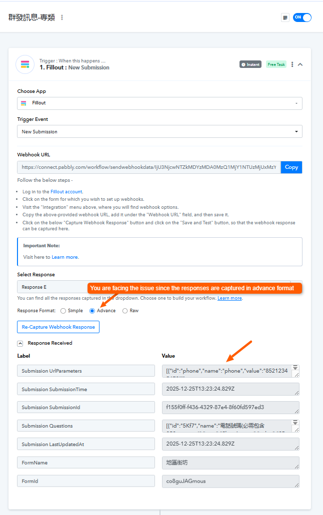

Hi @gpro,

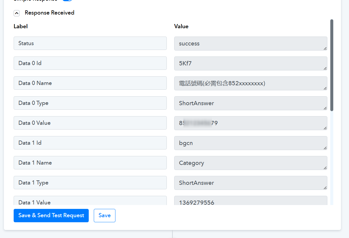

Upon checking it seems that the responses were captured in advanced format which was causing the issue.
To resolve this, please clear your browser cache and select the response type as simple and then click the Re- Capture Webhook Response button and make a new submission to capture the response in Key-value format.
