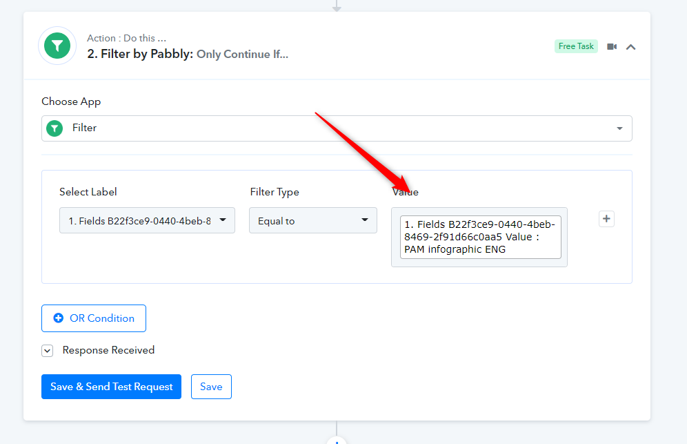

Hey folks!
Please help me fix the problem with Pebbly connect.
The problem:
We created 3 workflows.
https://prnt.sc/jBhUbx9QFaeg
Every workflow has its specific filter by fields in the webhook.
But when we send webhook the filters does not work correctly.
You can check the logs by email [email hidden]
Case is next.
We send webhook with field 1. Fields B22f3ce9-0440-4beb-8469-2f91d66c0aa5 Value : PAM infographic ENG
We expect that only this workflow will be done https://prnt.sc/JkZhzxi8fgKw
But we can see, that other 2 workflows were done too https://prnt.sc/wMbZh7IhOAfq
You can notice that in this 2 workflows have their own filter parameters (not 1. Fields B22f3ce9-0440-4beb-8469-2f91d66c0aa5 Value : PAM infographic ENG).
So this 2 workflows should not be done.
Help us figure out the problem please.
Hey @ilyakovalov
You need to manually type the value in the filter action step. If you map the same thing in the filter it will always work for the same execution every time because the mapped value will also be present in the trigger response.

Thanks!
Now it works :)
