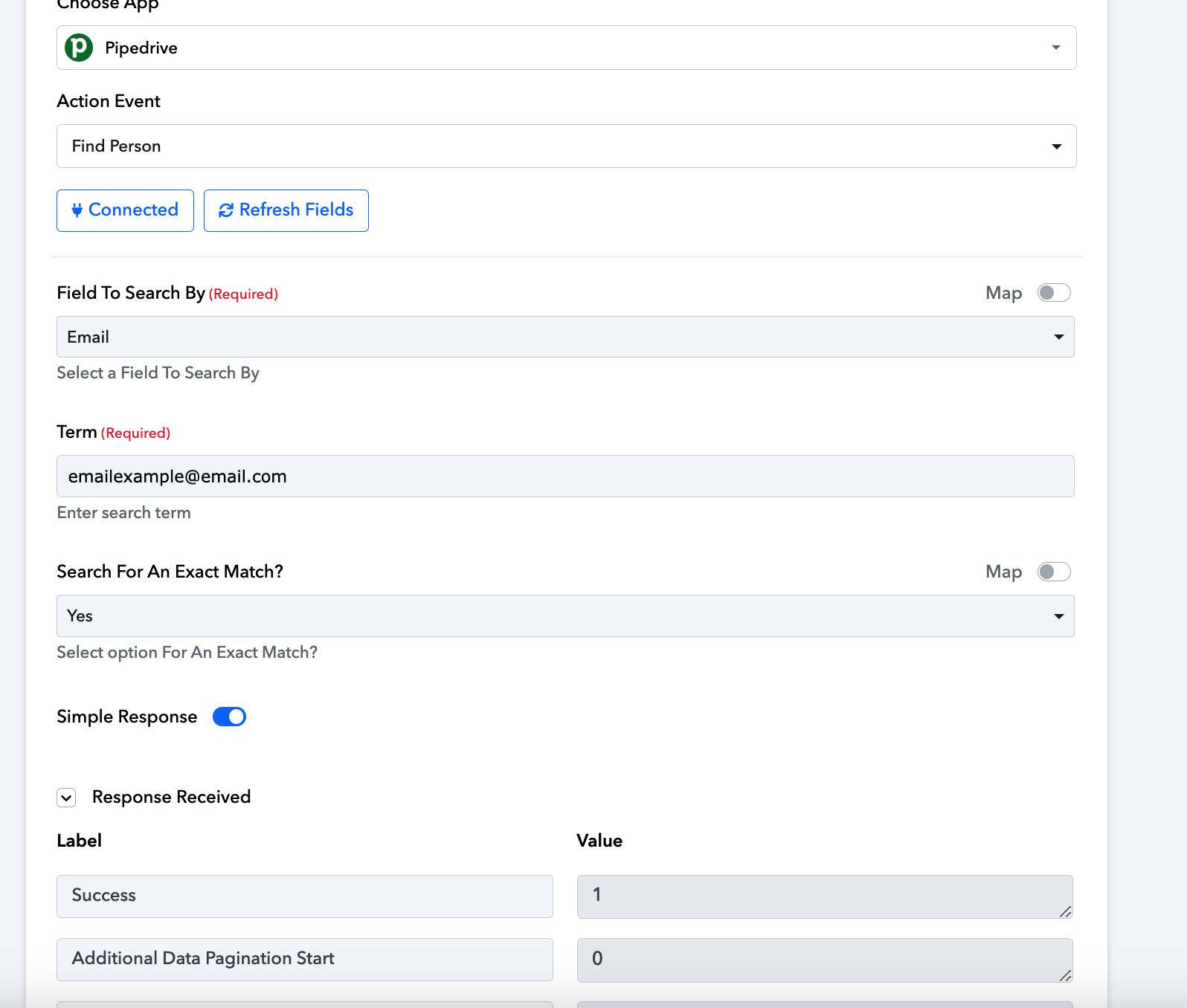

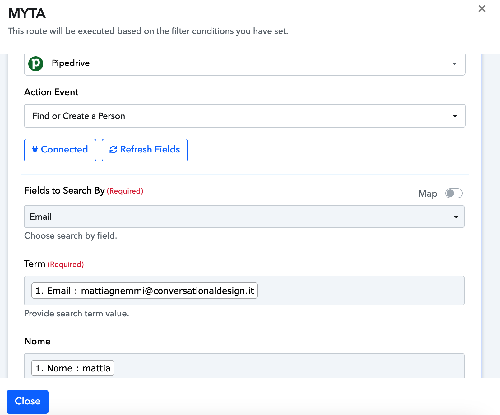

It seems like the Pipedrive "Find Or Create Person" is not working as expected.
Even if an user is present and detected by an unique email, a new person is created every time causing an huge amount of duplicated contacts.
Here a couple of screens

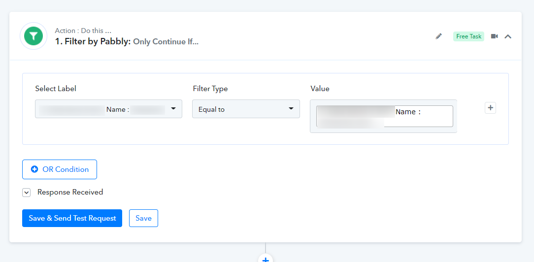

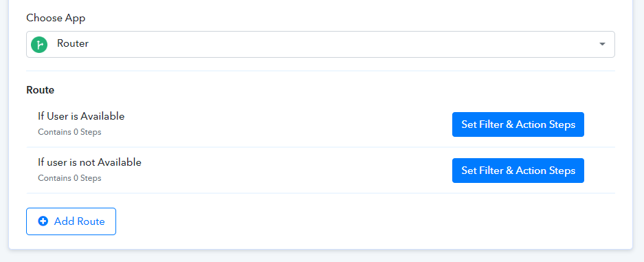

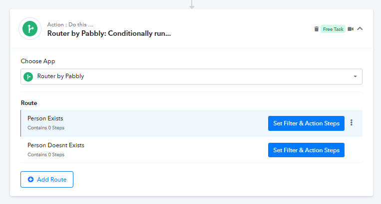

The best you can use in your workflow is a router action step where you can create routes where you can create 2 routes whereas in the first route, you can create a person and add the person accordingly if the person is not available via "PipeDrive: Find Person" action step on another route you can simply assign the corresponding details accordingly.
The Filter condition which you can use -
For a better understanding of the router step you can refer to the following video -

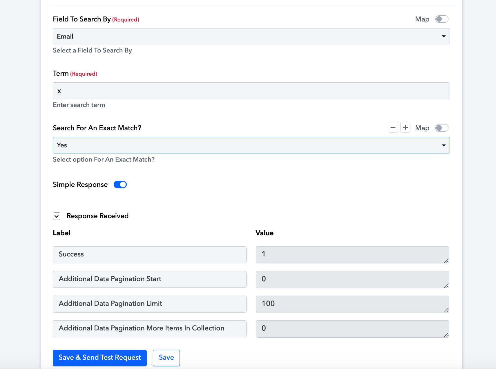

I tried this way but that's not a viable solution.
When using the Router I have to map a field that exist in the find person action in any case (person exists or not exists).
The response of the action shows a very different data set in each case, this way the iterator will not work because there are not common fields in the two responses.
Also Filter is not a possible way for the same reason.
I attach a couple of screens.
As you can see the response data set is very different.
In you example you're using "Name" field. But this field will appears only if Person is present, if not the field could not be mapped by fileter or iterator action and results in an error in the workflow.
The stragest thing is that the very same action is working correctly with Organizations (Action Find or create organization).

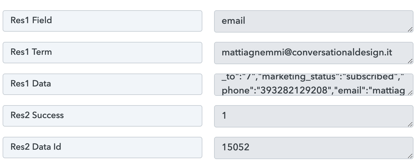

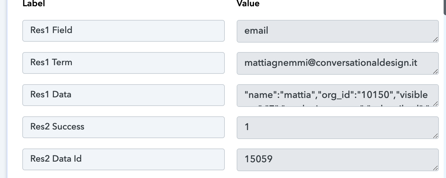

I'm totally sure that there is a bug in Pabbly in the Find or create person action. I tried to fix this in every possible way: with filters, Iterators, Default values in Text Formatter. Every possible thing, BUT the issue is that if an action response show different data sets, any field mapping will fail.
If not clear I will provide you a video.
As we can see from the Pipedrive action steps to Find or Create a Person, if there is a person exists it shows the Id in different Res and if the person is now available the action event passes in different Res which is why the person Id got lost in some execution.
So, we would recommend you use the Router action step if the person exists and if the person doesn't exist you can set the individual route.
