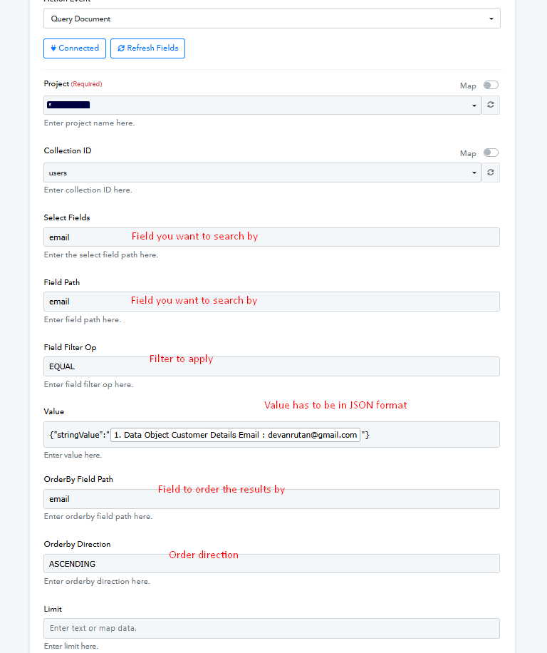

here is how to query a document in Firebase

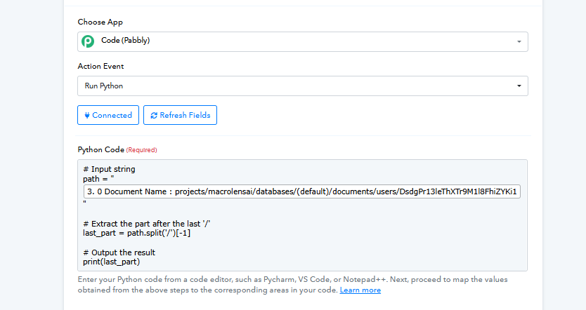

From here if you want to then update a field you have to get the user id out of the document name with python

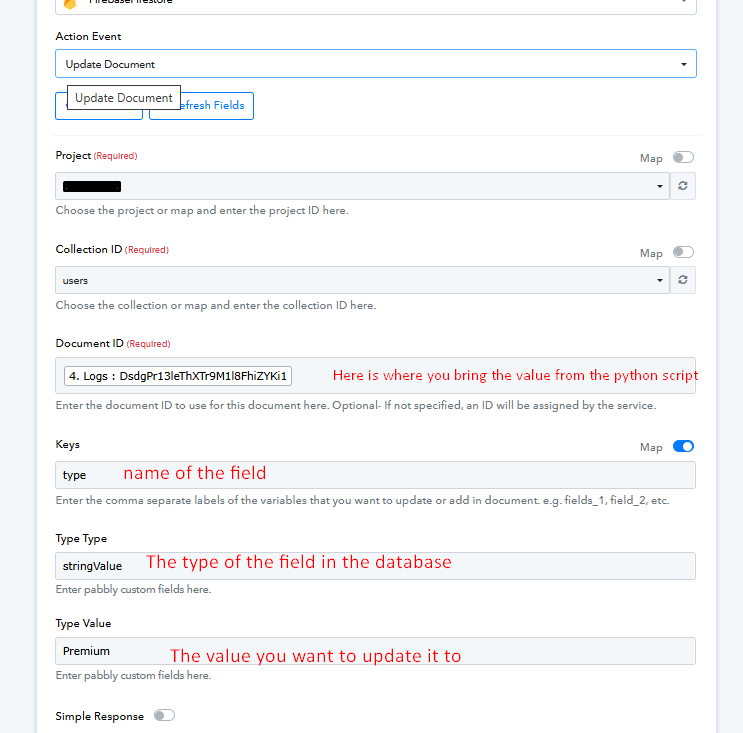

The you use that to find the document you want to update
It seems very simple in hindsight but it took me awhile to figure out. Hope this helps someone.
