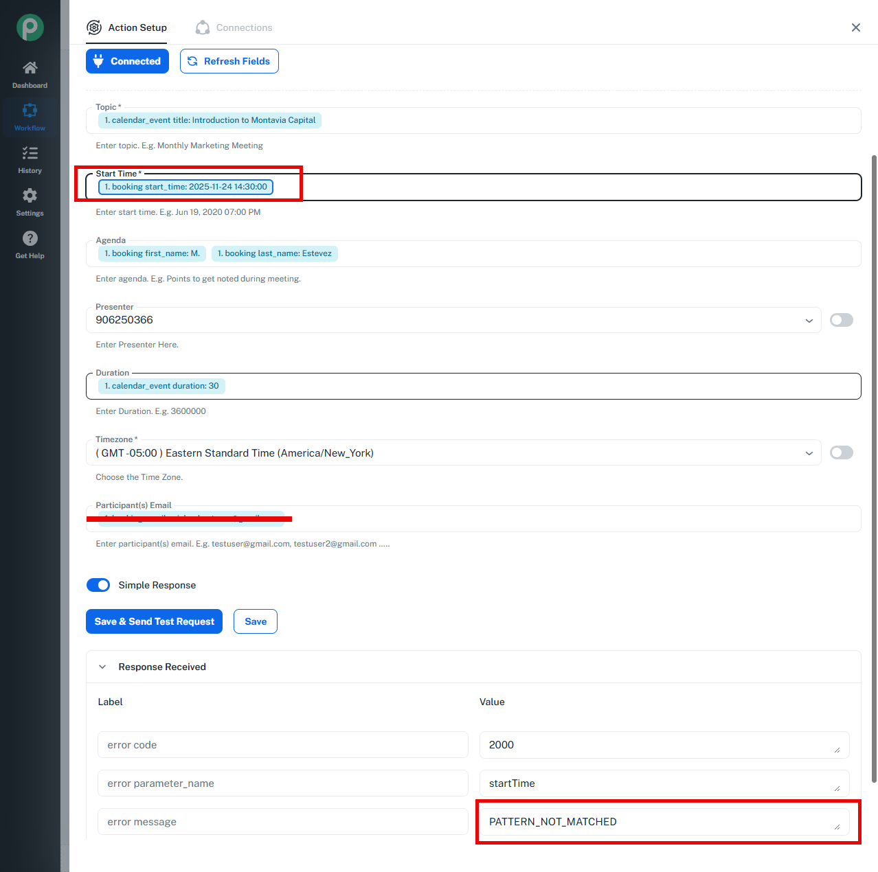

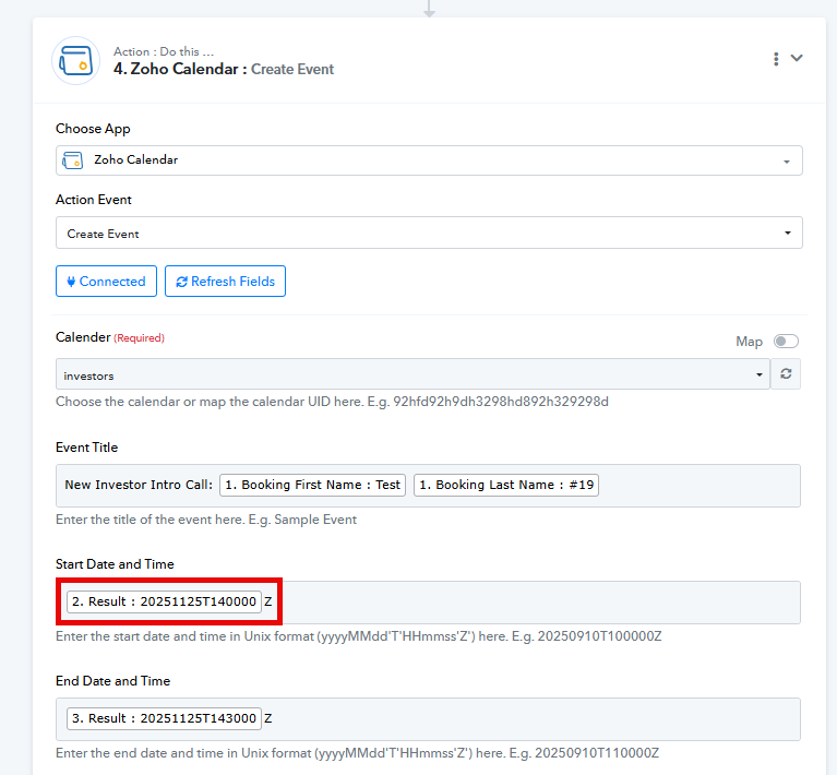

Hello. I am requesting help with this error message. I've included a screenshot of my setup and the error email details below. Thanks in advance for your help!
[TABLE]
[TR]
[TD][JUSTIFY]
This email is to notify you that for the workflow "Fluent Booking >> Zoho Meet" , a recent task was not executed due to following error -[/JUSTIFY]
Task History ID: [redacted]
Step Name: Zoho Meeting > Create a Meeting
Connection Name: My Zoho Meeting Accounts
Task Error Detail:
"error > code": 2000,
"error > parameter_name": "startTime",
"error > message": "PATTERN_NOT_MATCHED"
}[/TD]

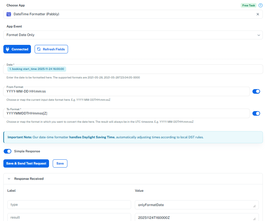

Hi @Estevez96,
In the Start Time field, you were supposed to pass the date in the format stated in the help text. We added a Date/Time Formatter to your workflow to convert the date to the correct format, and it seems to have fixed the issue.

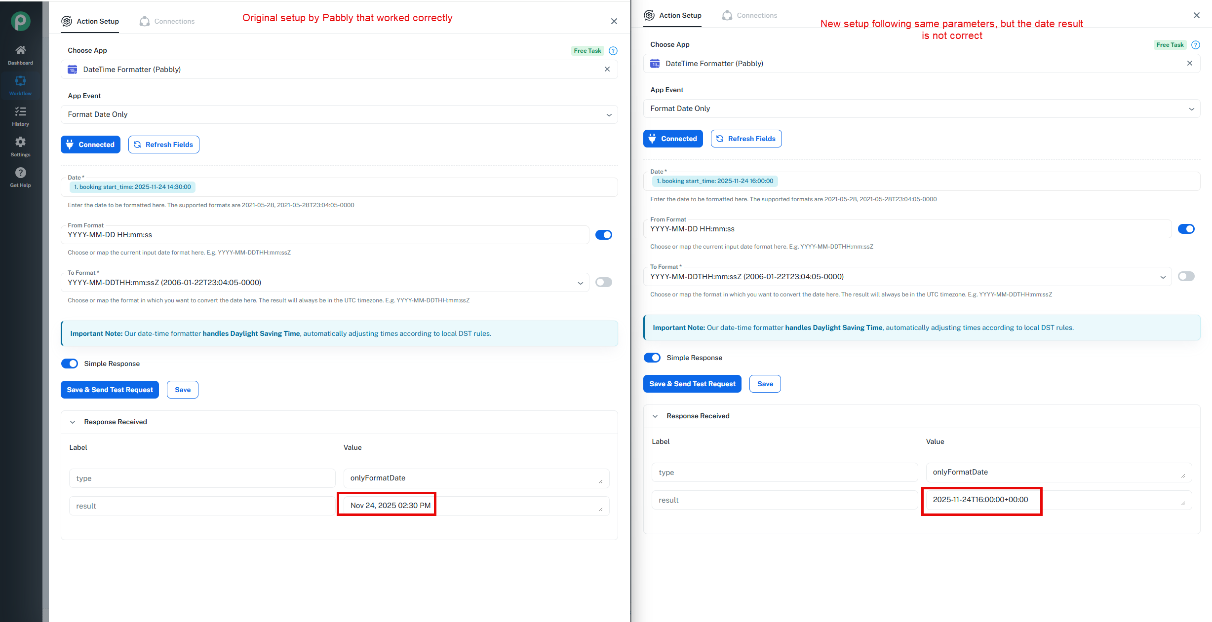

Hello. I created a brand new workflow (URL below), trying to copy the node parameters exactly. The new workflow does not work, and the only discrepancy I can find is that the formatted date output (right-hand panel of image) does not match the original date output result (left-hand panel).
Workflow URL: https://connect.pabbly.com/v2/app/workflow/mapping/IjU3NjYwNTY0MDYzZjA0Mzc1MjZjNTUzZDUxMzUi_pc
Thanks in advance for your continued help and support.

Hi @Estevez96,
Thank you for sharing the details.
We have escalated this issue to our technical team and will update you as soon as we have more information. The behaviour appears to be specific to the new UI, so as a workaround, you may try creating the same workflow in the Classic Builder.
Additionally, the issue you previously reported with Zoho Meeting: Create a Meeting was resolved by correcting the date format. In the current workflow, you are using Zoho Calendar: Create Event, and that action is the one currently under review.
If you configure the Date/Time Formatter exactly as shown in the attached image, the step should not cause any issues in the meantime.
Thanks for your patience while we get this resolved.

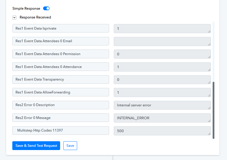

Hello, I am returning to this thread because after running one successful test in the classic builder, I am now getting an 500 Internal Error. The other parts of my booking funnel are all working properly. Additional support would be appreciated here.

Could you please share the Workflow URL you have setup in the Classic UI?

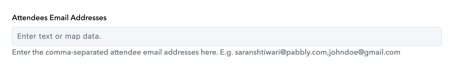

Hello @Estevez96 ,
Thank you for your patience.
Could you please add the “Attendees Email Addresses” field in the action step Zoho Calendar : Create Event and then test the workflow again

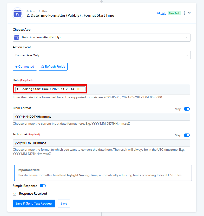

Thank you. The operation seems to be working at the moment, **however** all the calendar events are being created at the same time and date as though the "fix" was hardcoded and does not actually receive the inputs coming in from Fluent Booking and the Time Formatting node (see attached images).
Hello @Estevez96,
Thank you for sharing the images.
Upon checking, we can currently see only one task history after the changes were applied. Based on that, only one calendar event has been created so far. To understand the issue better, could you please clarify which events are getting created with the same date and time
Please note that the date and time fields are mapped dynamically from the previous steps, so every new entry should capture its own values, convert them through the formatter, and then pass them correctly to the Zoho Calendar action.
Kindly monitor the next few executions and let us know if the issue persists or if we are missing anything in understanding your concern.

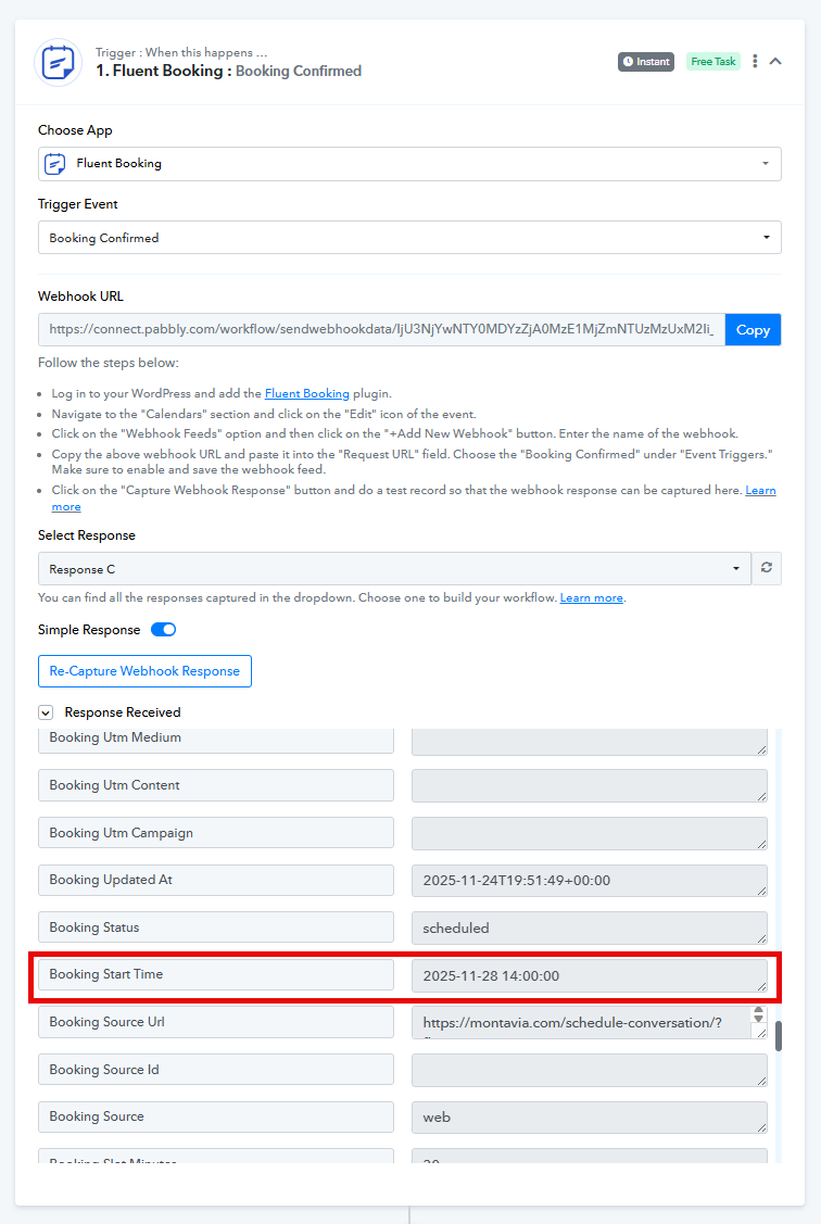

Hello. I recorded a video to try and recreate the error. I'm unclear on what might be the root cause but hopefully you will be able to determine it. One takeaway from the video is that it does not appear that the workflow itself is firing on its own; only when I click "save and test." Can you let me know if there's an expected delay or refresh rate for workflows to run?
Here is the video link: https://www.dropbox.com/scl/fi/wumqawh0oegi2wd4hs4fl/Pabbly-Fluent-Booking-Error-Re-creation.mp4?rlkey=ve3yeuong0xt0d0sq5cg6uvfx&st=2ri2iaqf&dl=0
Clicking the 'Save & Send Test Request' button will always create events for the same time.
To properly test whether the time changes with each submission, you need to make an actual submission. Based on your task history, which captures actual new submissions, we can see that the time does change according to the 'Booking Start Date' received from the Fluent Booking trigger step, and the events are created as per the time captured in that trigger step
