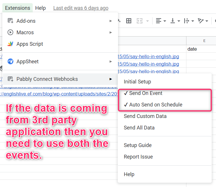

It seems, Webhook not triggering at all.
Iam confused now. I placed the Pabbly Connect extension to Send on Event on Google Sheet.

Hey @digitaldivi
It seems like your data is coming into your Google Sheets from Many Chat(3rd party application), so in that case, you need to check both the options of "Send On Event" and "Auto Send on Schedule" and by enabling both the options then the data can be forwarded in 1hr.
Kindly make sure that you have opted for both options as per your use case.

I did likewise as guided.
Got notifications & also contact added in SIB!!
Great!! :)
