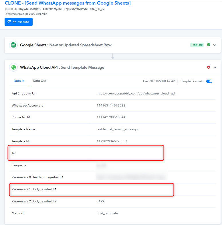

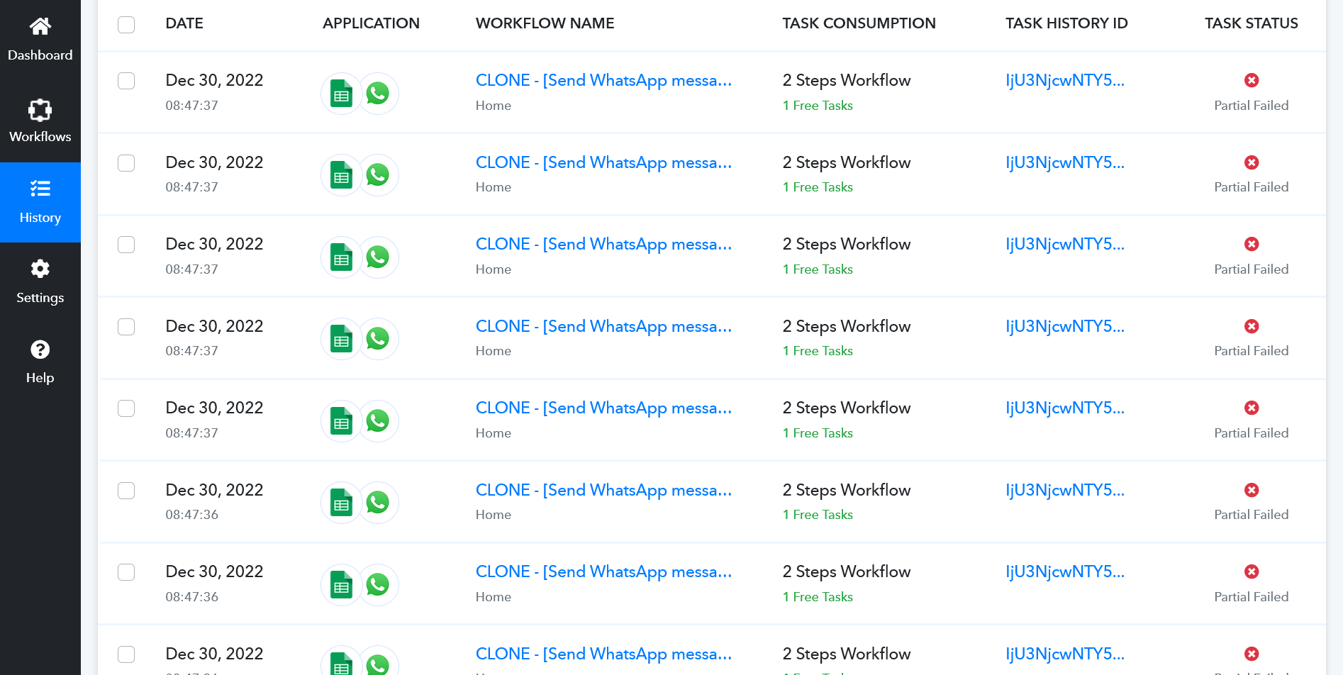

I have been allotted 100 free workflows, Connected Google sheets to WhatsApp CloudAPI and was sending template messages through Google sheets.
Now as there is no tool so check if the WhatsApp number is valid, I just sent the request, now I'm seeing partial default, message error not sent, phone number not present. But, the tasks are being shown as consumed, please upgrade.
After being allotted the 100 free tasks, I've just cloned one workflow and connected the previously built WhatsApp Cloud API to it. How to check if the phone number is genuine and WhatsApp is installed therein, why is every message counted as a task in Pabbly connect. Thanks.

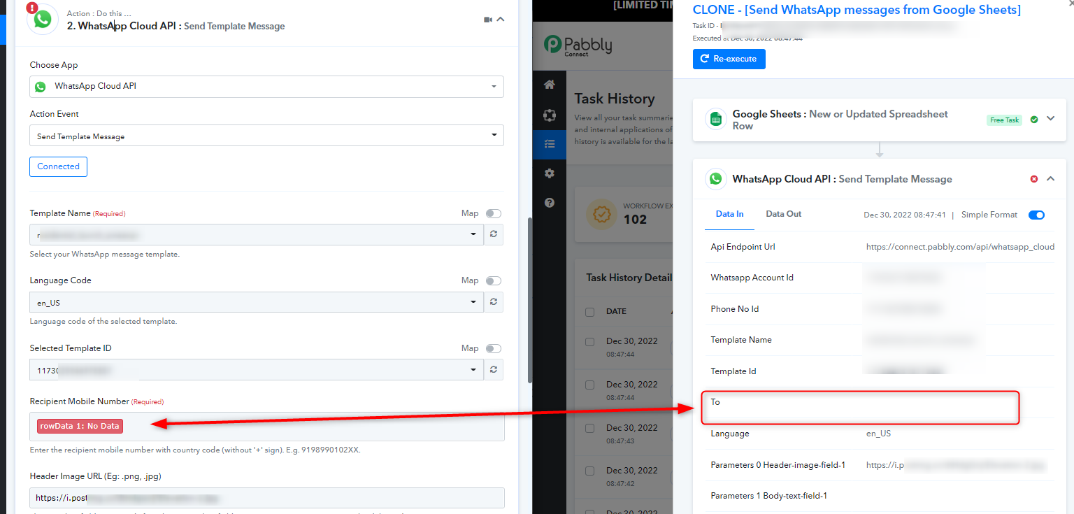

As we can see from your workflow, you haven't mapped the phone number field in the action step accordingly and because of that, your action step didn't work as expected.
Please map the phone number field and other required details then try again.

Again captured the webhook response and again executed the command of send all data.
But, you're still not allowing to send the data, and history is showing old data, and task status is showing partial failed.

Hey @Noob07
Please check the task history Id from your workflow, you will see that all the custom fields you are using are not filled. Some of them are left empty, and the action step didn't process your action step.
So, please ensure that all the fields are mapped with data accordingly.
