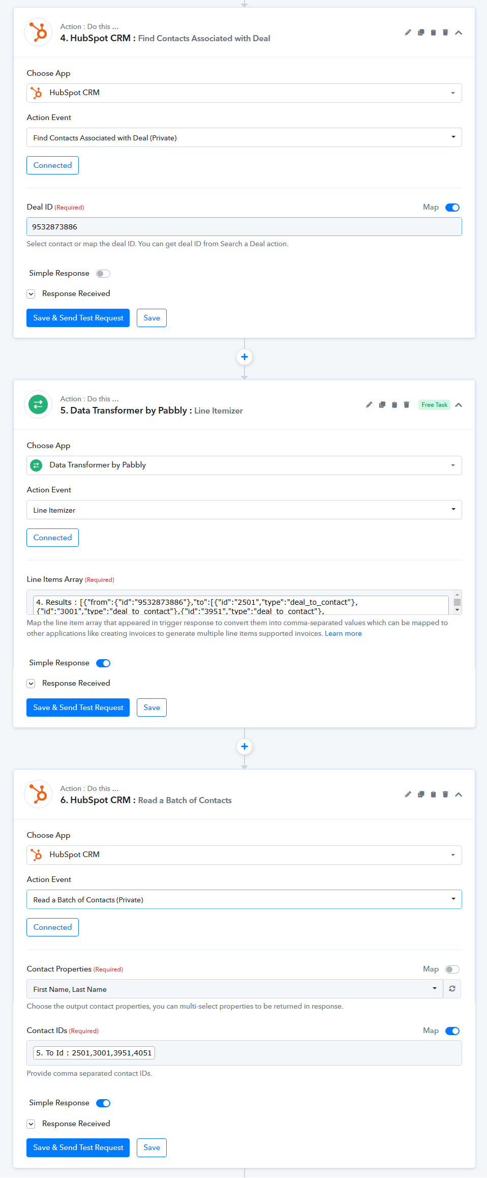

Hello pabblyexperts,
i want to get contact information from Hubspot after a deal is updated in a specific dealstage.
I have the trigger '' deal updated'', then ''get all deal pipelines'', then a filter for the exact deal stage Id which i want to check.
After that i need the name and the mailadress from the contact, which is assoziate with this deal.
How i get the contact information?
Hey @bogdasch
Please utilize "Find Contacts Associated with Deal" to read a batch of contacts.
