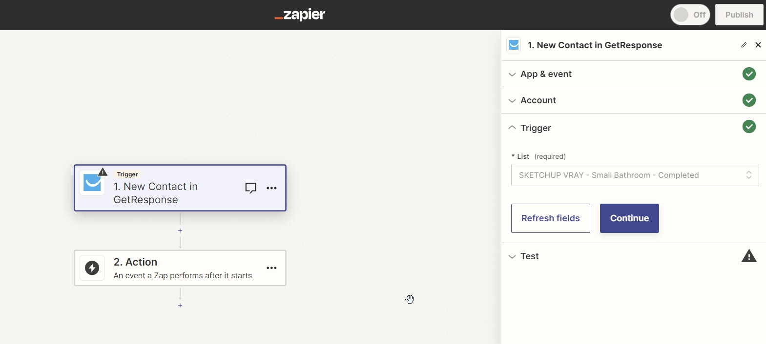

Attached is the screenshot if i use Zapier, I can choose the list in my getresponse to start with

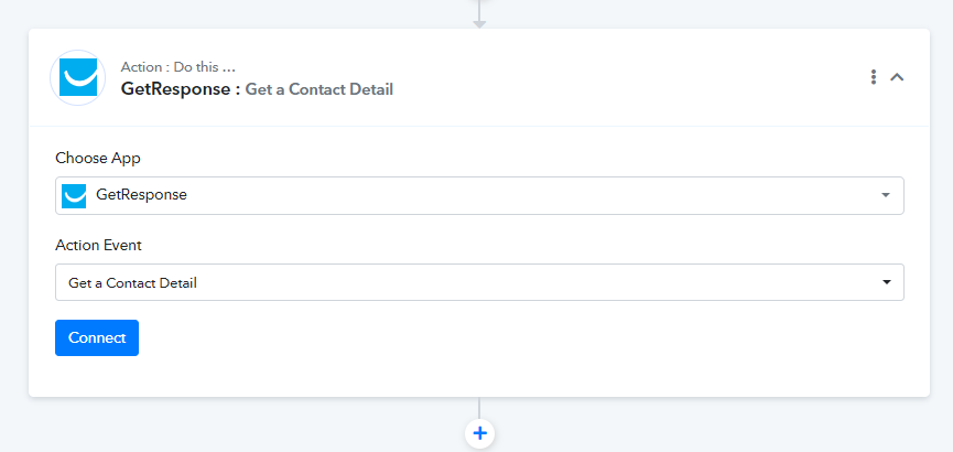

Hey @Reinaldo Handaya
Please check the "GetResponse: Get a Contact Detail" action step right after the trigger event. This step will help extract more information about the contact.
By obtaining the contact details, you'll have access to the contact's list ID or name. This information will allow you to create a Router action step. With this Router, you can easily set up individual routes for your Teachable course based on the contact's specifics. This way, you can personalize the course experience for each contact.

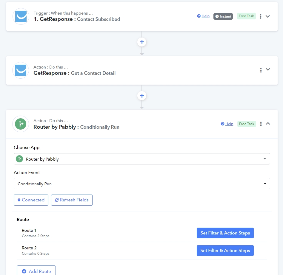

Reinaldo Handaya — Reply ·
ok, i tried 1 course and it work. just to make sure i am on the same page as you, please check my screenshot, is it correct?
So if I have 5 courses, i will need to add 5 routes and if i have 20 courses all i need is to add 20 routes?
Absolutely! You're spot on. To ensure enrollment in the specific courses, it's essential to create separate routes tailored to each course for a seamless enrollment experience.
thank you! i reccon i dont need to add "get contact detail" because on the subscribed already have the list information. and i tested everything is working well.
