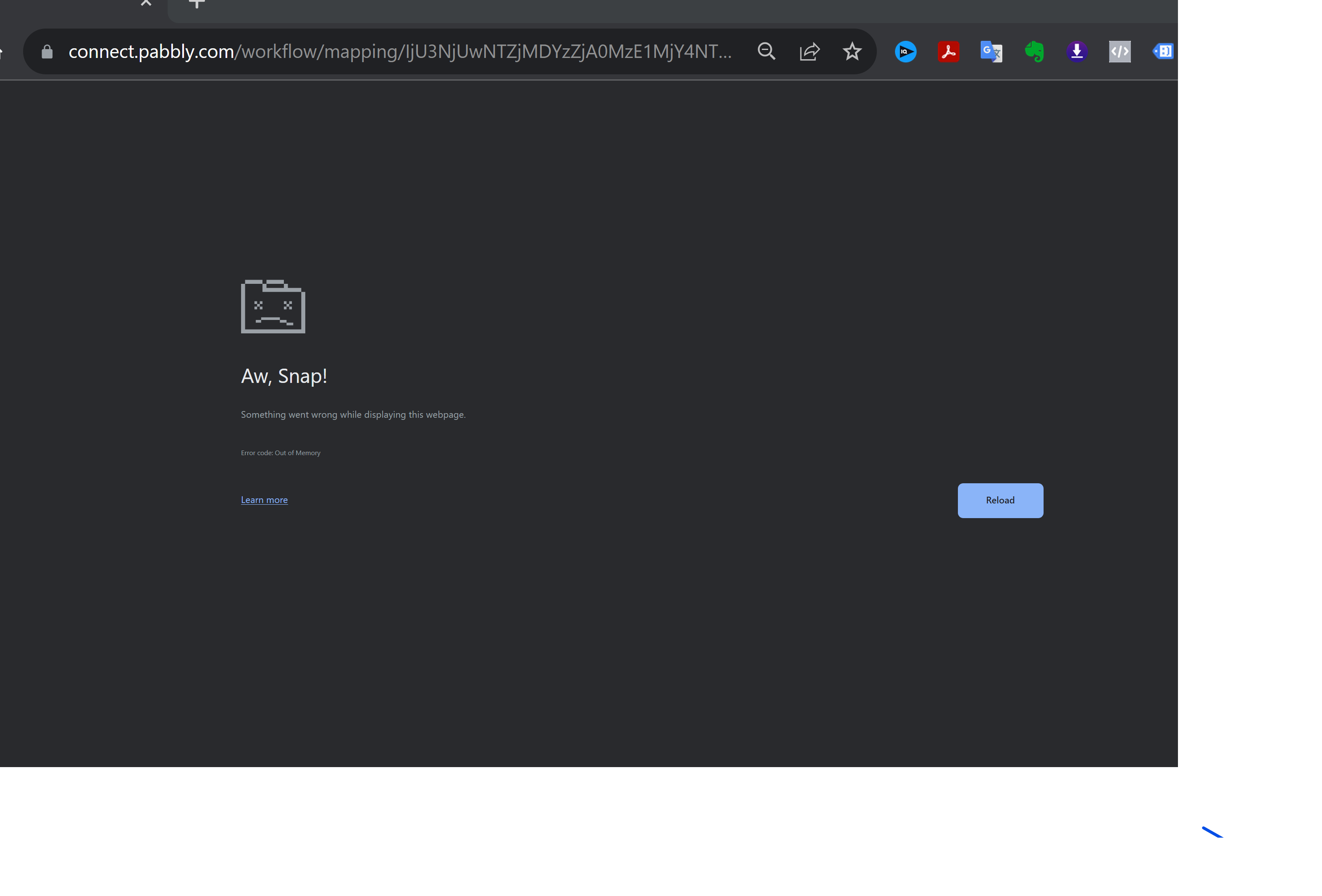

I also made a clone of wf and it wont execute pass this point of getting the google sheet.
Task History ID -
IjU3NjEwNTZiMDYzZTA0MzA1MjZiNTUzZDUxMzY1MTYwNTQzMSI_3D_pc
Still not working
https://drive.google.com/file/d/1uSqjqHt-FxsHbHidVr8ViowFyoX6FGBC/view?usp=sharing
Could you please confirm whether you are still facing this issue or not?
Task History ID -

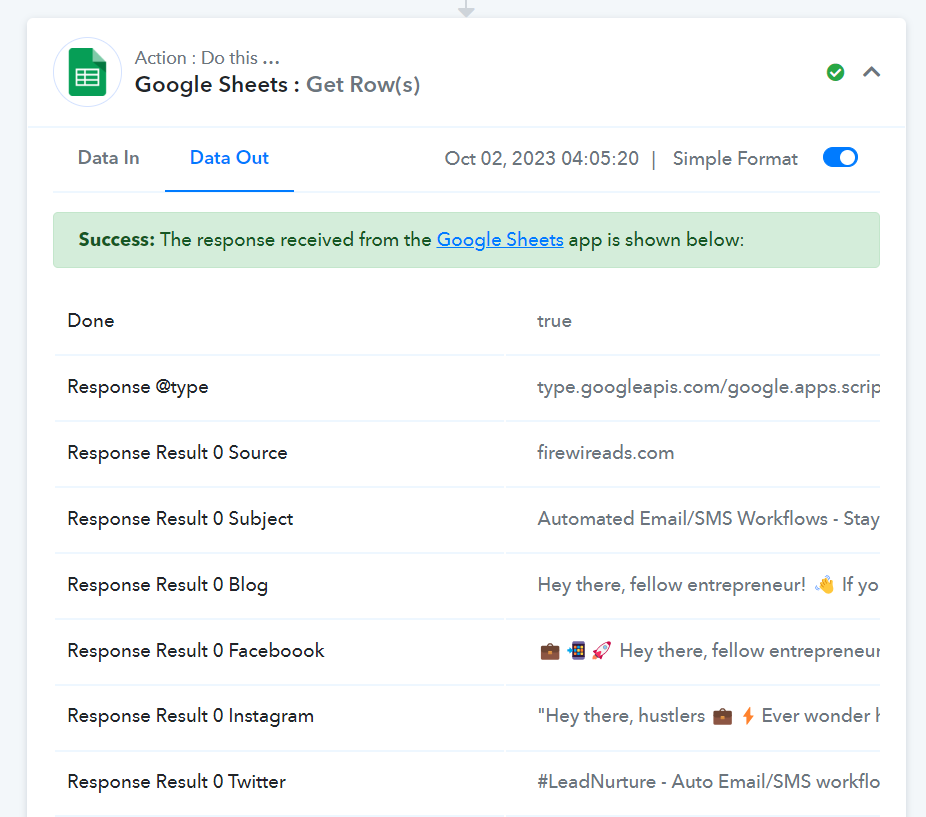

This issue appears to be related to capturing data with Simple Response enabled. Because of this, the Iterator didn't receive any data to process, and as a result, the next steps of your workflow aren't showing up.
