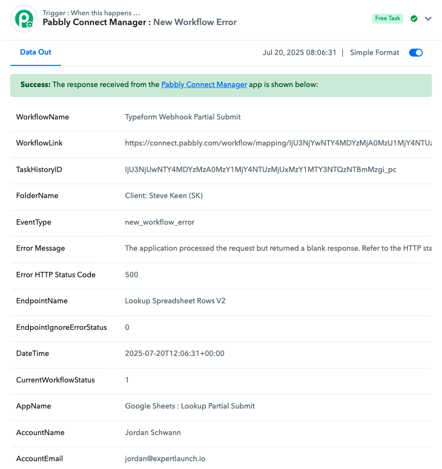

Hi team,
As requested, I’m sharing the details for the second error we are encountering.
Task History ID: IjU3NjYwNTY4MDYzMzA0MzY1MjY4NTUzMjUxMzY1MTY3NTQzNTBmMzgi_pc
Workflow Name: Typeform Webhook Partial Submit
Date/Time of Error: 2025-07-20T12:06:31+00:00
Step where the error occurred:
Google Sheets – Lookup Spreadsheet Rows V2
Error Message:
“The application processed the request but returned a blank response.”
Error HTTP Status Code: 500
The error is captured by Pabbly Connect Manager, but once again, it's not visible in the regular task history under the workflow itself. We'd like to understand why it isn’t logged there, and how we can resolve this issue.
Could you please clarify:
  1. What causes this “blank response” error at the Google Sheets lookup step?
  2. Does it point to a Sheets-side failure, or a problem with how the data is being passed?
  3. How can we prevent this in the future?
I’ve attached a screenshot from Connect Manager showing the full error details.
Looking forward to your support.
Thank you,
Jordan Schwann & Team
For some reason, the Task History ID captured in the Pabbly Connect Manager trigger step is not correct. There is no task created at the time mentioned in Pabbly Connect Manager.
Task History ID - IjU3NjUwNTY4MDYzMzA0MzY1MjY4NTUzMjUxMzY1MTY3NTQzNTBmMzgi_pc

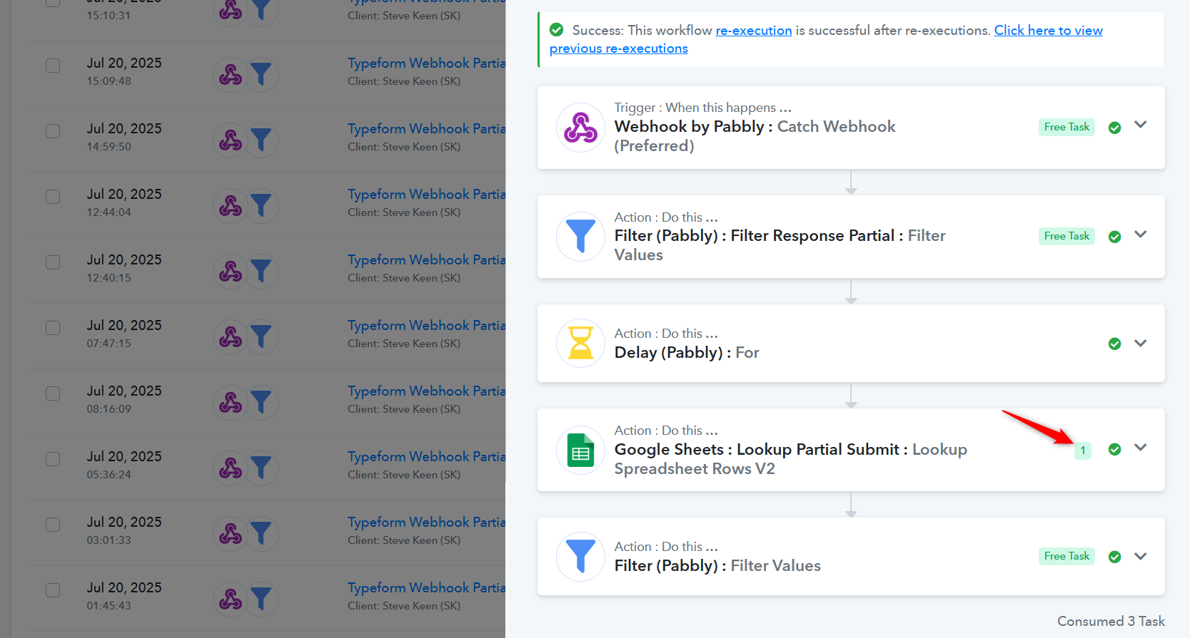

Anyway, we seem to have found a similar task that executed on July 20 at 18:16:09. This task was also re-executed. The 'HTTP Status Code 500' typically appears when there is a downtime or server issue with the respective third-party application. It is possible that during that brief period, Google Sheets experienced downtime, which resulted in the error you encountered.
Aditya Gaikwad — Reply ·
Thanks for help.
But, to fix this issue, is there any work around so that we don't get such errors in future?
And if there was any server error, so did we lose any data over there because of that
The only workaround is to auto re-execute the failed task, which you already have enabled. No, there shouldn’t be any data loss—it was just a temporary issue, and it only affected the 'Lookup Spreadsheet Rows' action step.
