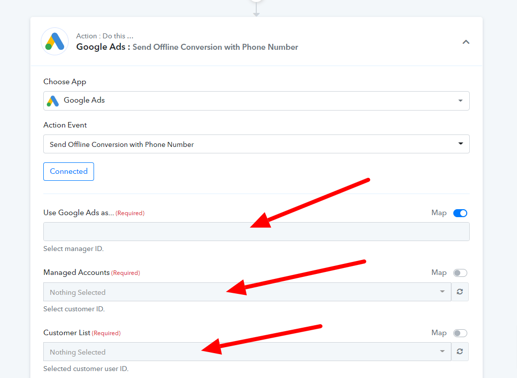

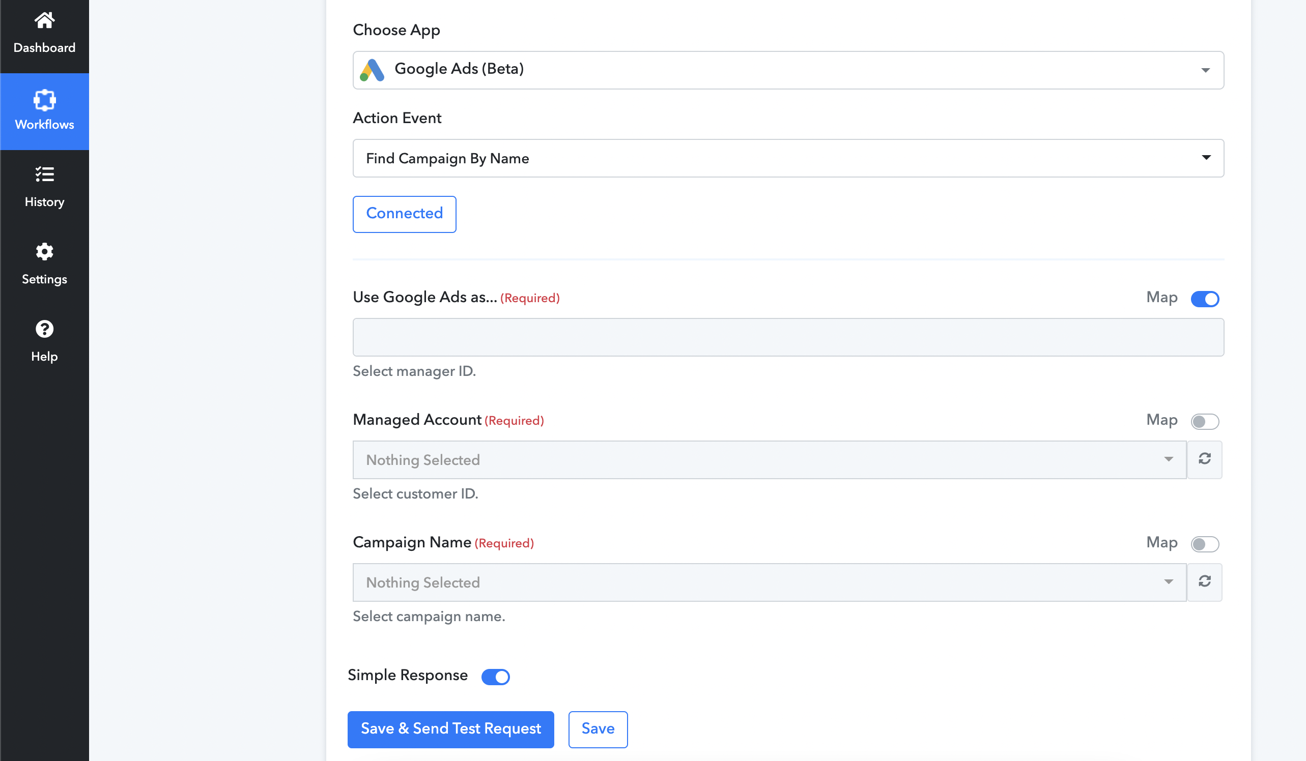

I am trying to get Google Ads Campaign Activation and Deactivation running. However I fail at step 1:
What do you mean bei manager and customer ID? Where do I find these?
"Select manager ID. Select customer ID."
Thank you in advance!

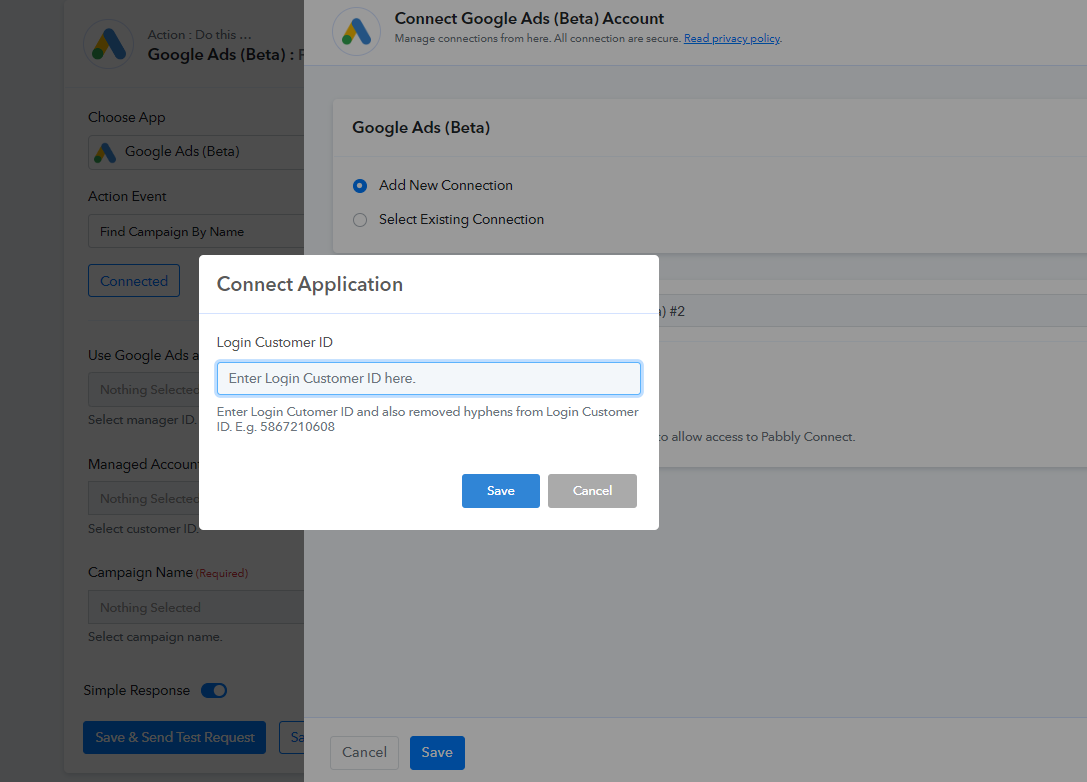

Hey @francisco
Seems like you haven't connected your Google Ads Campaign correctly or in your Google Ads you haven't added any Google Ads.
Please try reconnecting your Google account once by passing the correct customer Id while authenticating.

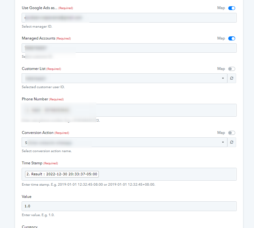

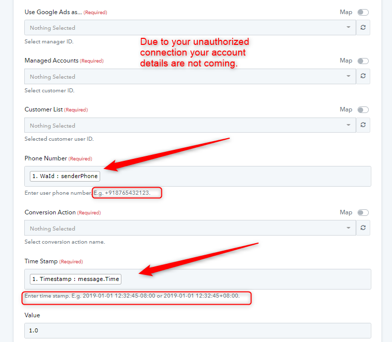

Hi, I have the same problem. I have verify my ID and is correct. But the app is not pulling data from Google Ads.

Hey @IsaacMiz
Kindly share the name of the workflow along with your registered email address with Pabbly, so that we can look into it.
Hey @IsaacMiz
It appears that in the action step you are not passing the data in a valid format, also with that, the connection you have made is not authorized correctly.
Further, please make a new connection and ensure the connection ID which you are passing is from the manager type.
IsaacMiz
Can you check the flow again, it seems there is an issue with time.

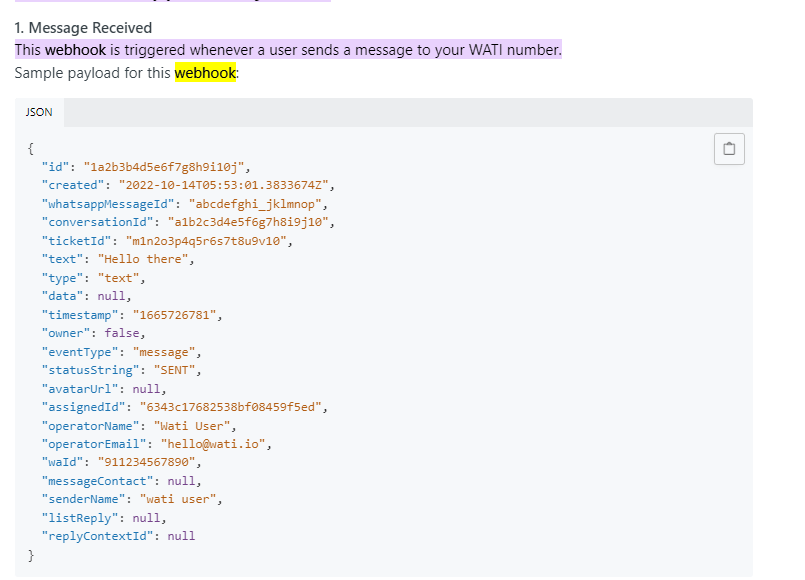

In the other hand, what would be the difference between, Wati Webhook message receive and new contact message receive. I am trying to capture leads and send to FB and Google ads. What would be the best webhook or I need to track both events?

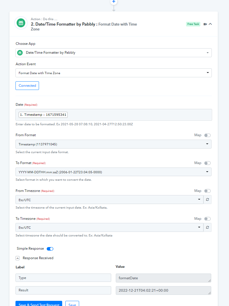

Kindly use the "Date Time Formatter" action step to pass the date time in the desired format from the timestamp.
You may refer to the WATI webhook documentation for the same.

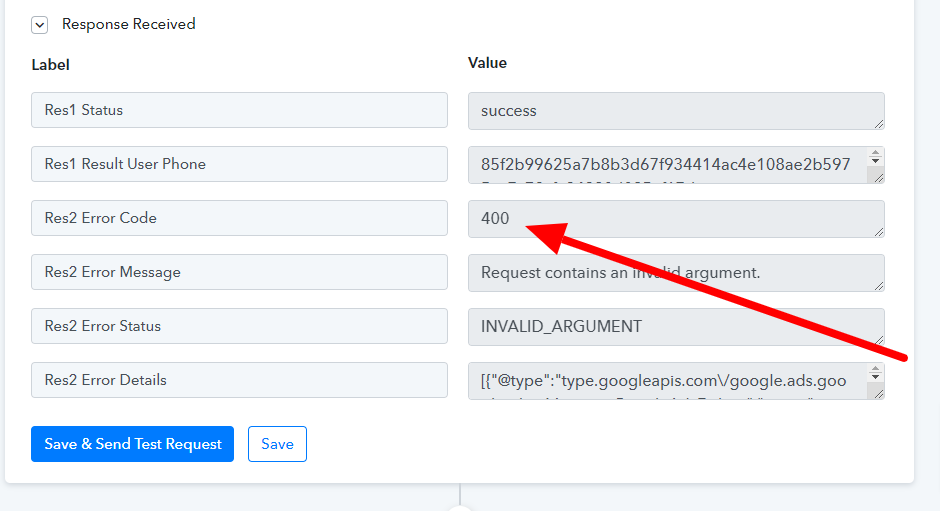

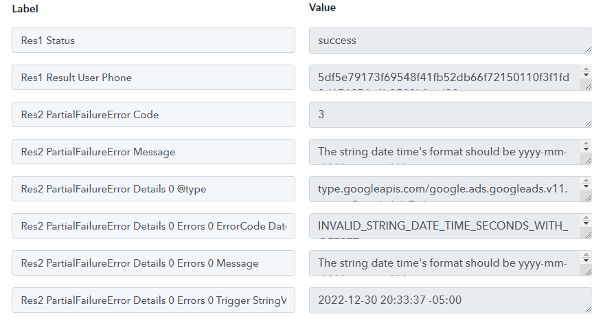

Hi, still have problem with the google ads date integration.
We have corrected the data time format in your workflow and the action step should work fine now.
Further, the error message likely states that the conversion date is after the allowed maximum. This could mean that the conversion data being recorded has a date that is in the future, which is not allowed by Google Ads. To resolve this issue, you should check the conversion tracking setup and make sure that the conversion dates are accurate and within the allowed date range.
So, kindly try in a live execution and try. Also, make sure the number you have passed is in the correct format or not.

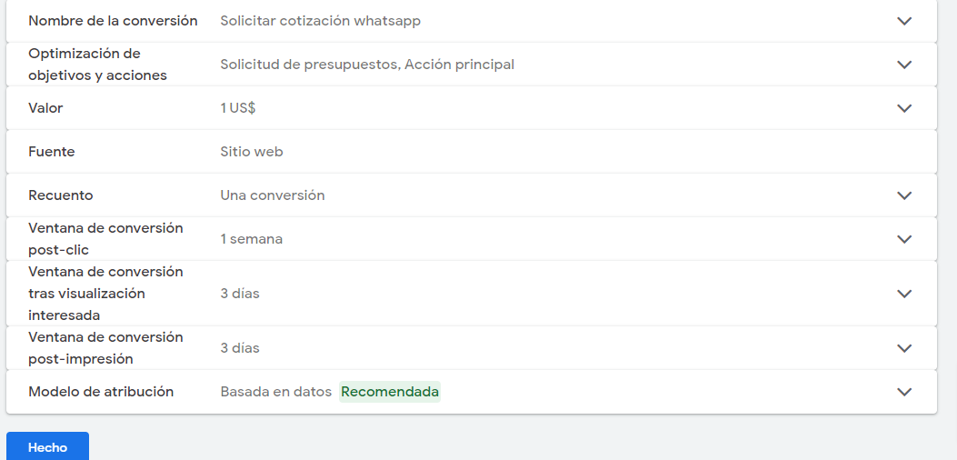

Hi, I am not sure what to do?
