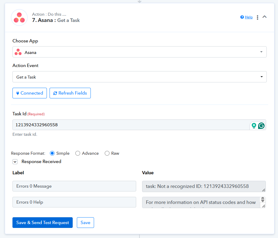

We’ve checked your workflow and found that the issue is due to an invalid or non-existent Task ID being passed to the Asana “Delete Task” action.
The error “Unknown object” indicates that no task exists in Asana with the provided ID. To verify this, we also tested using a Get Task by ID action, and it failed to retrieve any task for the same ID.
What we recommend:
- Please check your Google Sheet (or source step) and confirm that the correct Task IDs are being stored and passed
- Verify in your Asana account whether those tasks:
- Still exist, or
- Have already been deleted
This should help identify why the workflow is attempting to delete a task that cannot be found.
Let us know what you find, and we’ll assist you further if needed.
