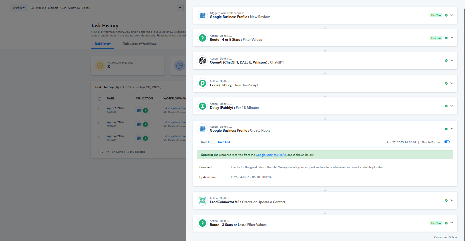

Hi, although my workflows show that all triggers and actions executed successfully, the AI replies to GBP reviews are not posting.
Please see video for context: https://www.loom.com/share/ec28ae2a078a4f46984e30efa7b99020?sid=8f87d7f6-2a3c-4f7e-a2ea-fdc0261c8089
Workflow in question: https://connect.pabbly.com/workflow/share/CEADMQJVA2AETgRuAV4MK1hMCg5SCAE8UUhRQ1xTAnoATlQBBUQKYABMACJQAwRlVB0FbwVZBj5aTlJWBlBUJ1FLBwVRUgZ8Ux4DeARRCjkIVgMrAmM#
Workflow History: https://connect.pabbly.com/task/history?filter_status=applied&filter_by_workflow_id=IjU3NjYwNTY4MDYzNTA0MzQ1MjZhNTUzNTUxMzUi_pc
Task History ID 1: IjU3NjUwNTY5MDYzNjA0MzY1MjY4NTUzNTUxMzI1MTZiNTQzMTBmMzki_pc
Task History ID 2: IjU3NjUwNTY5MDYzNjA0MzY1MjZiNTUzMDUxM2E1MTY1NTQzNTBmMzki_pc
Why are the replies not posting in the Google Business Profile?

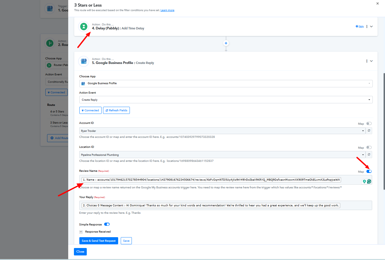

Hello @jpr,
Upon checking, we noticed that a static review was selected in the Create Reply step. We have now mapped the dynamic review ID coming from the trigger, which should resolve the issue. The reviews should now receive replies correctly. Please refer to the attached image for more details.
Additionally, we observed that you are using a delay step within a router. Please note that the combination of routers and delays can sometimes malfunction, as this is a known limitation currently under review by our team.
If the delay is not essential to your workflow, we recommend removing it to ensure smoother execution.
