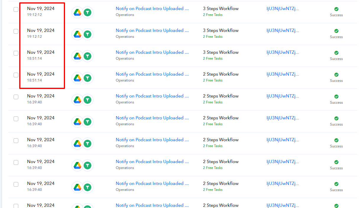

Correct. It was triggered shortly after I made the workflow. It has now been over 90 minutes and, according to Workflow History, has not run a single time since then. As you can see, all 91 instances ran at 16:39:39.

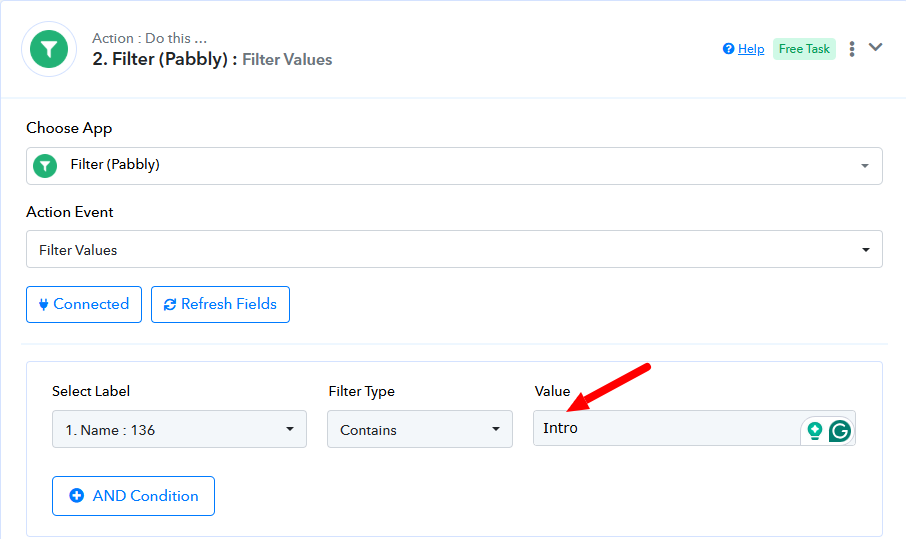

Also, to be clear, I chose "New File In Specific Folder (Shared Drive)". The 91 items are almost entirely folders, not files. The files titled things like "186-Intro.test" should pass the filter criteria which is simply Name of "New File in Specific Folder (Shared Drive)" Contains "-Intro".

Your workflow seems to be triggered after the mentioned time, refer to the attached image.

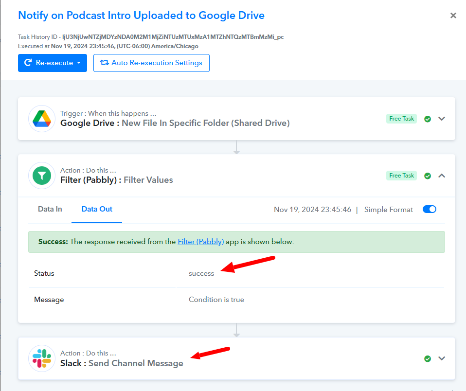

Also, regarding the issue related to the provided task history we have made a change in the filter step(removed the '-' from the value), refer to the attached image. Then we have re-executed the provided task-history and it successfully got re-executed.
Task History ID after re-execution: IjU3NjUwNTZjMDYzNDA0M2M1MjZiNTUzMTUxMzA1MTZhNTQzMTBmMzMi_pc
IjU3NjUwNTZjMDYzNDA0M2M1MjZlNTUzNDUxMzA1MTZhNTQzMDBmMzMi_pc

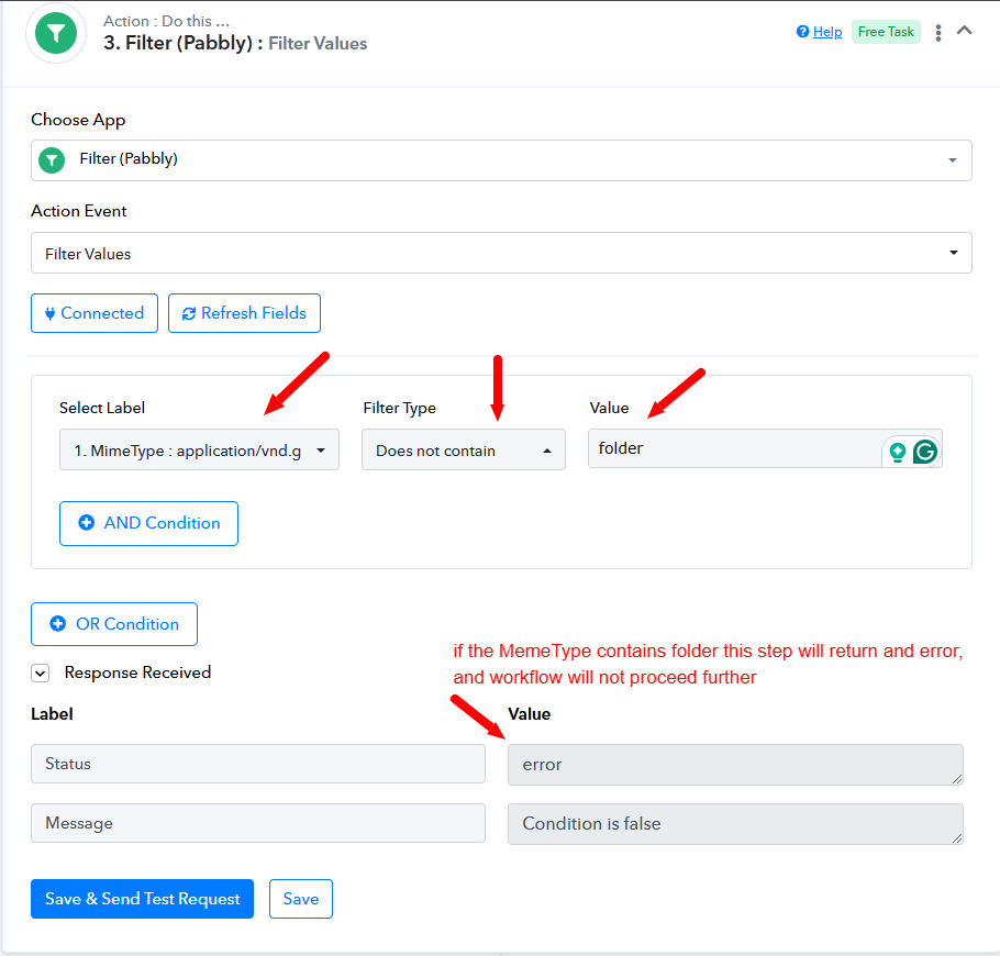

Please note that the trigger will get triggered if any folder or file gets added to the specific folder, to proceed with the further steps only if the captured detail is not a folder you can add a filter as per the below attached screenshot.
