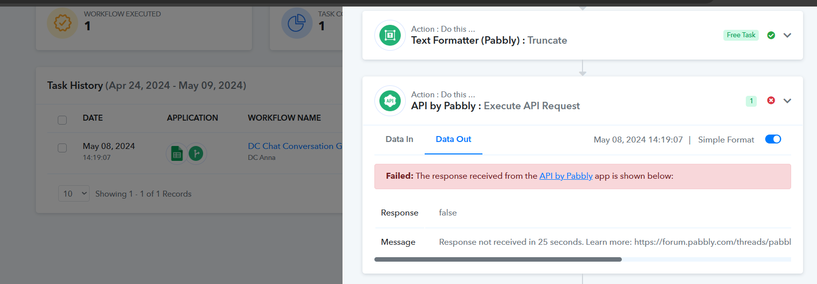

Google Drive & PickyAssist Response not received in 25 seconds
Status: Closed · Asked by IT from De Comate on · 0 views
HelpMeLearn — Question ·
Task History ID: IjU3NmMwNTY5MDYzZTA0MzQ1MjZhNTUzNDUxMzI1MTY0NTQzMCI_3D_pc, IjU3NmMwNTY5MDYzMDA0MzI1MjY1NTUzMTUxMzY1MTYwNTQzNyI_3D_pc
Good day,
I've been getting these errors recently. When I try to re-execute the failed tasks, it doesn't resolve & remains running.
With PickyAssist, the issue always relates to non-local numbers.
Help is greatly appreciated.

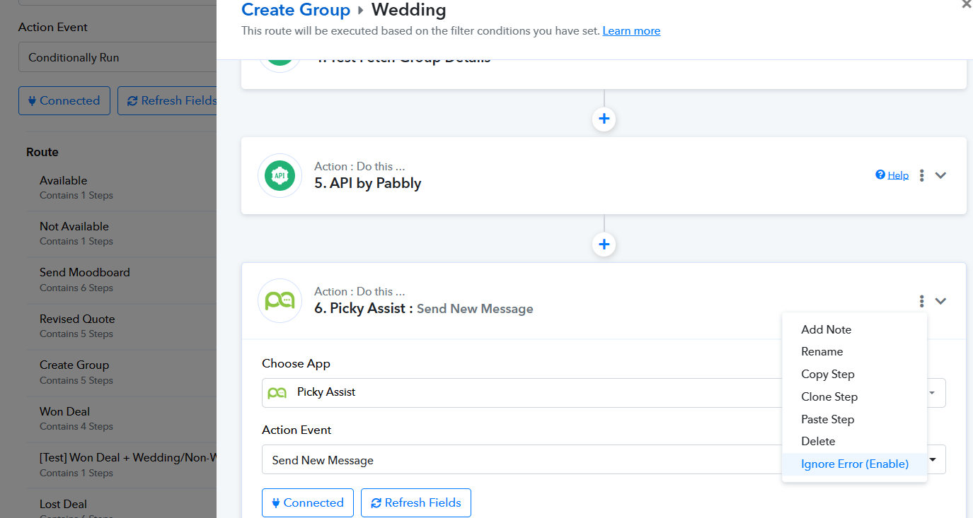

After reviewing your task history ID along with the mapped key values in your workflow, we have noticed that the timeout error in your API request on the "Wedding" route causes the subsequent action step, which relies on its response, to fail or be skipped due to the missing values.
So, either disable the feature from the action step or correct the API request to provide the mapped values correctly so that the further action step can run as expected.

Is there any way I can get insight on what the missing value is from the faulting step? This workflow has been running without errors prior. It had only recently started happening.
The API request sent to PickyAssist is to create a group. While in the other workflow, it's a create folder task in Google Drive. Both are timeout issues.
I've tried it with other sets of data, and the workflow runs fine.

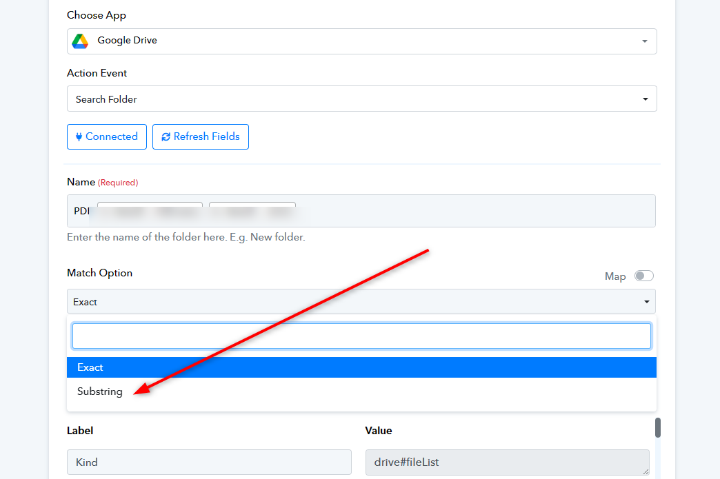

The task history indicates that during the specified time interval, Google Drive did not receive the file with the given name, resulting in a timeout error that prevented further processing.
So, we recommend you to use the Delay action step before the Google Drive action step of 1 min. Or you can change the Match Option to "Substring" in the action step.

Thank you for your suggestion, @Supreme. I've added the suggested delay.
May I know the difference between "exact" & "substring" & why it has such an impact on response time? Will substring cause any issue if it finds a match with other folders?
Exact Match: An exact match search requires scanning the data for a specific sequence of characters, which could be slower, particularly with larger data.
Substring Match: Substring matching tends to be faster as it searches for any occurrence of the search string within the data, offering many more possibilities for a match than an exact phrase.
